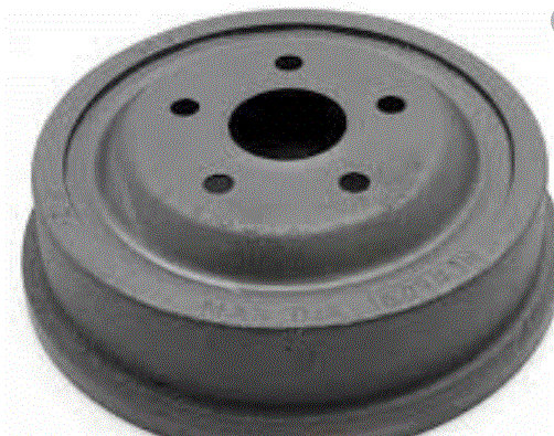

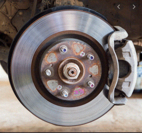

The first thing we need to do is confirm which type of rear brakes you have. I attached two pics below. Pic 1 shows a disc rotor and pic 2 shows a brake drum. Looking through the rear wheel, see if you can identify which you have.
Unless this is a hatchback, I believe it will have drum type brakes, but please verify.

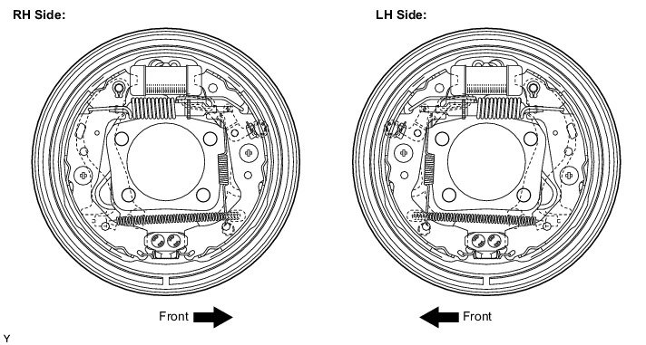

Here are the directions specific to your vehicle for replacement. The pictures below correlate with the directions.
____________________________
2012 Toyota Yaris Sedan L4-1.5L (1NZ-FE)
Rear Brake (Sedan) - Disassembly [08/2011 - ]
Vehicle Brakes and Traction Control Drum Brake System Service and Repair Overhaul Rear Brake (Sedan) - Disassembly [08/2011 - ]
REAR BRAKE (SEDAN) - DISASSEMBLY [08/2011 - ]
BRAKE (REAR): REAR BRAKE (for Sedan): DISASSEMBLY; 2012 MY Yaris [08/2011 - ]
REMOVE REAR BRAKE SHOE KIT
Pic 3
Using SST, separate the shoe return spring from the front brake shoe.
SST : 09703-30010
NOTICE:
Do not damage the wheel cylinder boot.
Using SST, remove the shoe hold down spring cup, shoe hold down spring, pin and front brake shoe.
Pic 4
SST : 09718-00010
Remove the tension spring.
Remove the shoe return spring from the rear brake shoe and remove the parking brake shoe strut set.
Pic 5
Using SST, remove the shoe hold down spring cup, shoe hold down spring, pin and rear brake shoe.
Pic 6
SST : 09718-00010
Using needle-nose pliers, separate the parking brake cable.
pic 7
REMOVE REAR BRAKE AUTOMATIC ADJUST LEVER
pic 8
Remove the automatic adjust lever tension spring and remove the automatic adjust lever.

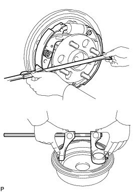

So the brake drum is adjusted using a tool like a gauge.
Feb 23, 2021 at 1:00 PM
SKOOTER24
  • 275 POSTS
The brake setting tool.
Feb 24, 2021 at 3:05 AM
  • 110,240 POSTS
That tool is used to measure the outside diameter of the brake shoes to make sure the drum will both fit over them and so they are not closed too far. You can do it without that tool. What you want to do is have a very slight drag when turning the brake drum. Basically, the brake pads are just ready to touch it.
Let me know if that helps or if you have other questions.
Feb 24, 2021 at 9:53 AM
