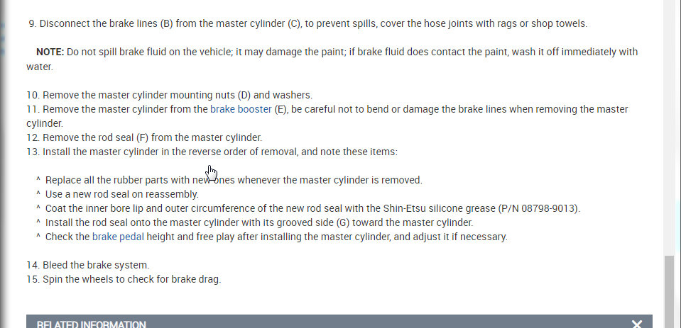

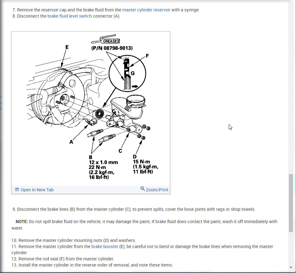

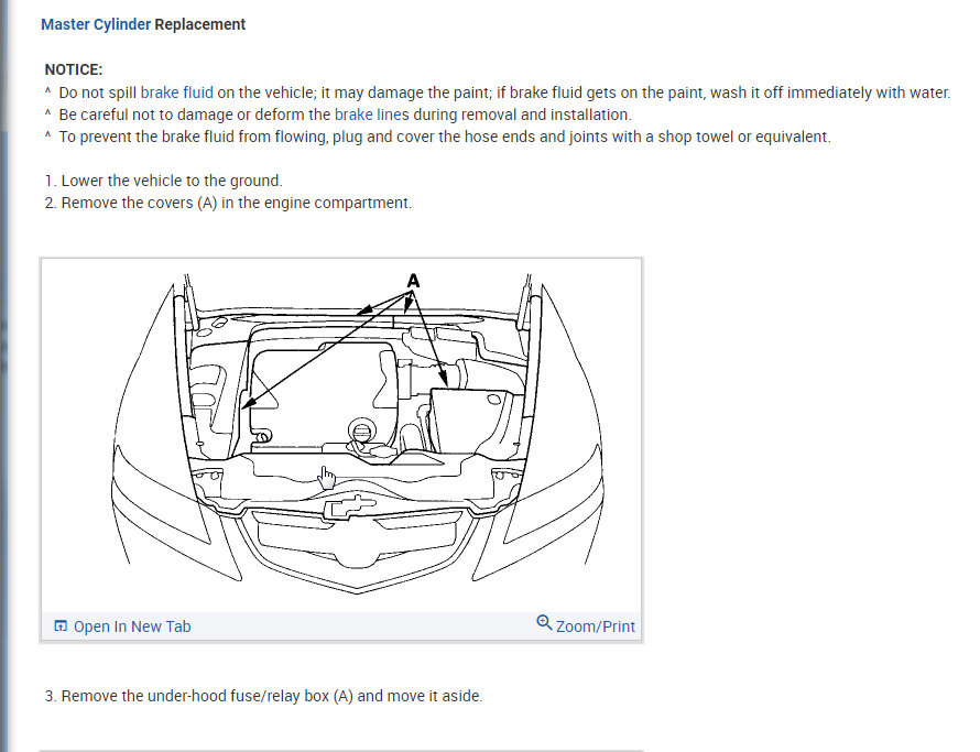

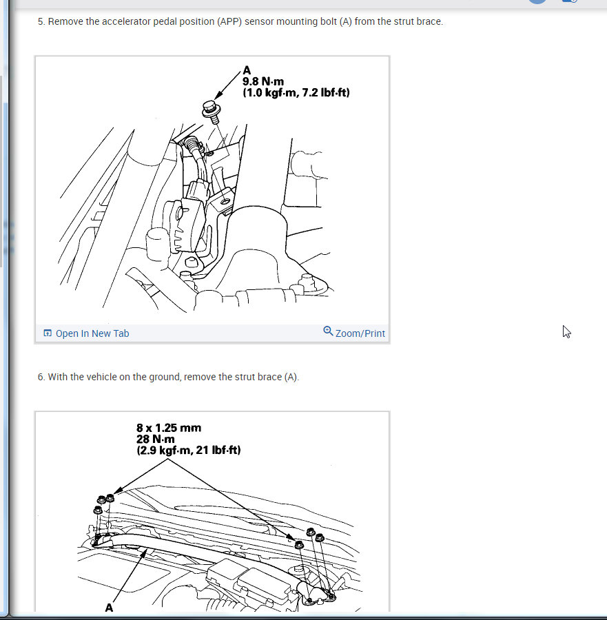

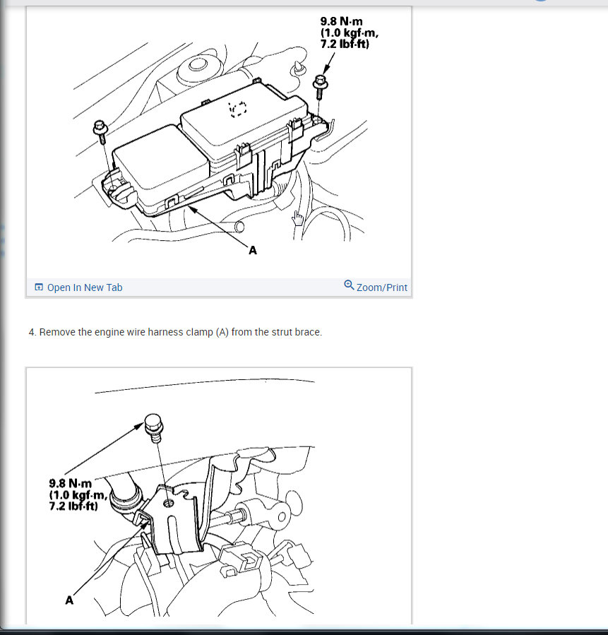

I notices brake fluid leaking from the brake master can you help me change it out please?
Jul 27, 2020 at 9:45 AM
Experienced Mechanic
18,907 POSTS
Here is a guide that will help with replacing this:
https://www.2carpros.com/articles/how-to-replace-a-brake-master-cylinder
Plus below you will find the process from the manual.
Let's run through this material and let me know if you have questions. Thanks
