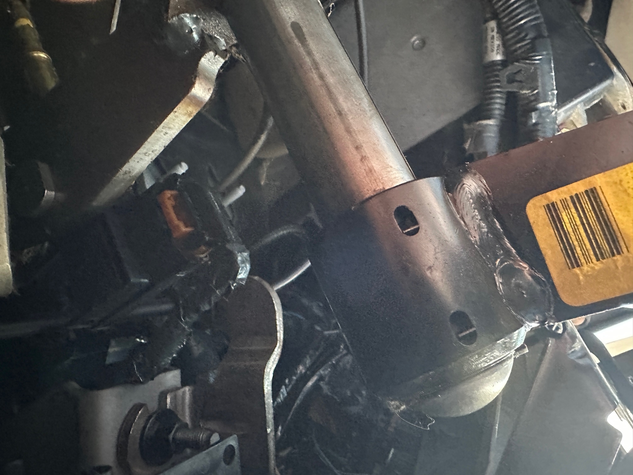

I'm trying to locate the instruction sheet which would have been included with the kit AL2Z-2455-A

The install sheet for AL2Z-2455-A dealers can usually pull the PDF that ships with the service kit when you provide the part number and VIN. (The bulletin itself won’t include the step-by-step; it points to that insert.) Sorry, dealer only on this.

How do you access the broken gear? Is there a special tool?

how to remove this?

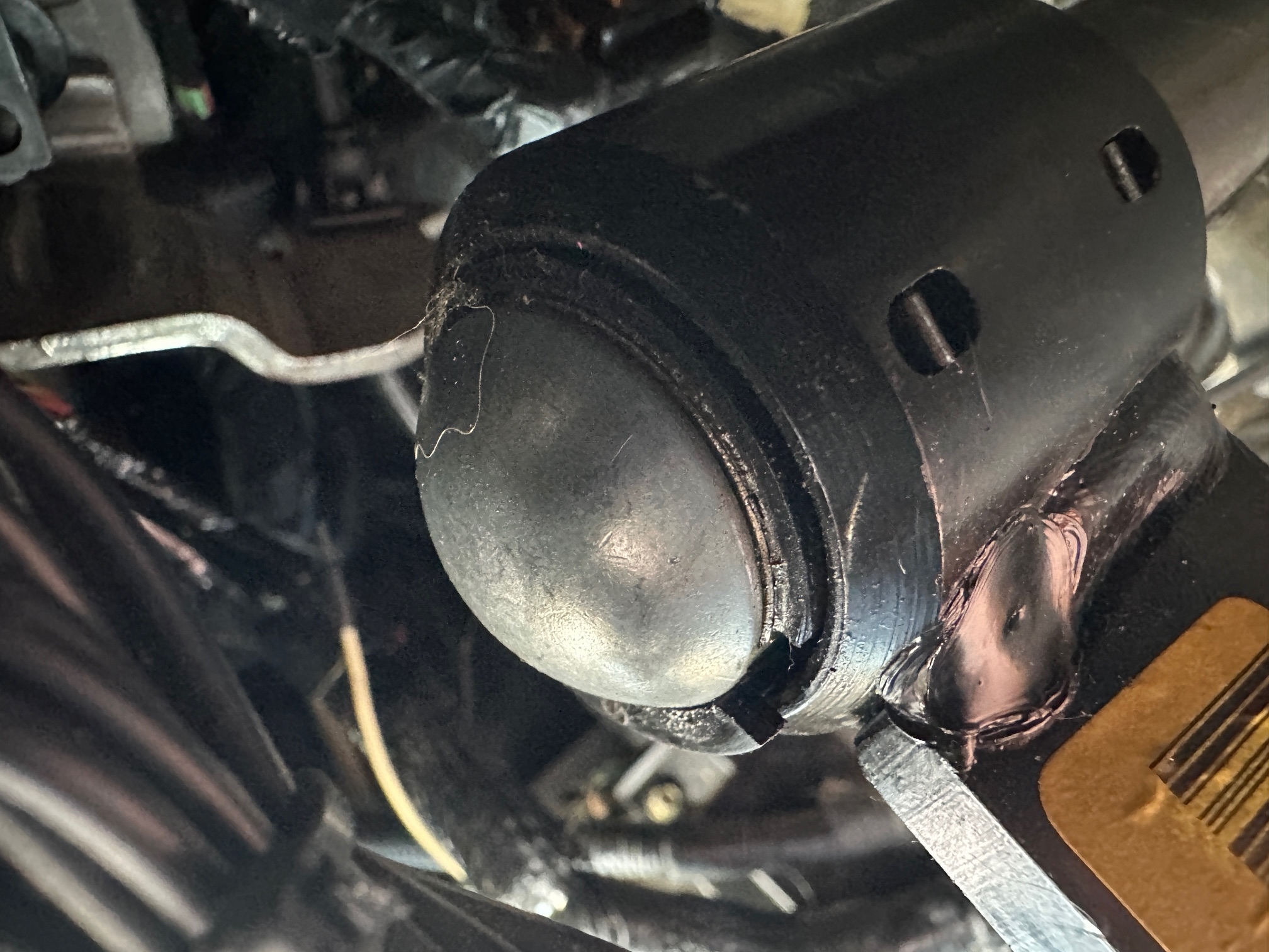

How do you access the gear within the Adjustable brake pedal? gear is broken. Is there a special tool to remove this part shown in below photos?

That looks like it is spring loaded, I would be careful. There is not to much info on this problem. Can you see the motor? I think you need to remove the entire pedal assembly to fix this problem.
