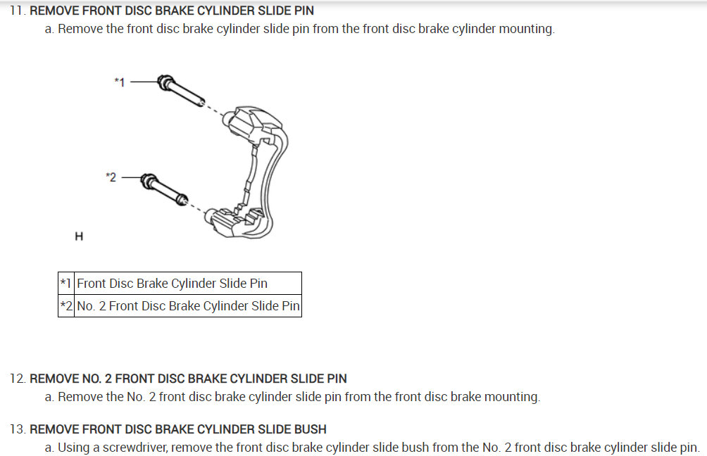

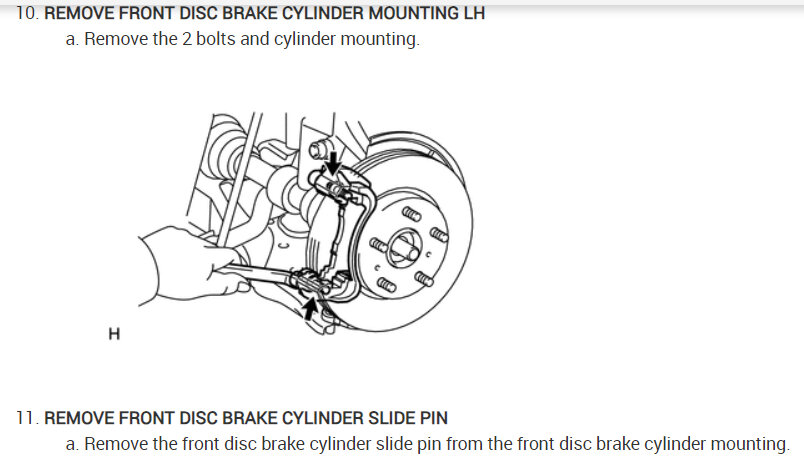

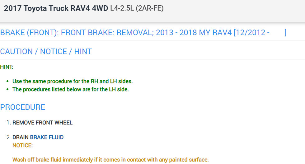

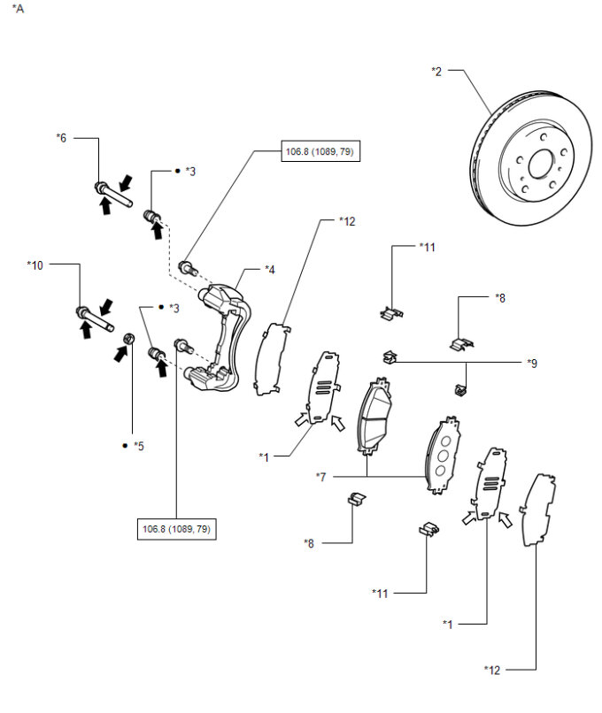

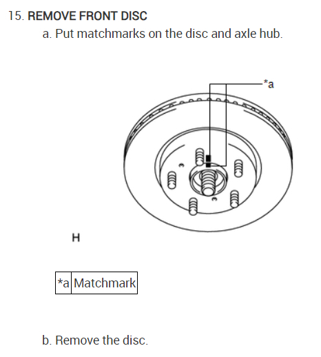

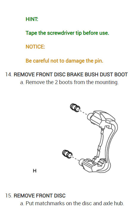

What is the average price to replace the front brake pads and hardware kit and remove and clean and lubricate caliper pins on both sides?
2017 TOYOTA RAV4
100,000 MILES • 4 CYL • 4WD • AUTOMATIC
NYRITA
my brakes were grinding so I took it to a mechanic, and they said that they need to replace the front brake pads and hardware kit and remove and clean and lubricate caliper pins on both sides and gave me a quote of $600. Would that be an average price?
Sep 28, 2024 at 3:46 AM
  • 55,325 POSTS

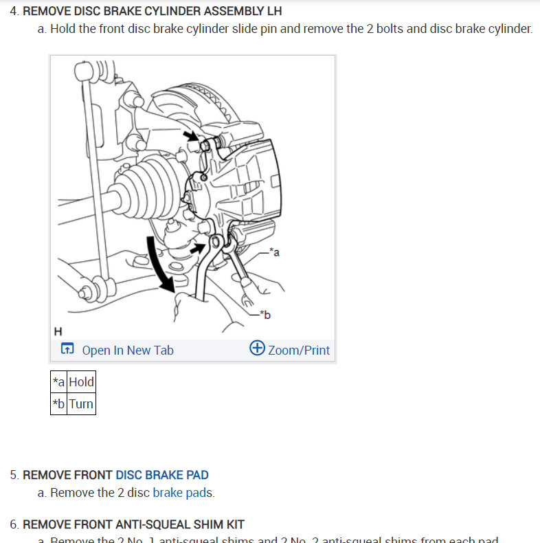

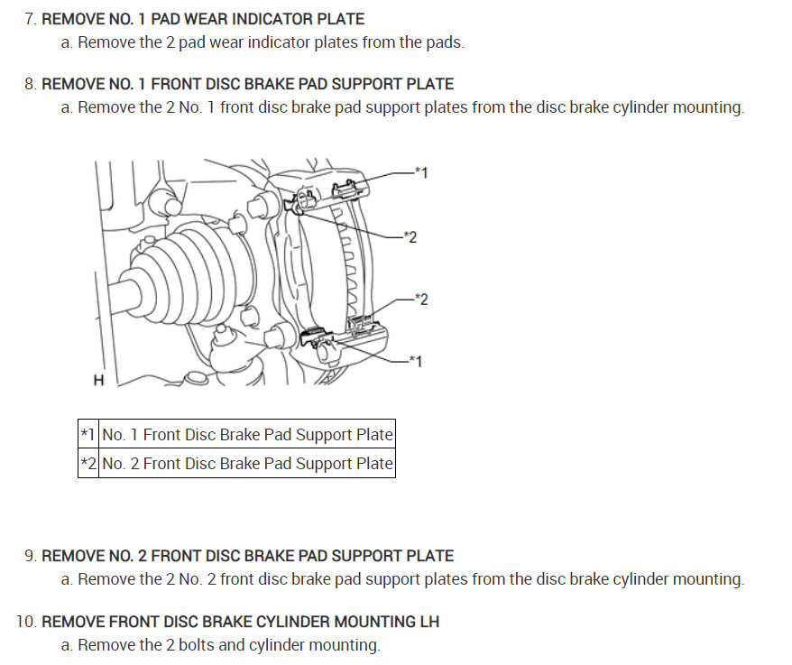

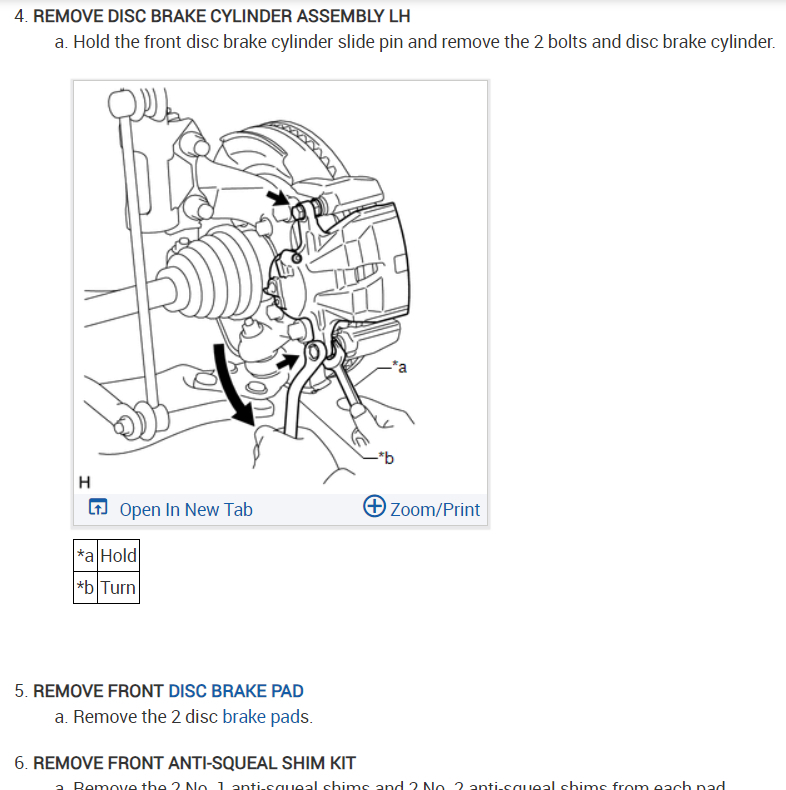

That sounds a little steep, I would call around. Did you want to do the job yourself? This is how and you can get the parts from Amazon for about $160 for front and rear brake pads and rotors with fluid and brake cleaner and hardware kit.
https://amzn.to/3ZCdgQW
Here is a video of the job being done on a similar car, the process is the same:
https://youtu.be/VtqeB0qgrTs?si=9D0VXF59sDMkj09M
Make sure to go over this guide as well before you begin.
and
https://www.2carpros.com/articles/how-to-break-in-brake-pads-or-rotors
Make sure to do it one side at a time and pump the brakes and have a good brake pedal before you drive it. Check out the images (below). Let us know if you need anything else.
Sep 28, 2024 at 5:04 AM
