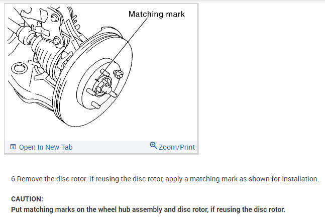

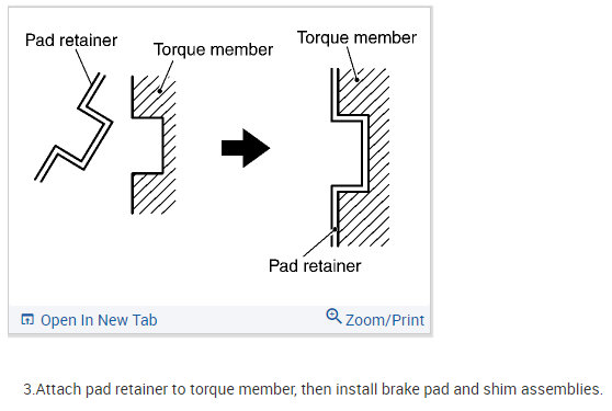

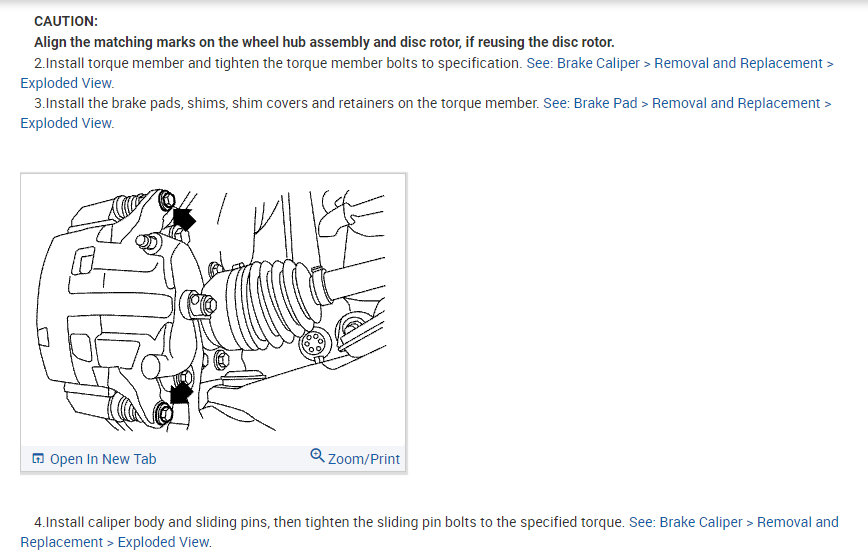

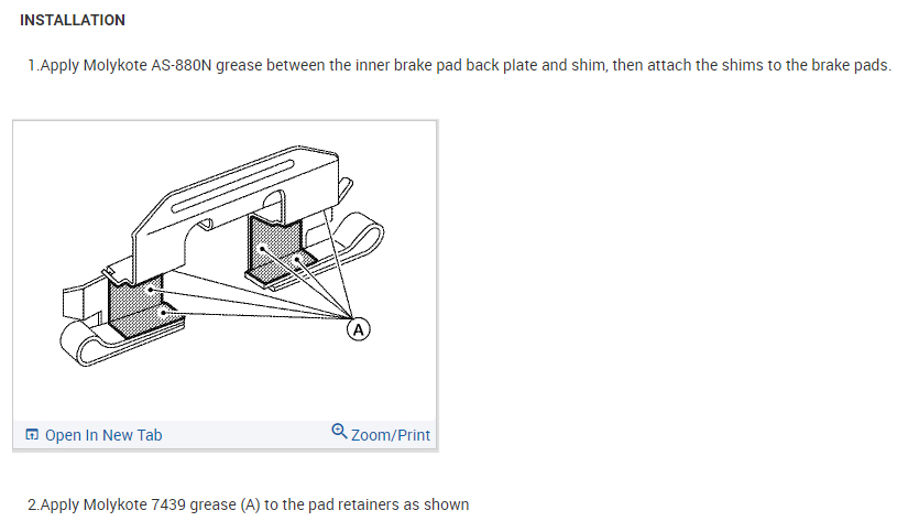

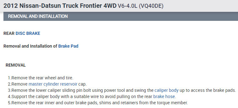

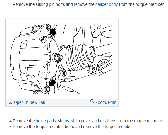

Hello, I'm Danny.

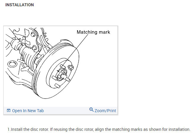

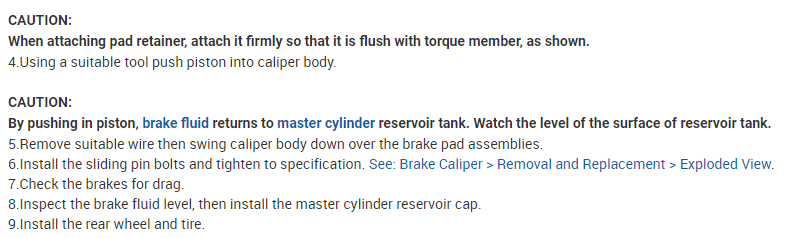

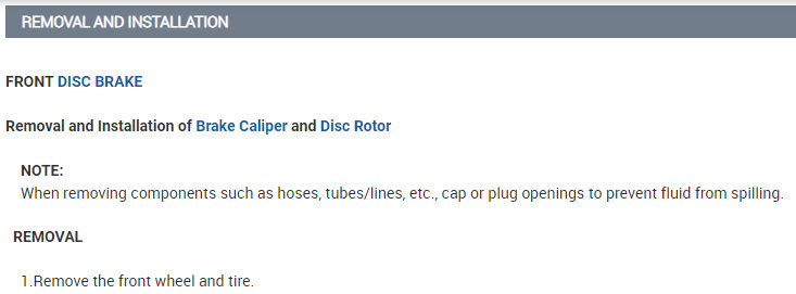

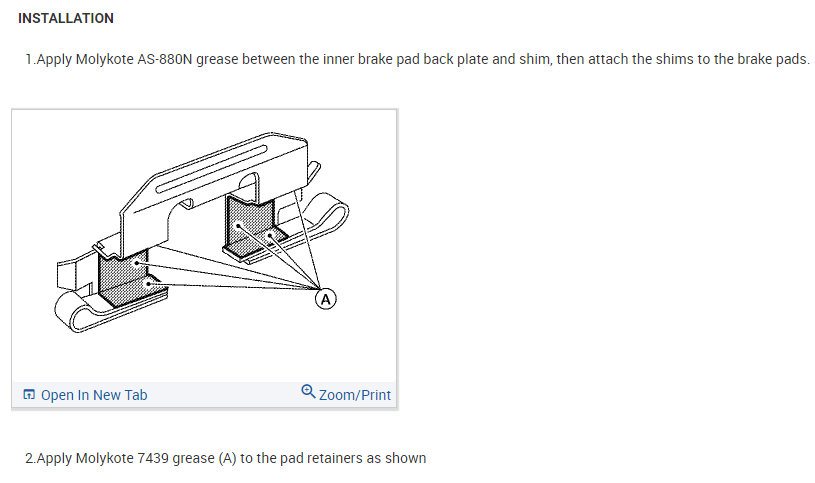

Here is the information you requested. This is a tutorial showing what is involved on how to change front brake pads and brake rotors:
I've attached picture steps below on how to change the front brake pads and rotors on your truck. Hope this helps and thanks for using 2CarPros.

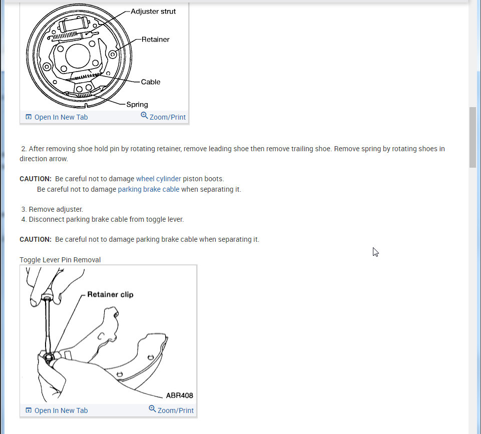

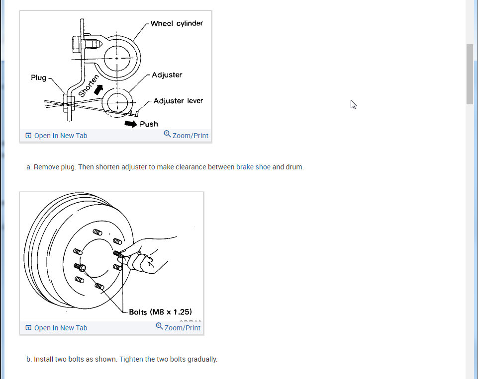

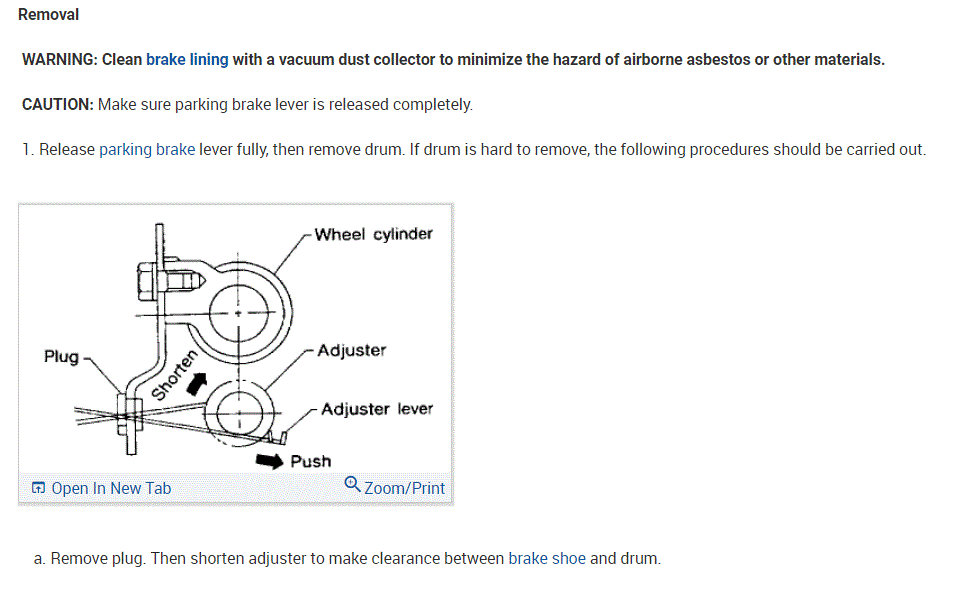

Here is a guide that will help with this:
https://www.2carpros.com/articles/how-to-replace-rear-brake-shoes-and-drums
Here is a video on a similar vehicle:
https://www.youtube.com/watch?v=3W0fs6shT3o
Below is the process from the manual. Please let us know if you have other questions on this. Thanks

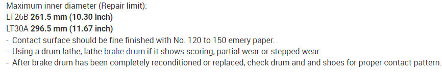

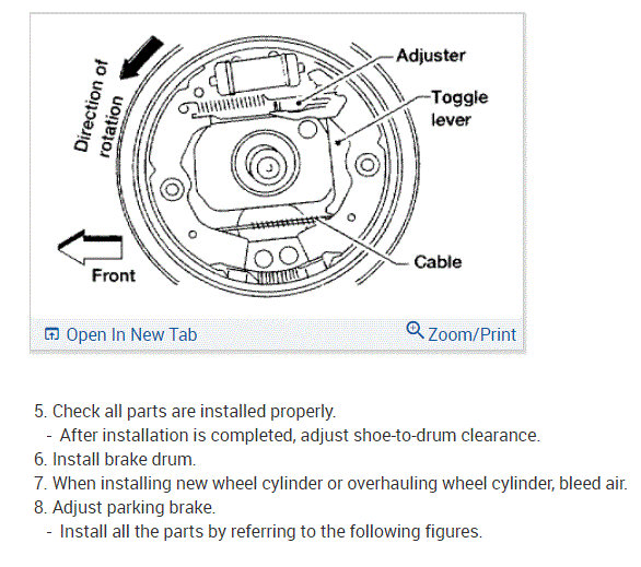

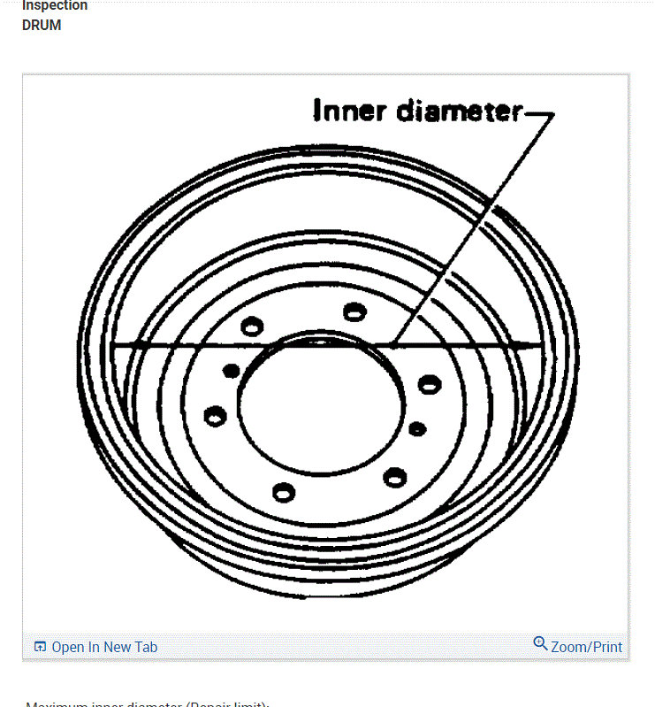

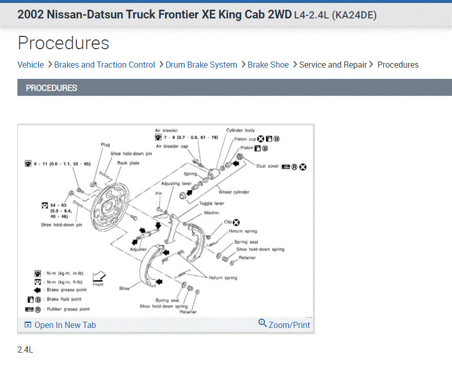

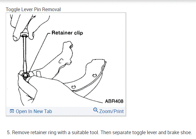

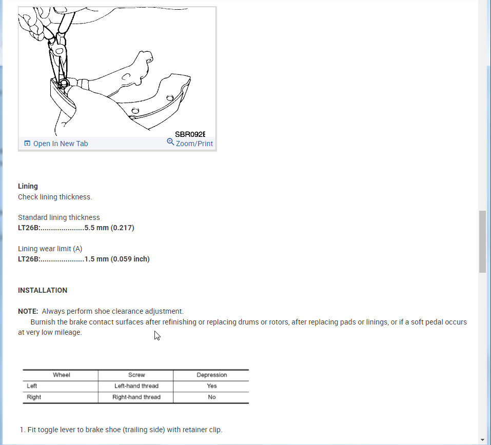

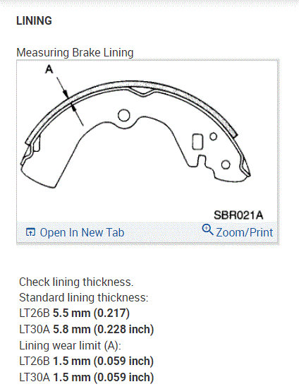

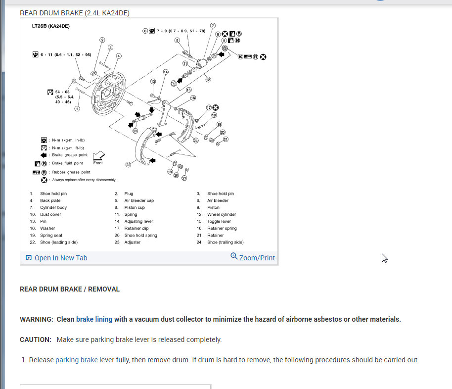

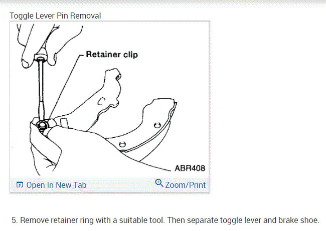

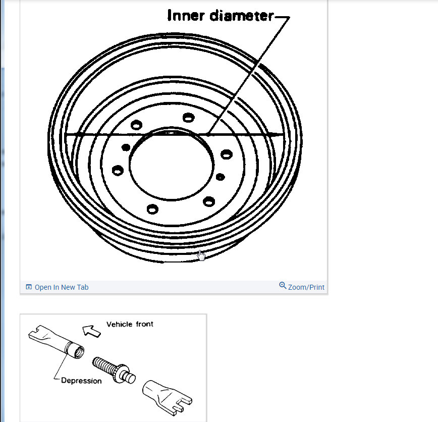

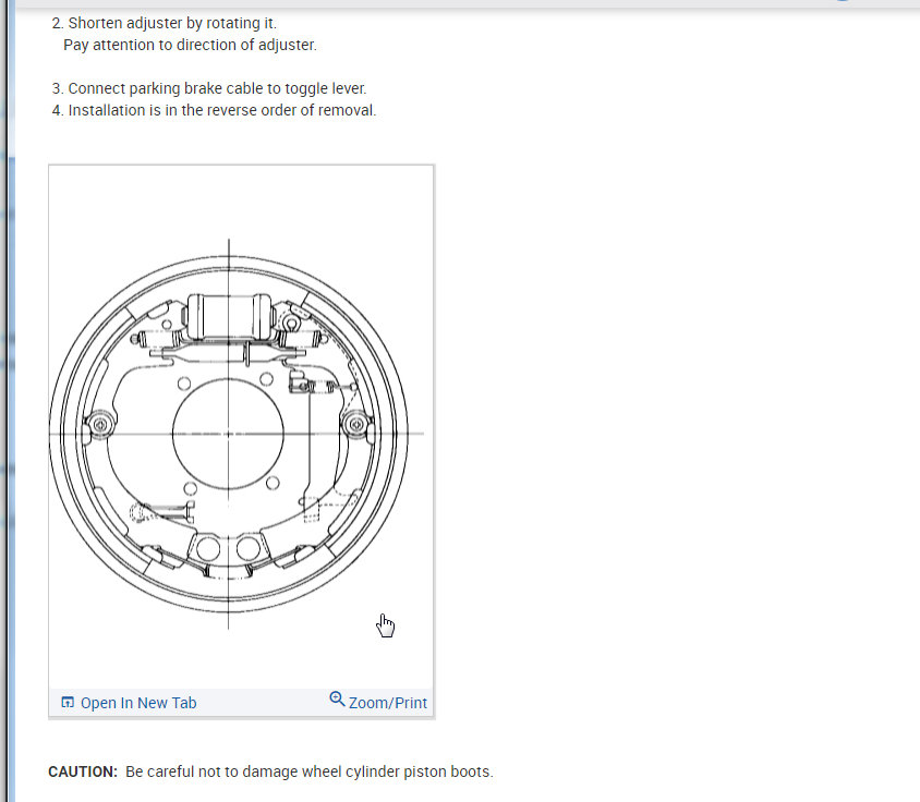

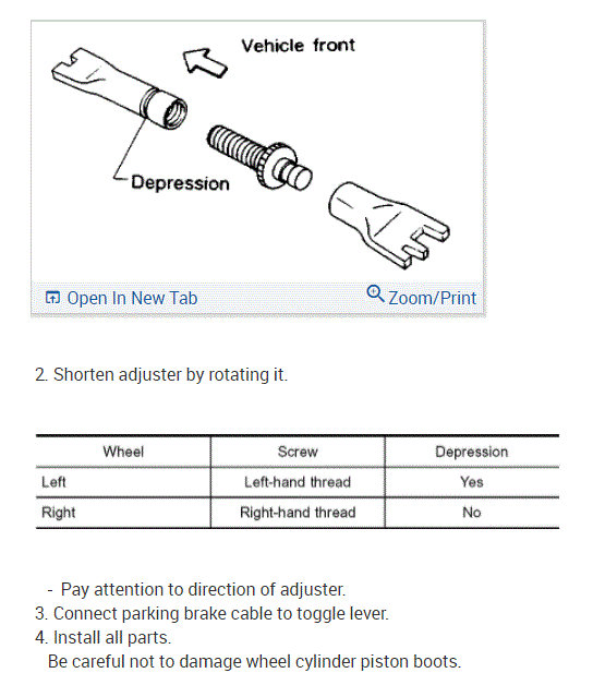

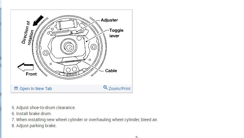

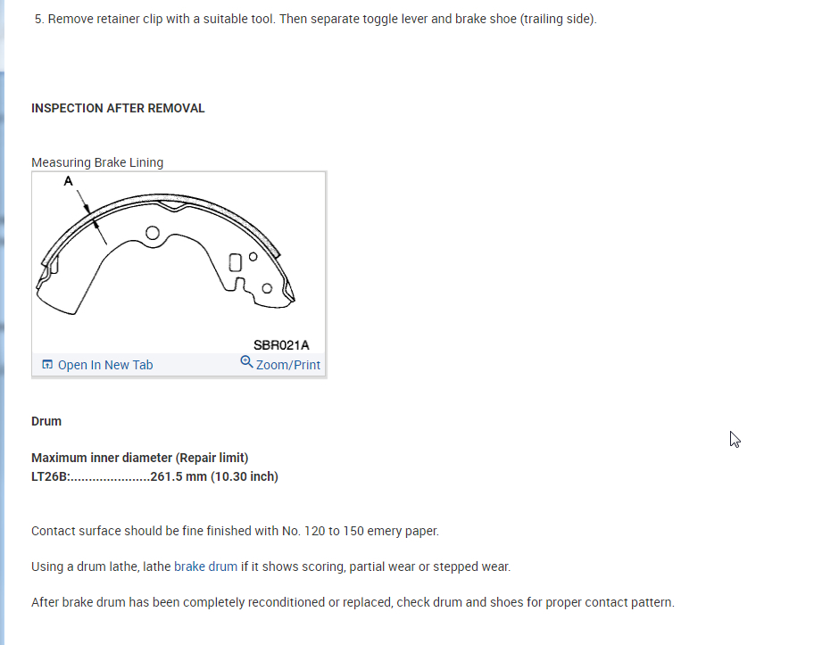

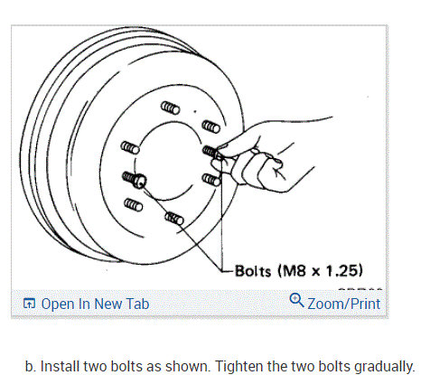

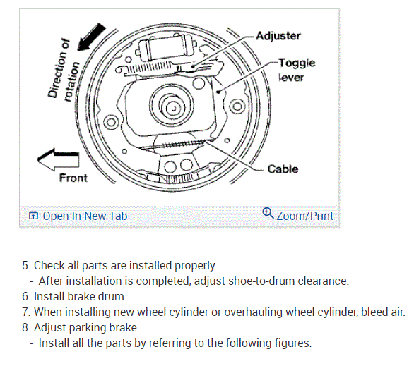

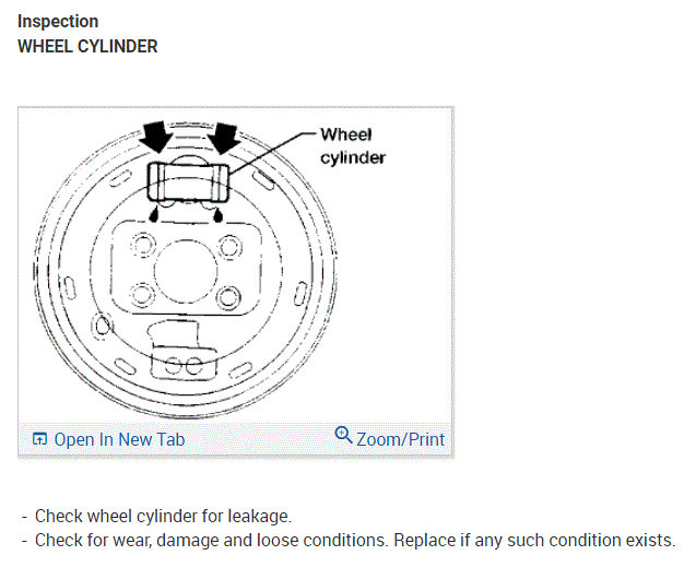

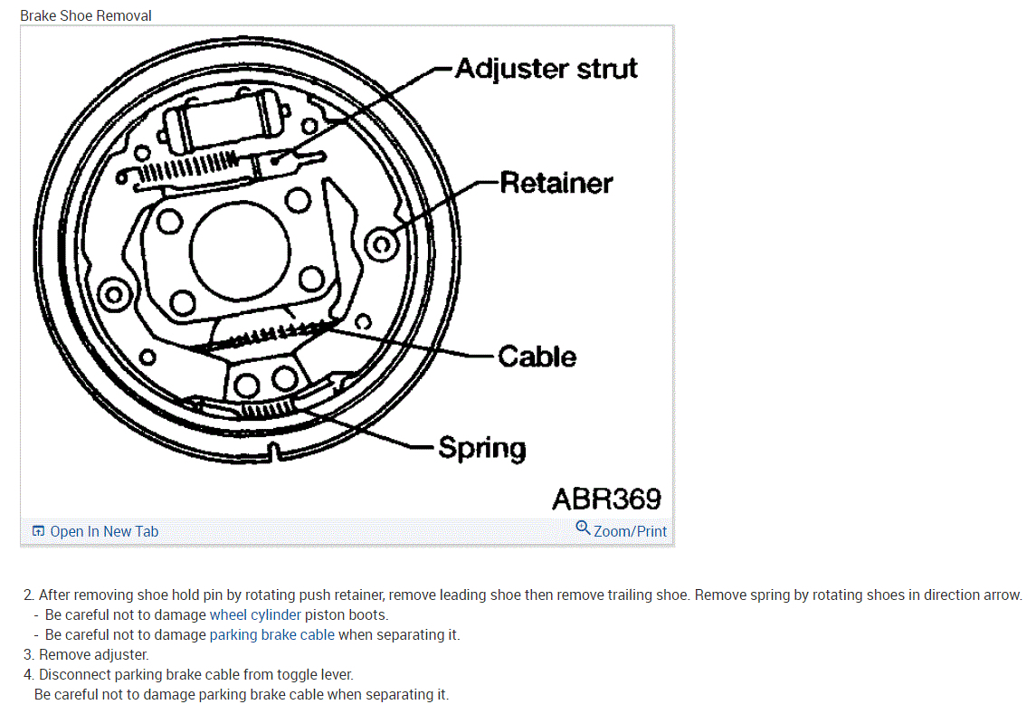

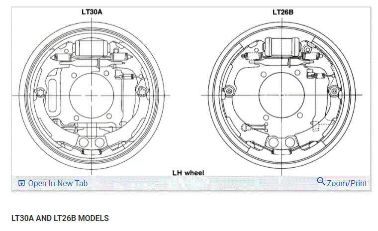

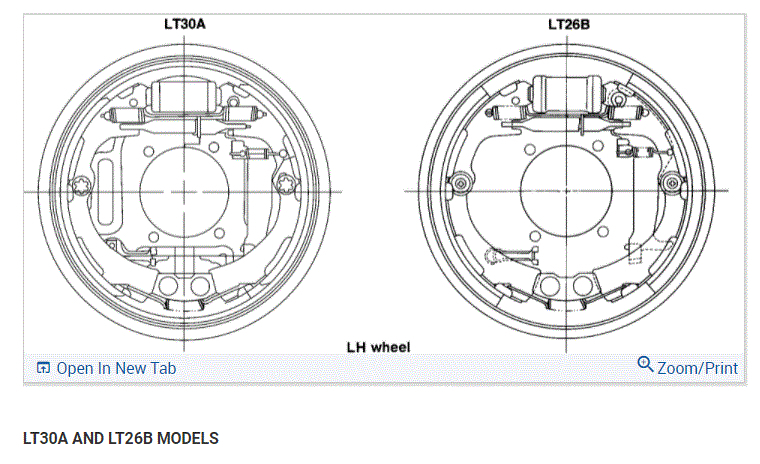

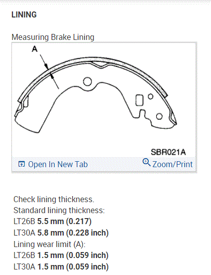

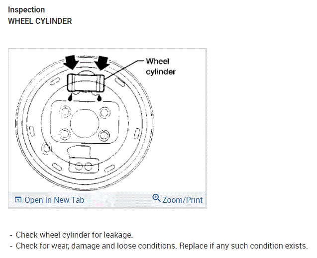

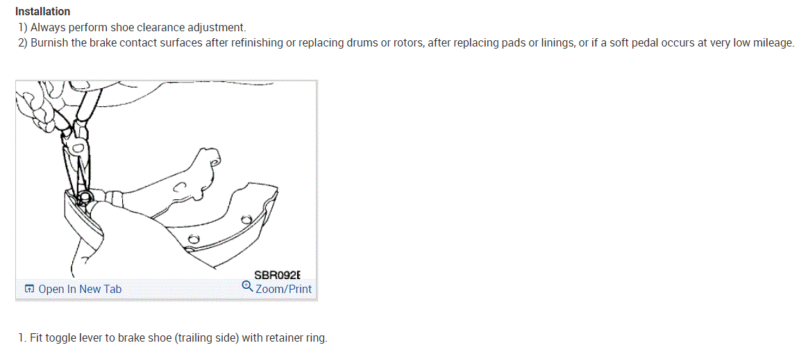

Replacing the rear brake shoes and drums isn't too hard to do. Just make sure to get a lifetime brake shoe so you don't have to pay for them again in the future.
You can expect rear brake pads to last approximately 30,000 miles. However, that will change based on driving habits and terrain.
To get you started, here is a link that explains in general how it is done. You can use this as a guide.
If you look at the attachments below, they provide the directions specific to your vehicle for the rear brake shoe and drum replacement.
