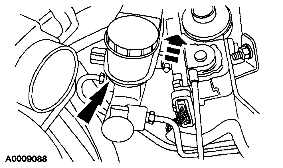

1. Disconnect the battery ground cable.
2. Remove the air cleaner outlet pipe.
pic 1

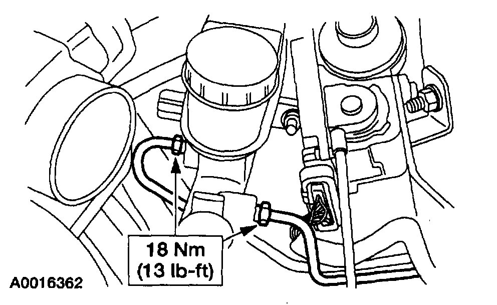

3. Disconnect the brake fluid level sensor electrical connector.
pic 2

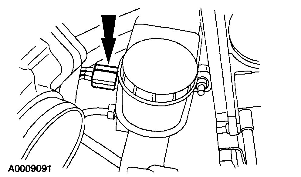

4. Loosen the fittings and disconnect the brake tubes.
pic 3

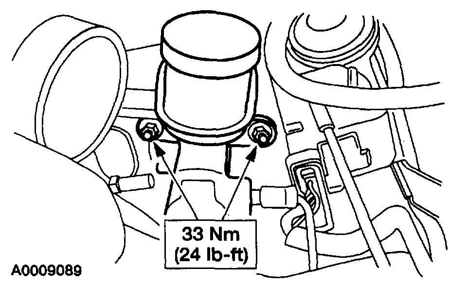

5. Remove the bolts and the brake master cylinder.
6. NOTE: If a new master cylinder is being installed, the new master cylinder must be bench bled.
To install, reverse the removal procedure.
7. Bleed the brake system.

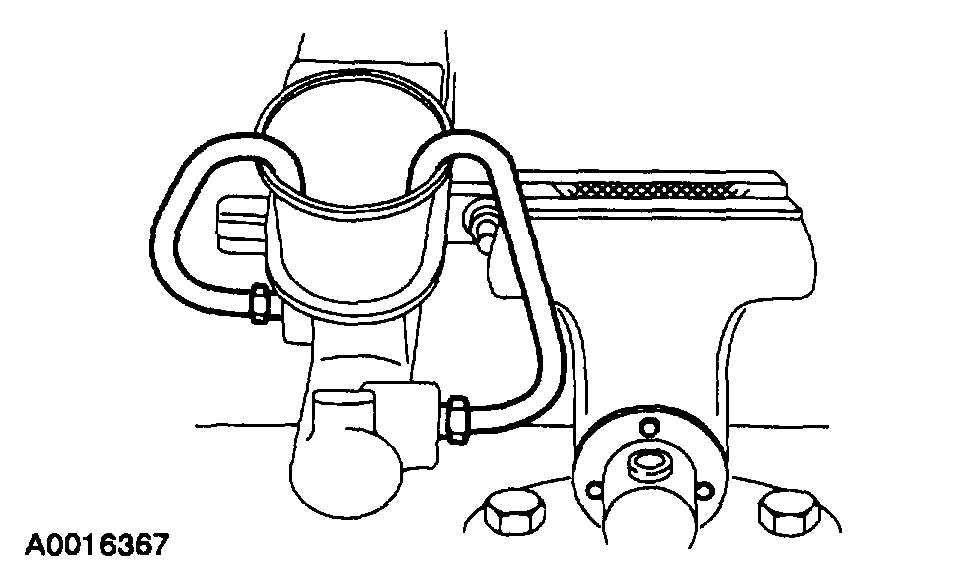

1. Disconnect the brake fluid level sensor electrical connector.
pic 5
2. Use a suitable suction device to drain the brake master cylinder reservoir.
3. Using a screwdriver, carefully pry up on the brake master cylinder reservoir and remove.

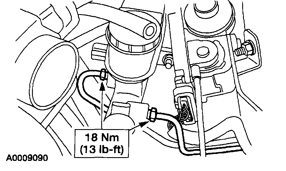

1. For in-vehicle priming, disconnect the brake lines from the brake master cylinder .
