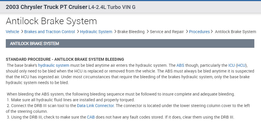

Brakes do I bleed or anything? We replaced the master cylinder, and now we don't have any fluid coming out of the lines at all.

Okay, yes, we tried that, and it didn't work. but now what we did was pull off all the brake lines from the calipers and I think we got stuff messed up. So, is there anything you might be able to tell me like as if I was starting from having everything brand new and no fluid in it whatsoever and I think you should it has an ABS system as well.
Sep 12, 2022 at 3:06 PM
  • 110,241 POSTS

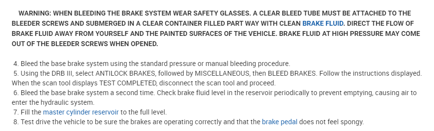

If you had the ABS apart, then it needs to be bled as well. This procedure requires a scan tool that can communicate with the antilock brake module.
If you look below, I attached the directions for the procedure.
