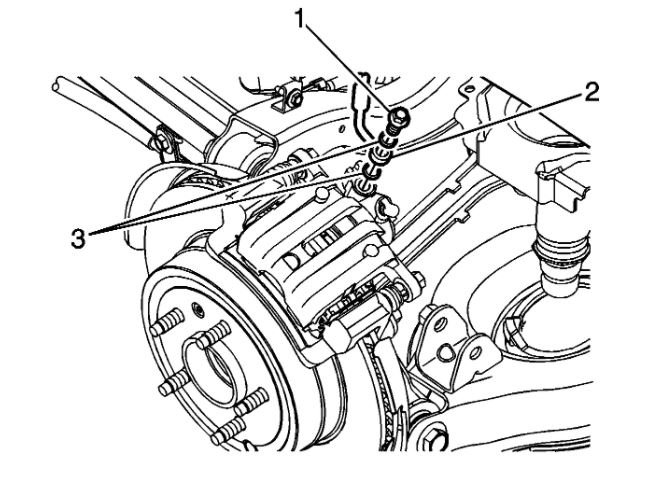

so much so that when i touched it the skin was seared off my finger. The other rotors don't do this, they only get mildly warm. I changed the brake caliper because the heat can only be caused by friction from the brake pad. Even the lug area of the rotor is getting blistering hot after a few minutes at highway speed.
Changing the caliper had no effect. I bled the brakes when i put the new caliper on the offending rotor. Why else could the brakes be causing so much friction if not a sticking caliper?
Jan 19, 2021 at 7:35 AM
Good evening,
The brake hose is a very common failure for collapsing and not allowing the caliper to release and overheating the rotor.

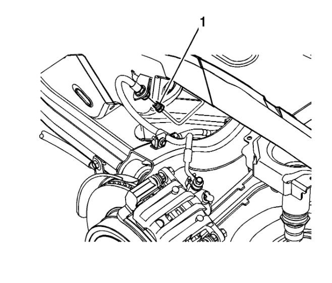

3. Disconnect the brake pipe fitting (1) from the brake hose.
Cap the brake pipe fitting to prevent brake fluid loss and contamination.

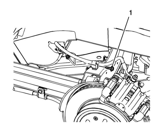

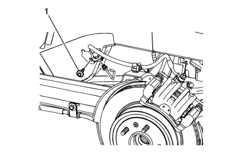

4. Remove the brake hose bolt (1) securing the brake hose bracket to the wheelhouse.
5. Remove the brake hose bracket bolt (1).
6. Remove the brake hose fitting bolt (1) from the brake hose and the caliper.
7. Remove the brake hose (2) from the caliper.
Note:
Do not reuse the brake hose fitting gaskets.
8. Remove and discard the brake hose fitting gaskets (3).
9. Remove the brake hose.
