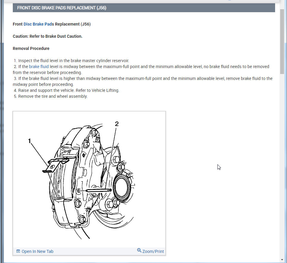

Have replaced the the rear brake now i need to do the fronts.

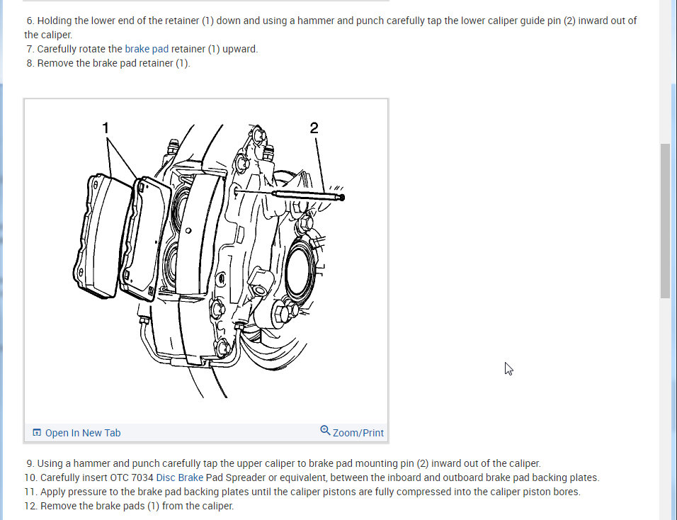

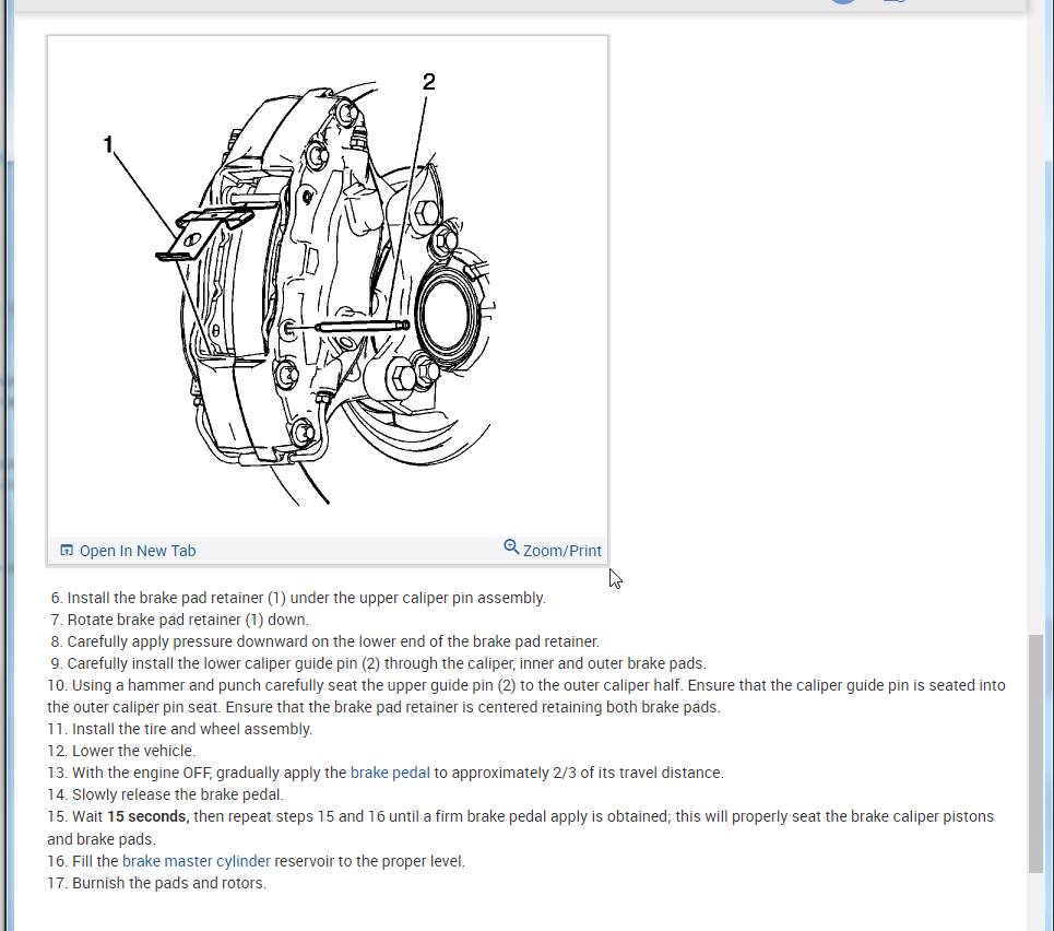

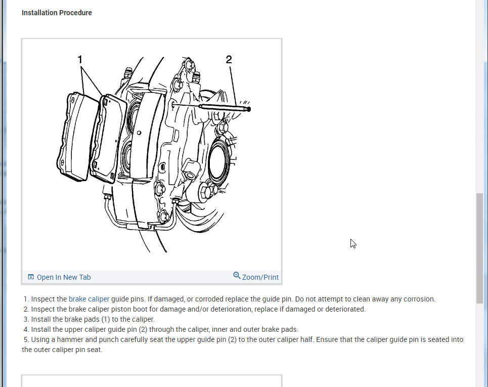

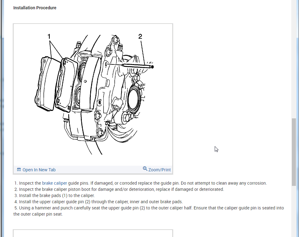

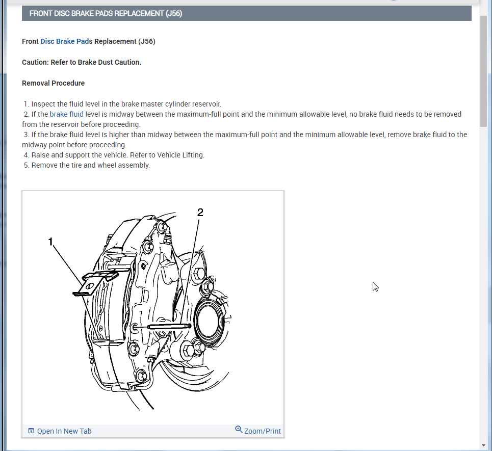

Here is a guide that will help with this:
Below you will find the process from the manual on how to replace these brakes. Please run through this material and let us know if you have other questions.
