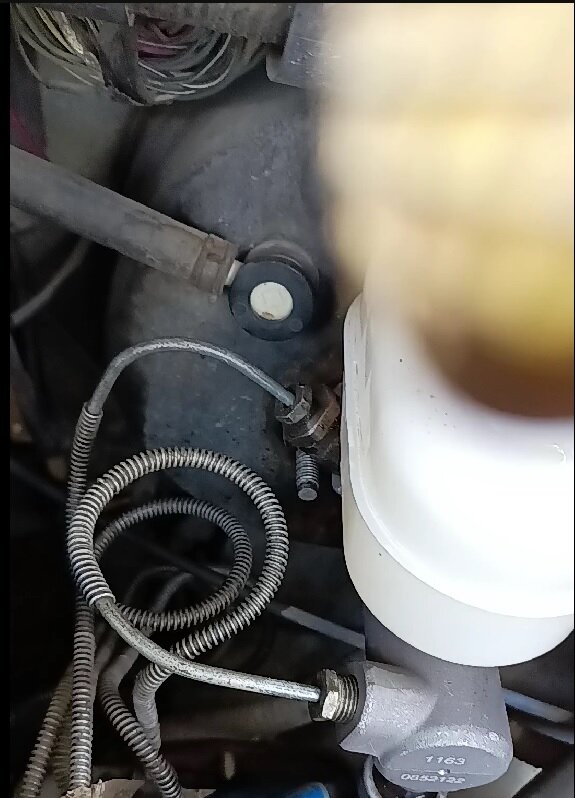

Yes, the second scenario is the correct test, also, with the engine off you can remove the vacuum check valve from the booster and hear vacuum escaping, this means the booster can hold vacuum.

Ok cool. I did the second test i was telling you about and when i turned on the van the brake pedal sink slightly too. I was happy to see that but i will try your test too. You are talking about the plug on the firewall that is black and has a white dot in the middle of it correct? And here is something i did once i got home in driving up my driveway. I gave my van kinda alot of gas and then press the brake pedal kinda hard this time and then my van started to run kinda rough. Any idea what they could be? I have brake sure enough but that's what happened after i did that.

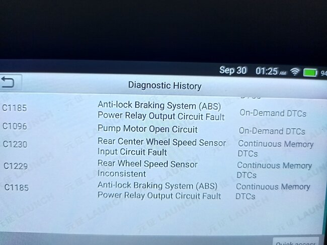

Ok... here i go.. :-) And here are the codes for the brakes C1230 read center wheel speed sensor input circuit fault & C1229 rear wheel speed sensor inconsistent It had 3 other codes but i can't seem to find them on my scanner.

I have brakes but the follow error codes have shown up now... I thought you might wanted to see the error codes. Also i created a new CEL thread but when i try and click on it it says error and won't pull up. This is the first time i have ever seen this many error codes for brakes
