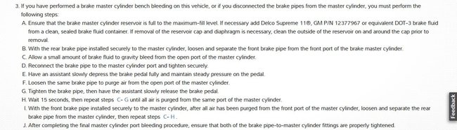

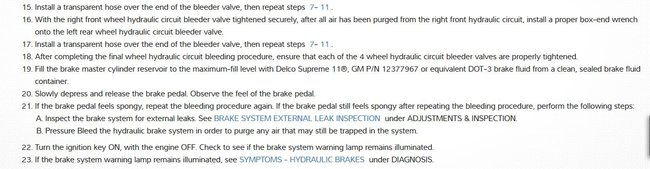

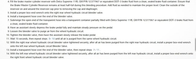

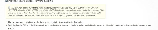

Here is the bleed sequence as per Mitchel 1let me know how you get on.
Aug 27, 2020 at 11:27 AM
CARPETMAN1759
  • 81 POSTS
I have this same write-up in one of my books. Have done this three times today and have great peddle after it is done, but when I start the engine the peddle just hits the floor when you push on the peddle. Thanks for your time!
