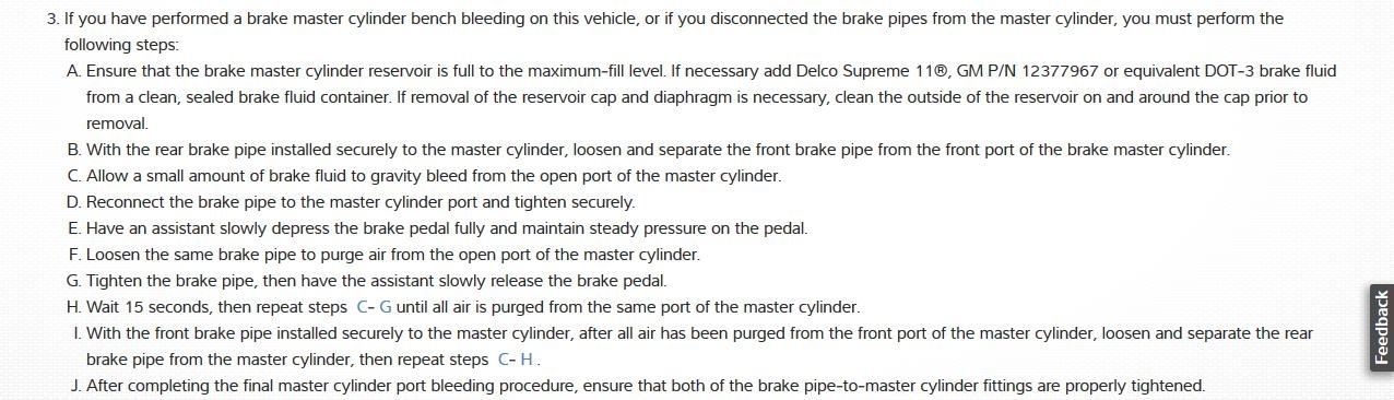

No brakes! Rusted out brake line to rear brakes at frame near exhaust manifold. Replaced with 12 inch flared tubing which is working great with no leaks. Installed a new master cylinder and bled the brakes. Great brake peddle until you start the truck and the peddle goes to the floor. Brakes were working fine until the hole in the line happened. Rotors, pads and calibers are a month old. What am I missing?

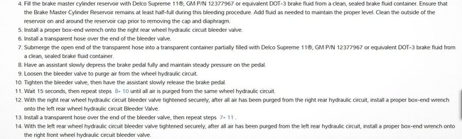

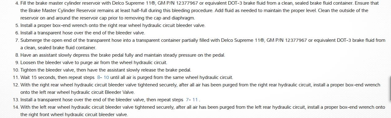

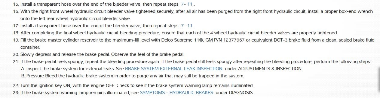

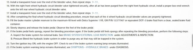

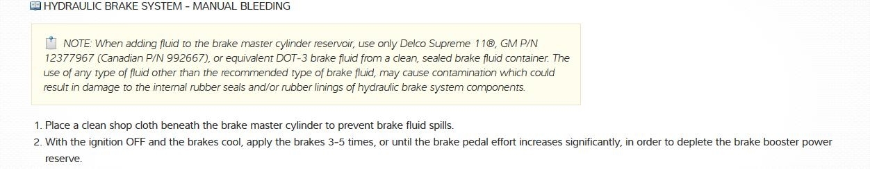

Here is the bleed sequence as per Mitchel 1let me know how you get on.
Aug 27, 2020 at 6:27 PM
CARPETMAN1759
  • 81 POSTS
I have this same write-up in one of my books. Have done this three times today and have great peddle after it is done, but when I start the engine the peddle just hits the floor when you push on the peddle. Thanks for your time!
