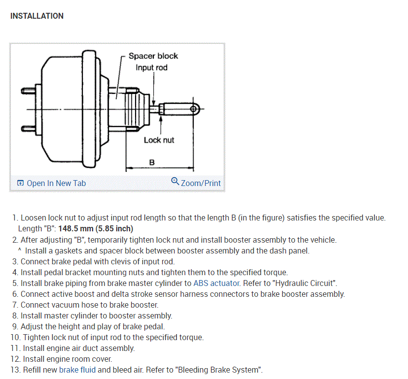

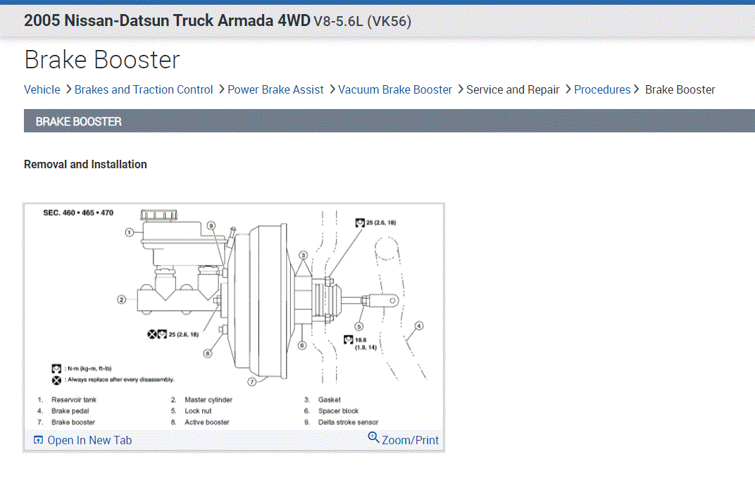

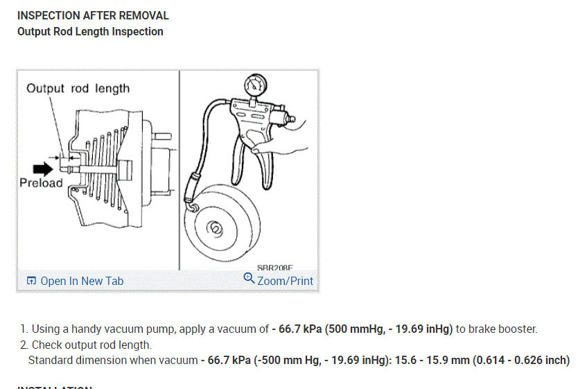

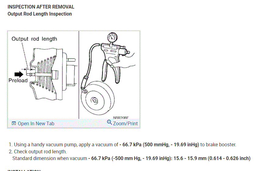

Do me a favor. Take a look at the attachments below. They show how the brake booster is replaced and how to adjust the push rod. Let me know if that helps.

You are very welcome. The idea that it is still going to the floor doesn't make sense. You could have gotten a bad new master cylinder. However, that is yet to be determined.
I assume the brake master cylinder was bench-bled prior to installation. If there are no leaks and the system has been fully bled, either the piston in the booster isn't moving far enough or the master cylinder is bad.
