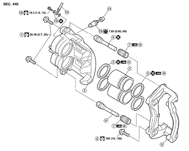

I cannot find factory specs for torque settings for front brake calipers and caliper holders for the vehicle listed above. I've been all over the internet and got lots of different answers. Please help!!

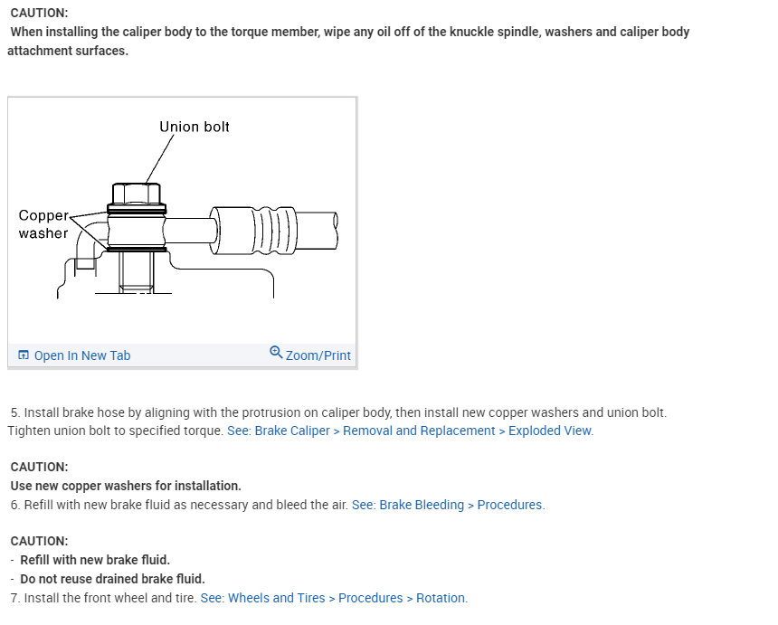

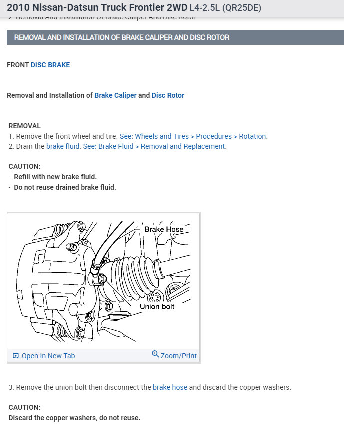

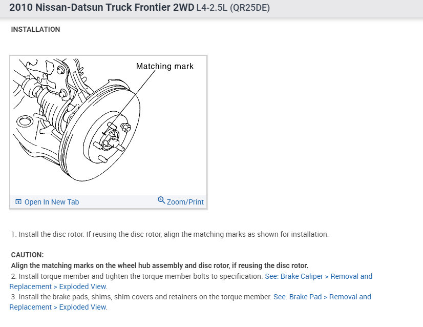

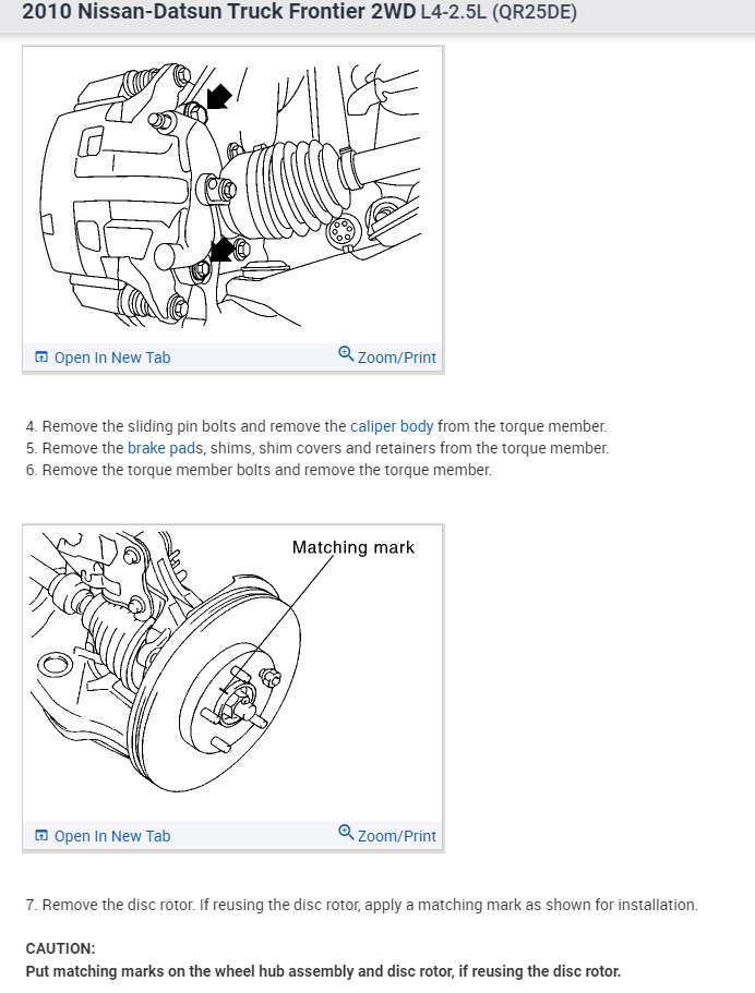

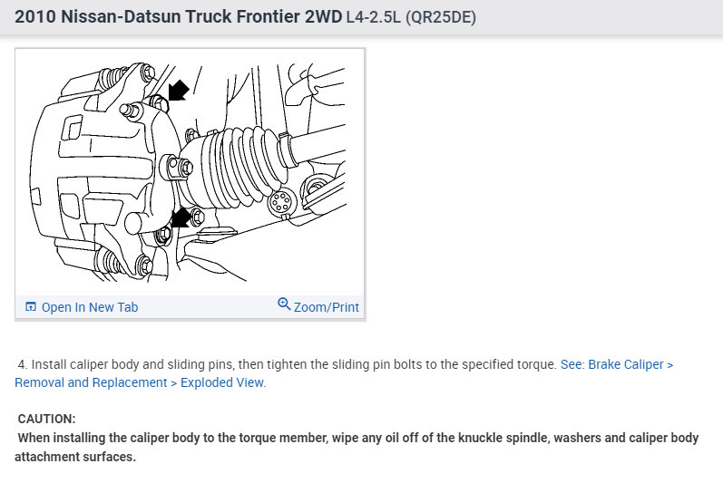

See attached for the caliper bolts torque specifications as well as replacement procedure.
https://www.2carpros.com/articles/brake-caliper-replacement
Let me know of any questions.
