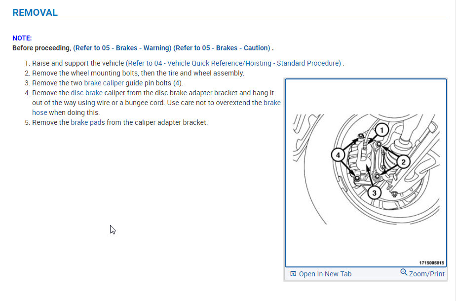

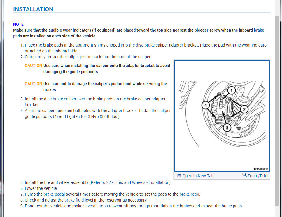

I recently took my vehicle to a dealership for inspection. they told me the front brakes were at 14% wear and so I need to do a brake job.
Mar 13, 2018 at 9:41 AM

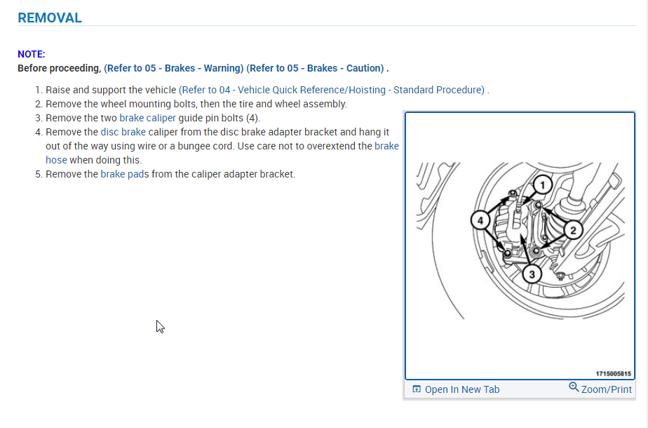

Here is a guide that will help with this:
Below you will find the process from the manual that will help with completing this as well. Please let us know if you have other questions. Thanks
