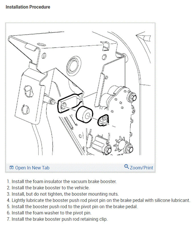

ust won't stop the brakes pedal is stiff
2007 CHEVROLET EQUINOX
170,000 MILES
AMUZENINA
But it just won't stop the brakes pedal is stiff and I hear hissing from under the dash. doing it. Please help me.
Apr 9, 2019 at 5:52 PM
  • 110,190 POSTS

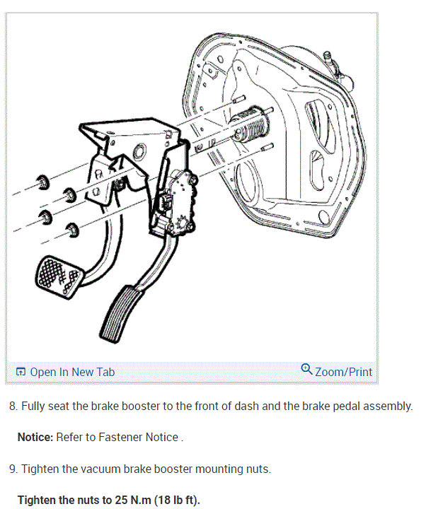

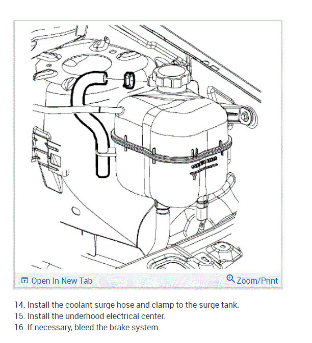

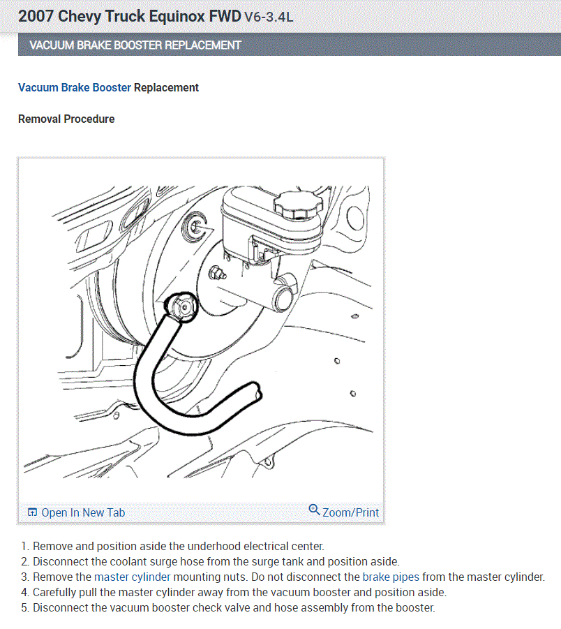

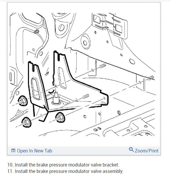

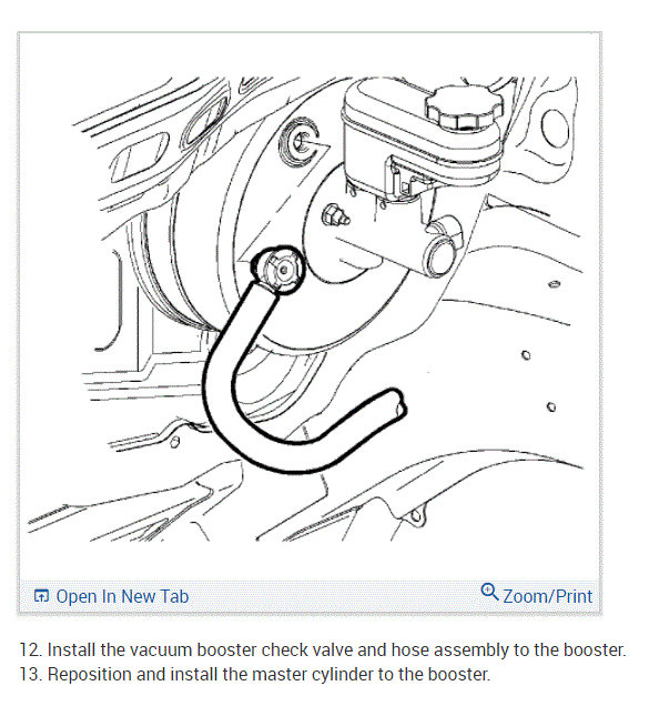

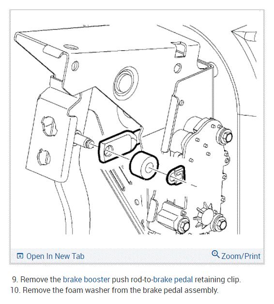

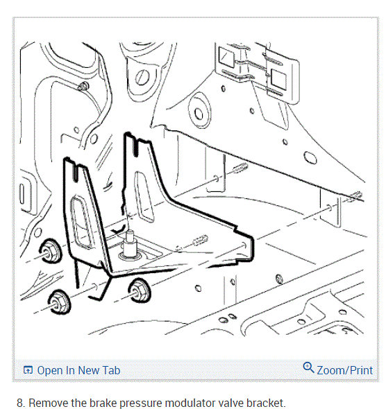

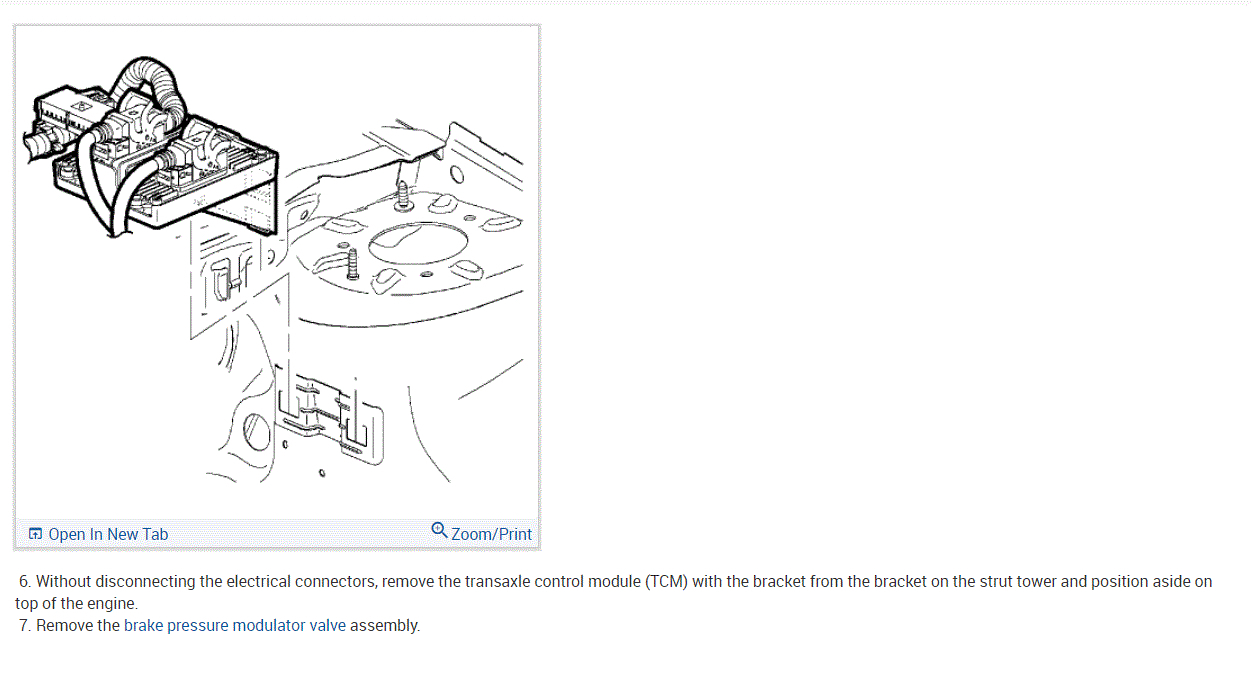

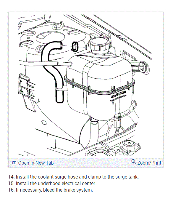

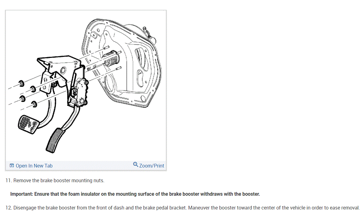

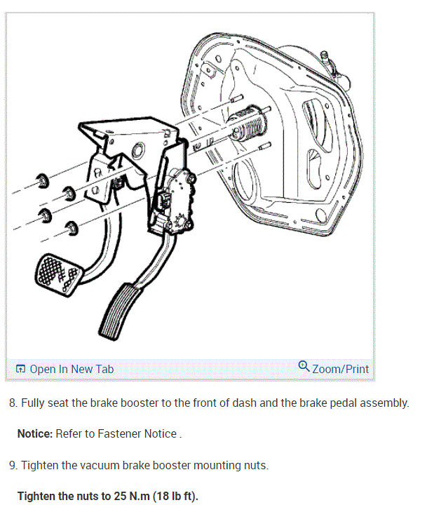

Replacing the booster isn't too hard. You will have to remove the brake master cylinder to access it. The worst part of the job is unbolting it from the firewall, It is one from the inside of the vehicle up under the dash.
If you look at the attachments below, I included the directions and the pics specific to your vehicle for replacement.
See pics below
