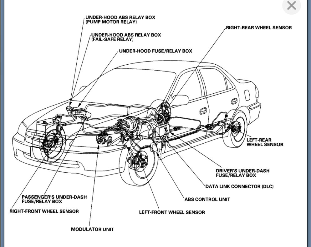

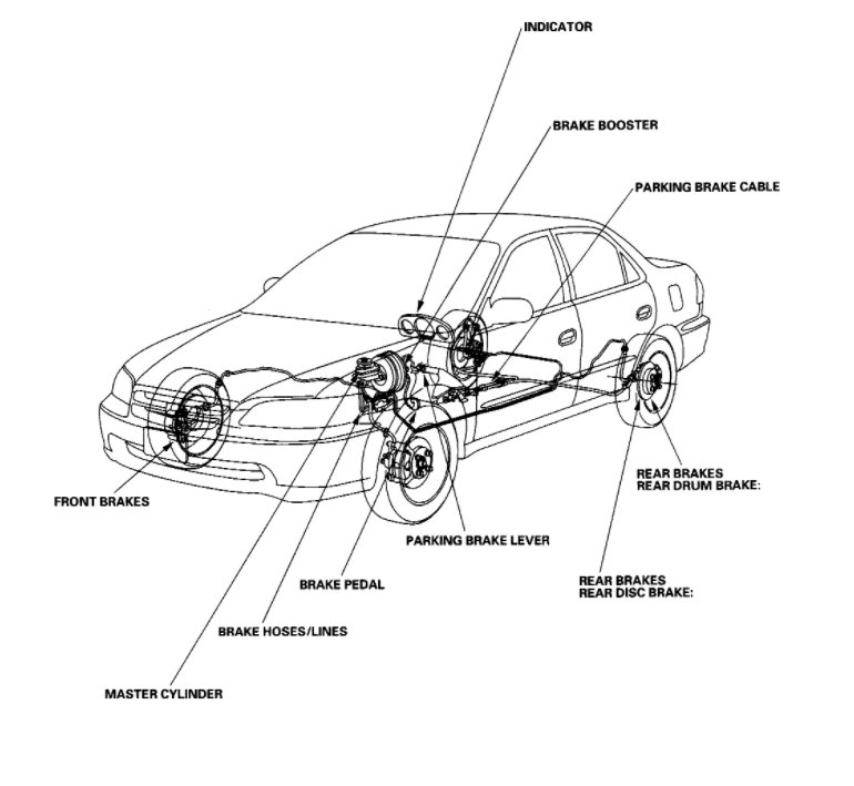

brakes fluid is leaking underneath about center of vehicle looks like a cover has lots of bolts on each side runs pretty far underneath. Fluid is leaking and dripping and spews worse when I pump the brake. How do I fix this problem? Thanks
Oct 18, 2018 at 2:46 AM
More than likely this is a brake line as you don't have any brake components in the center of the vehicle.
However, if you can get a picture of this, I am sure we can confirm what the issue is.
Once we complete this repair, we are going to need to bleed the brakes so here is a guide that will help with this:
https://www.2carpros.com/articles/how-to-bleed-or-flush-a-car-brake-system
Please see below for the diagrams of all the components in the vehicle related to the ABS and base brakes.
Let us know if you can get a picture of this and we will go from there.
