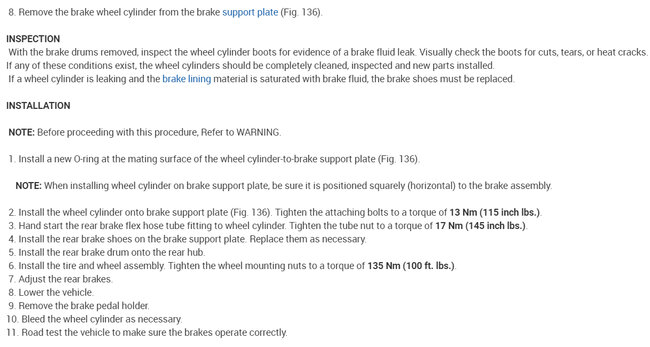

The passenger rear brake is leaking a considerable amount of brake fluid and when lifted with the emergency brake engaged the wheel/tire spins freely in both directions. What are the possible causes?
Sep 20, 2023 at 6:50 AM
  • 55,224 POSTS

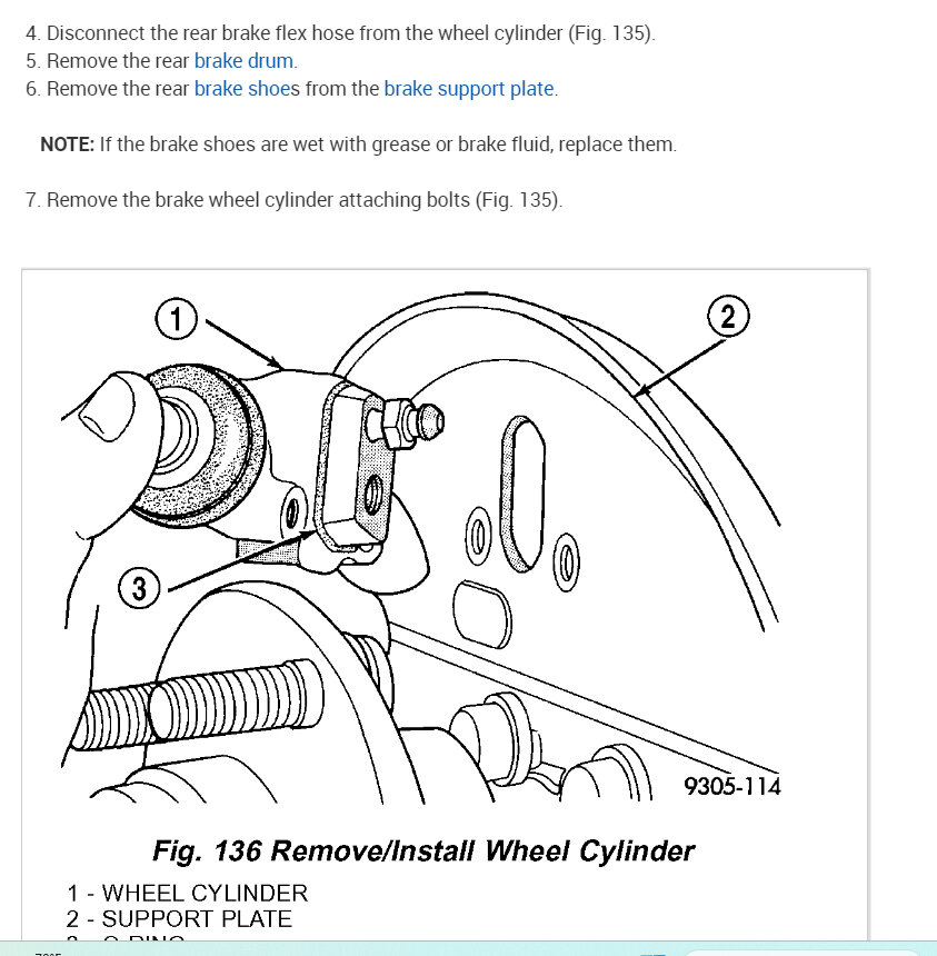

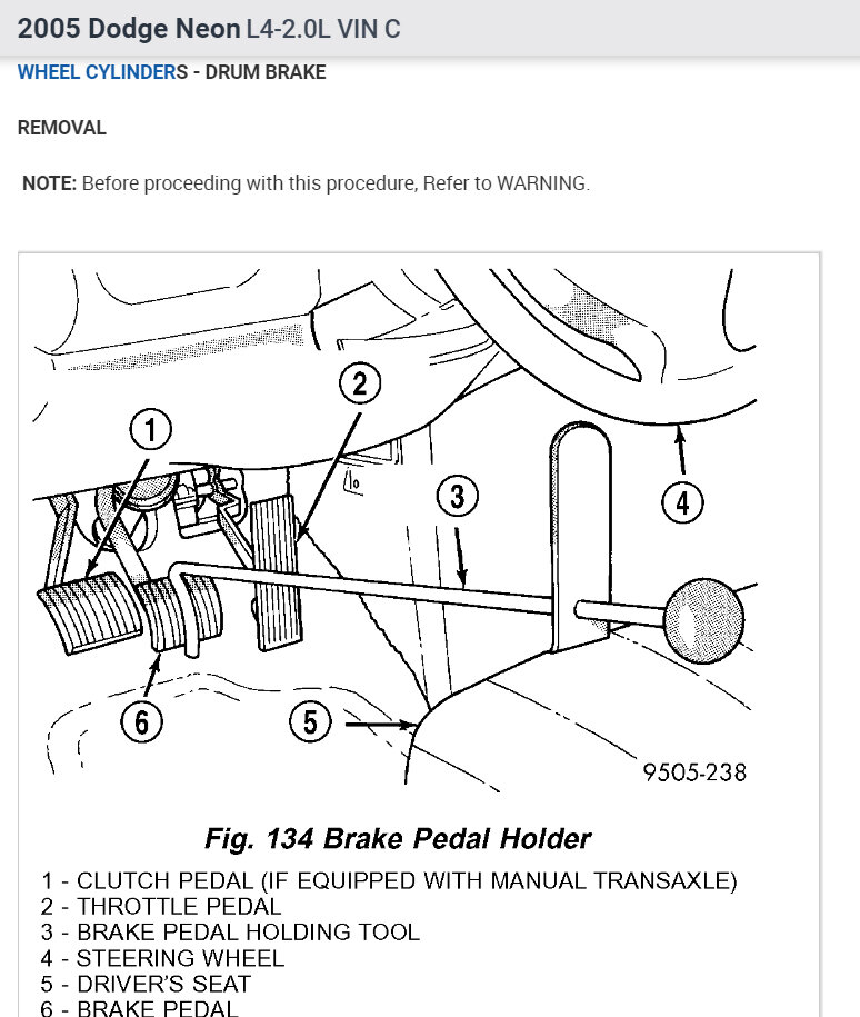

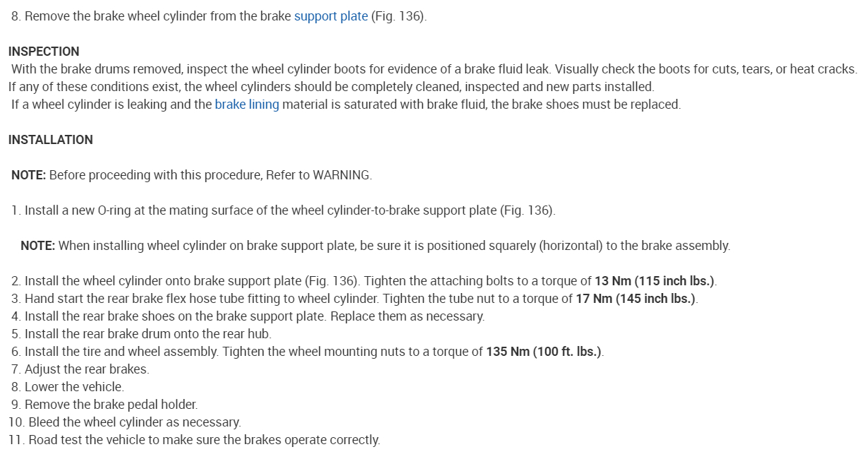

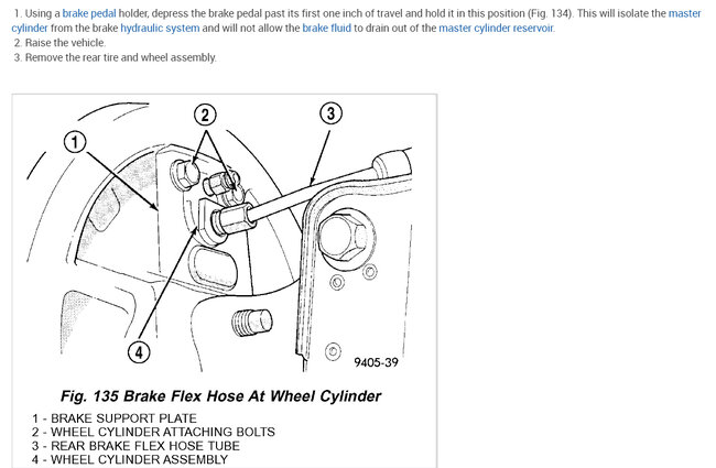

It is common to have the brake wheel cylinder leak. Here is a generic guide to help you step by step with instructions in the diagrams below to show you how on your car:
https://www.2carpros.com/articles/how-to-replace-a-wheel-cylinder
