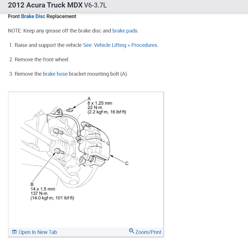

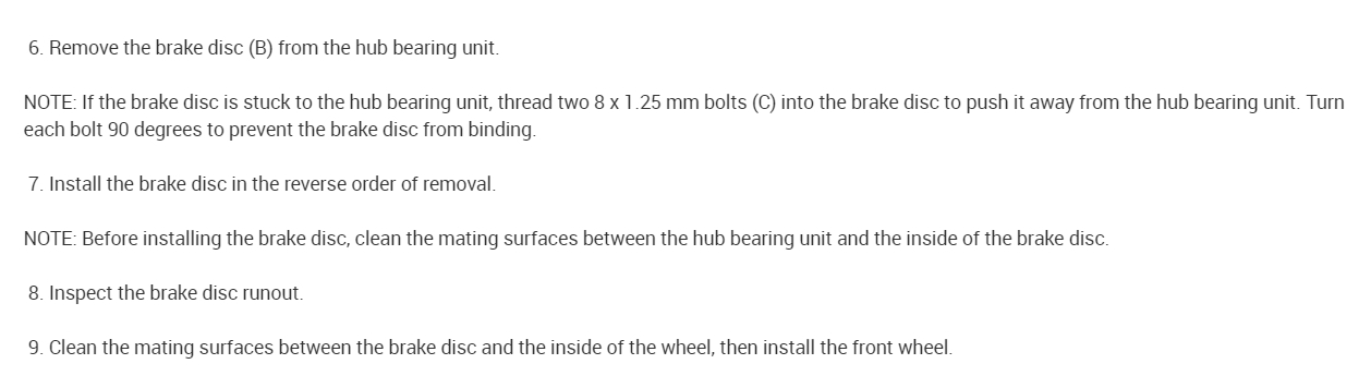

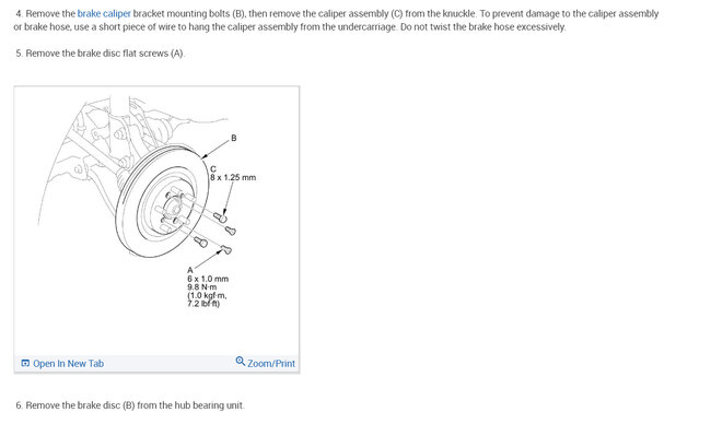

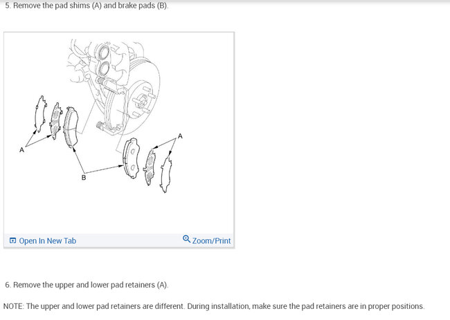

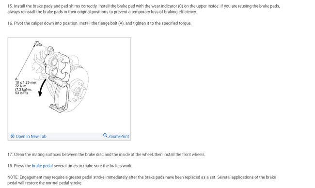

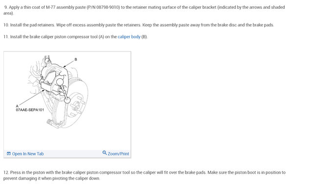

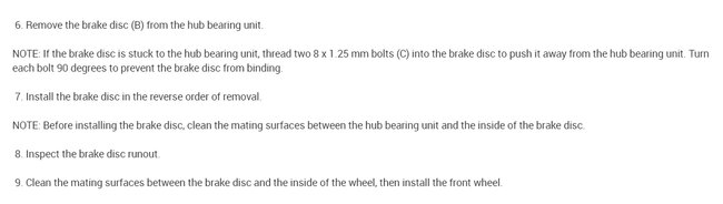

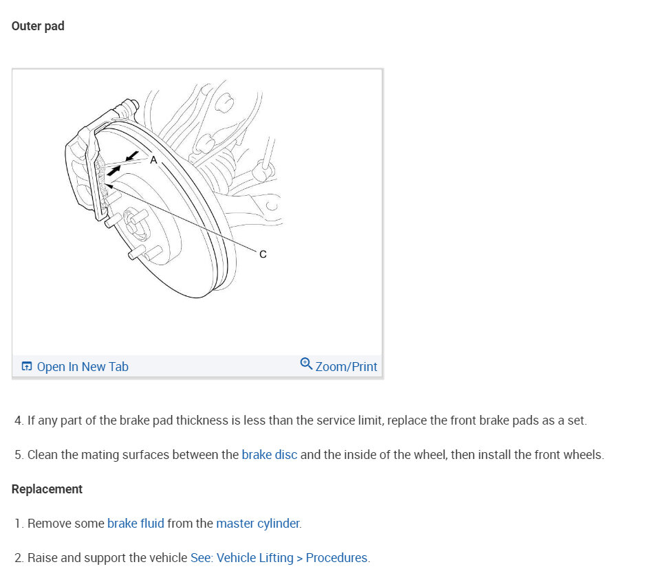

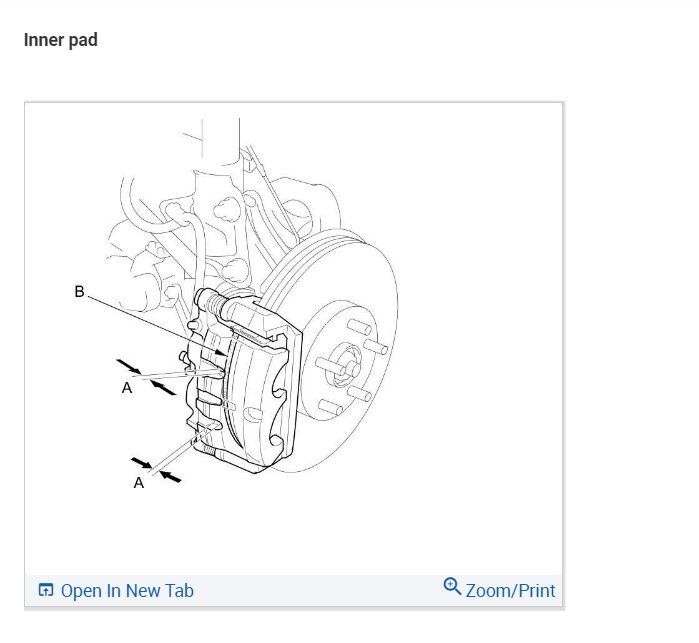

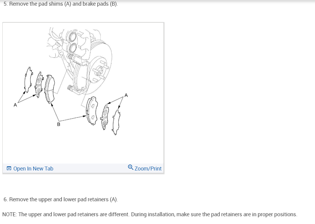

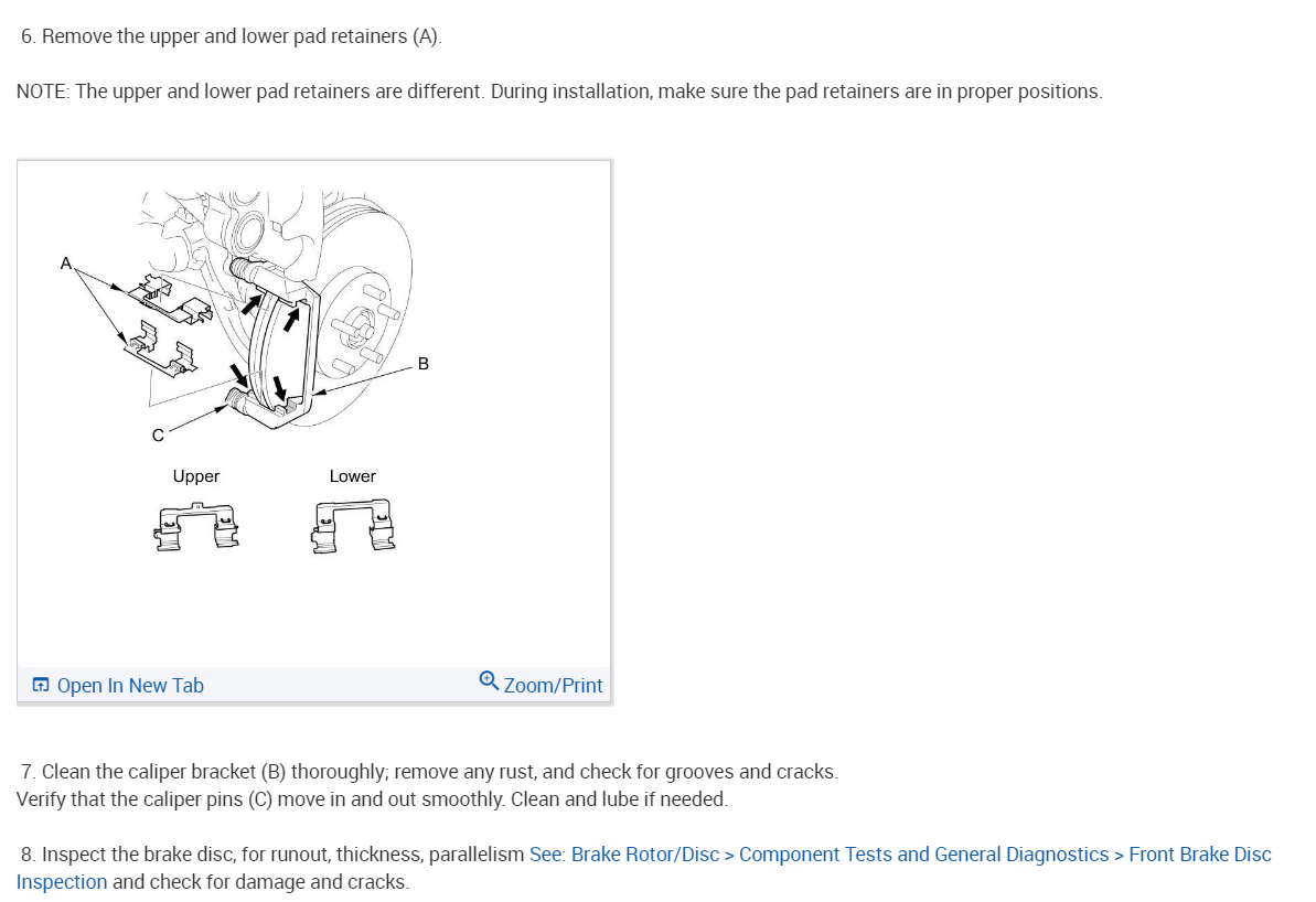

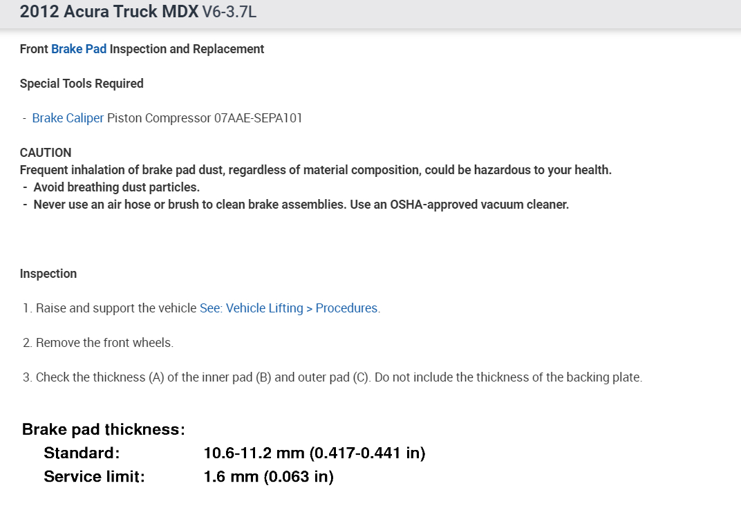

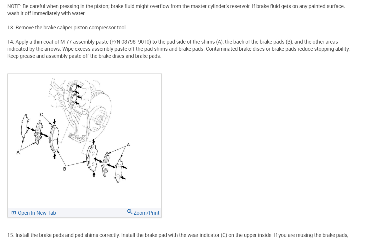

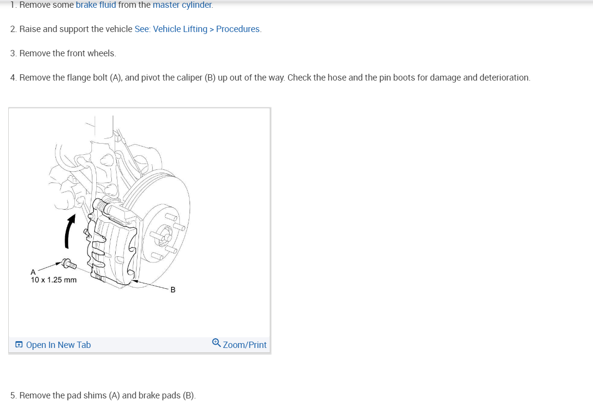

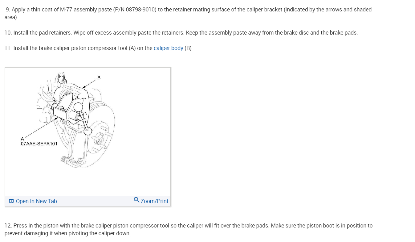

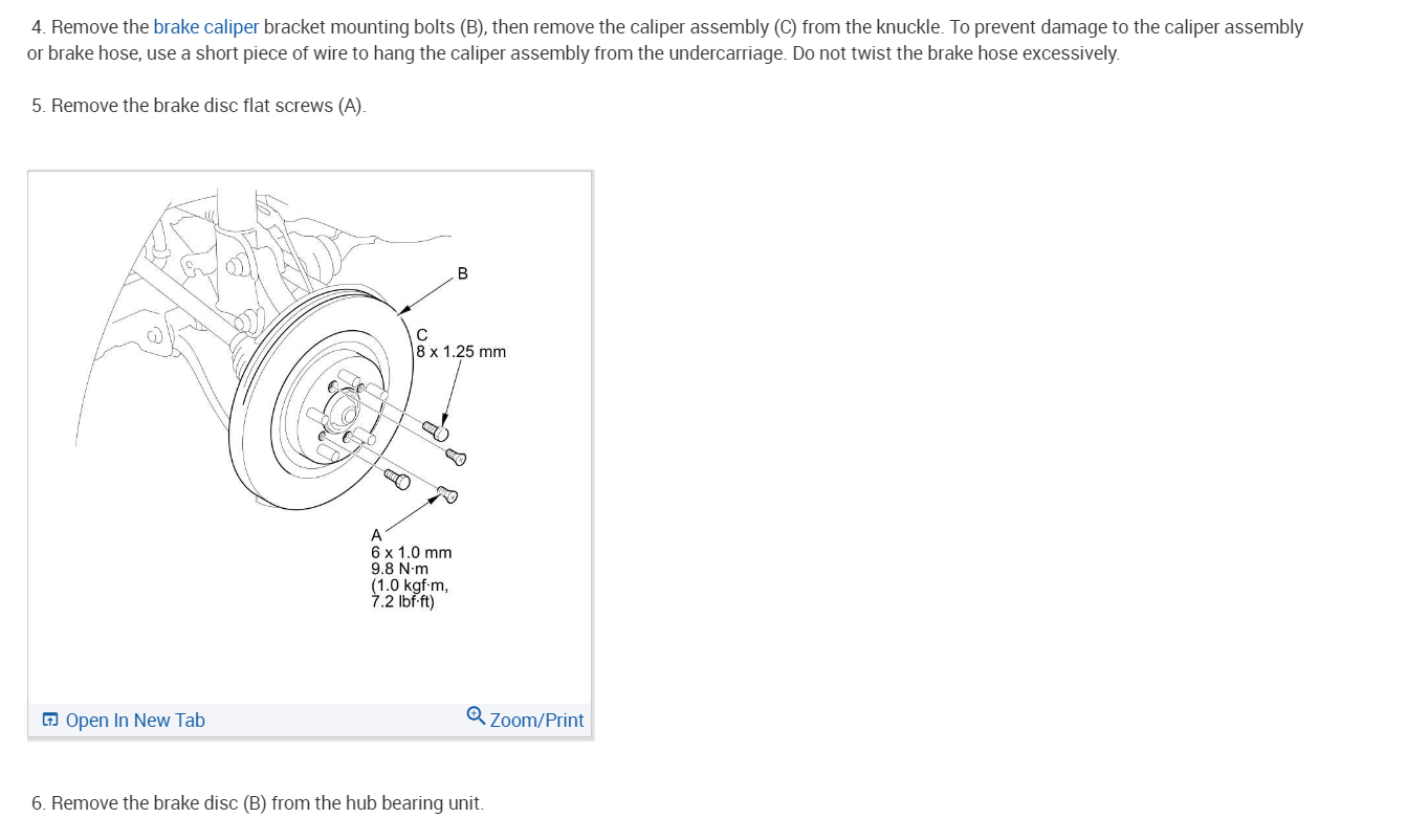

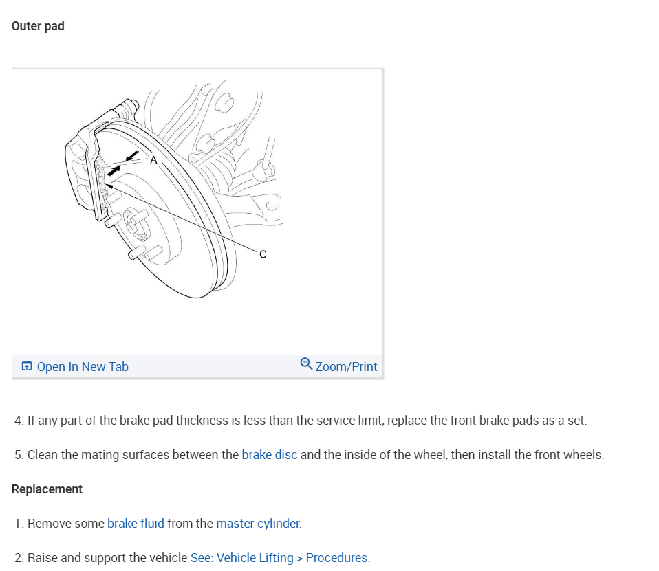

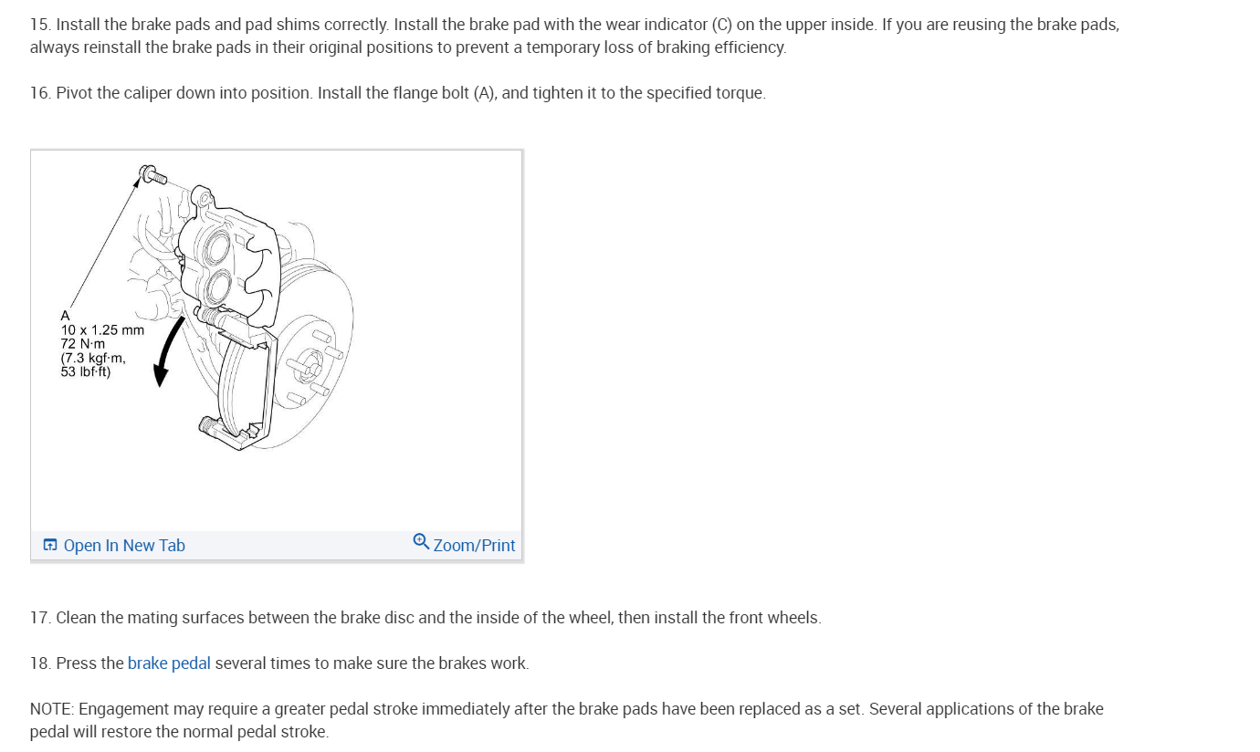

Brake parts prices are all over the map because of the variance in part quality. Here are factory prices which you should be able to get the parts for less, I have also included instructions on how to change out the brakes in case you want to do the job yourself in the images below.
Rotor 45251STXA00 - $138.70 each.
Front Pads 45022STXA00 $80.22 a set.
Labor 1.4 hrs @ shop labor rate
This video shows the job being done as well on a similar car:
https://youtu.be/-HDVldGwHTU
Check out the images (below). Please let us know if you need anything else to get the problem fixed.
