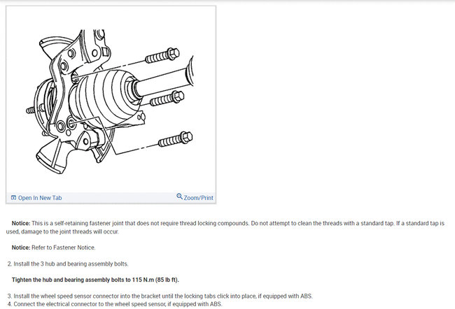

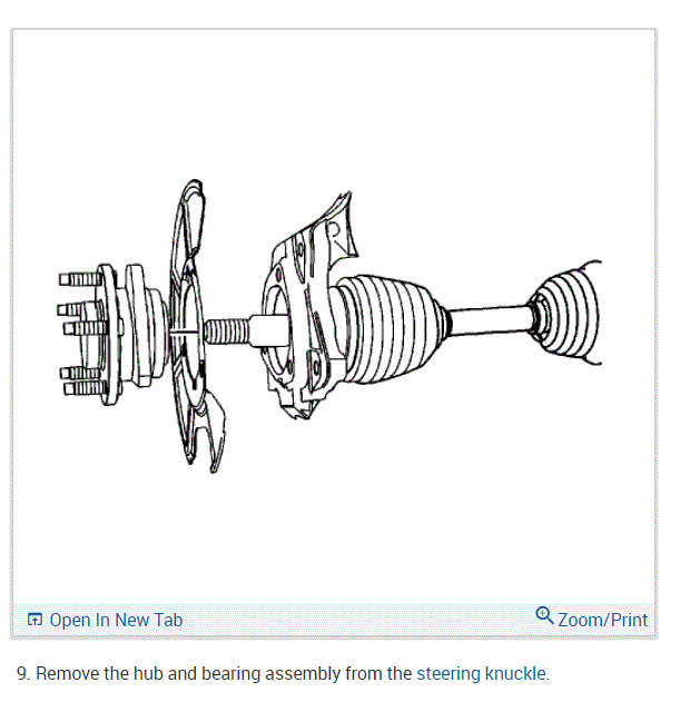

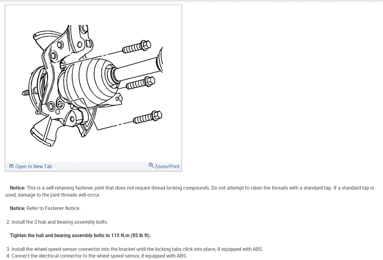

When stepping on the gas pedal the ABS brake lights come on and so I need a new right front wheel speed sensor can you help?
Oct 10, 2019 at 11:55 PM
  • 110,240 POSTS

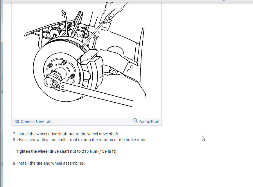

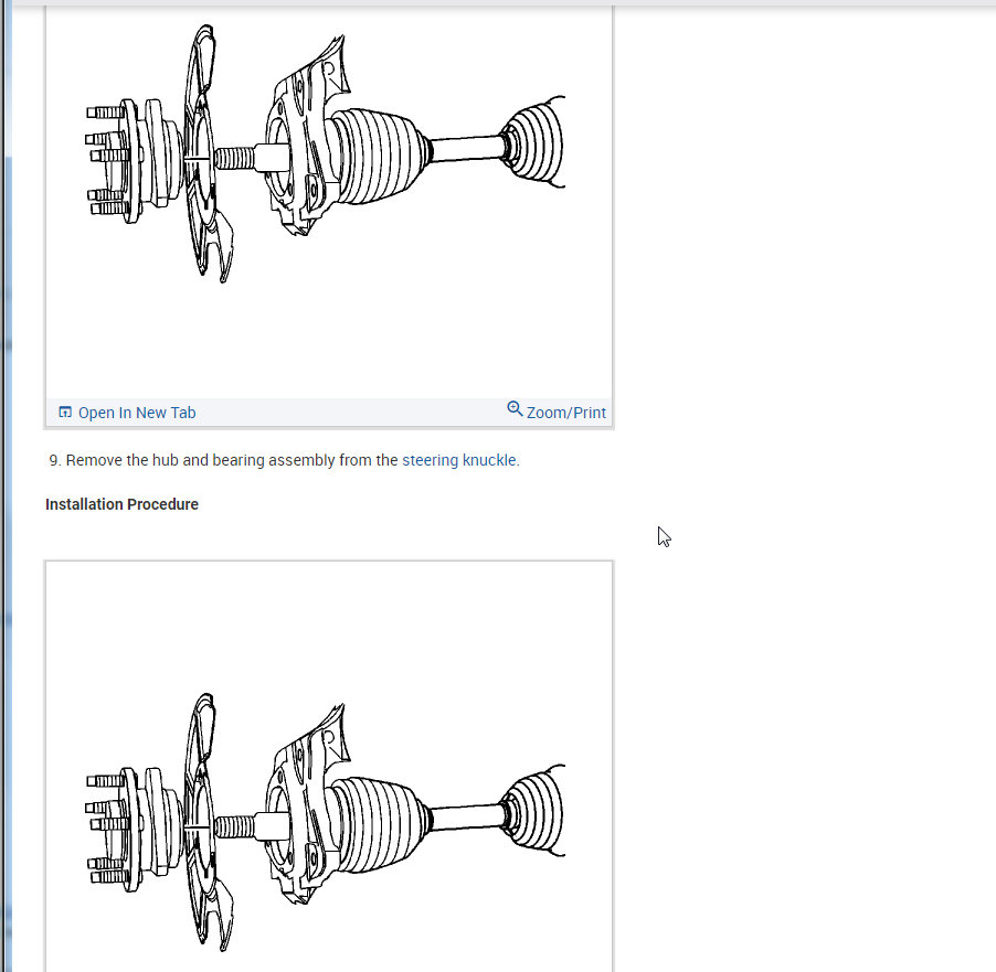

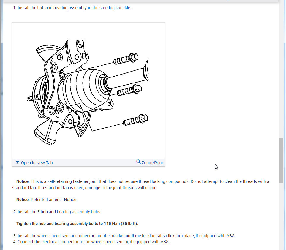

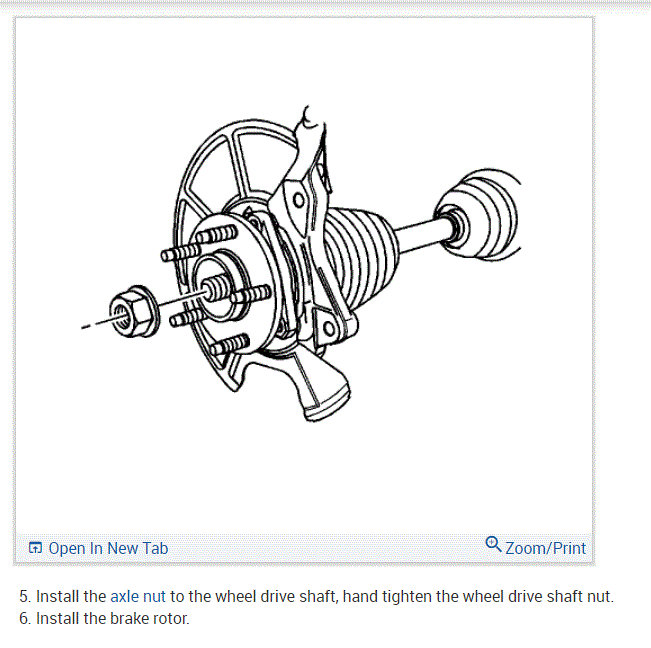

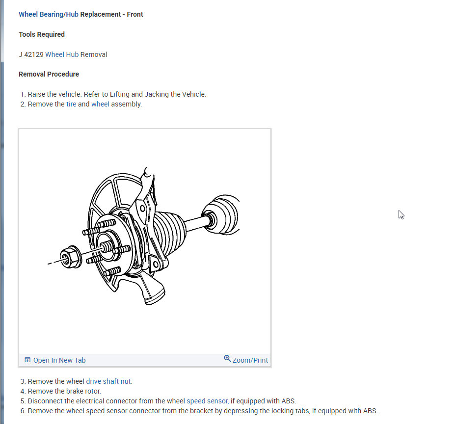

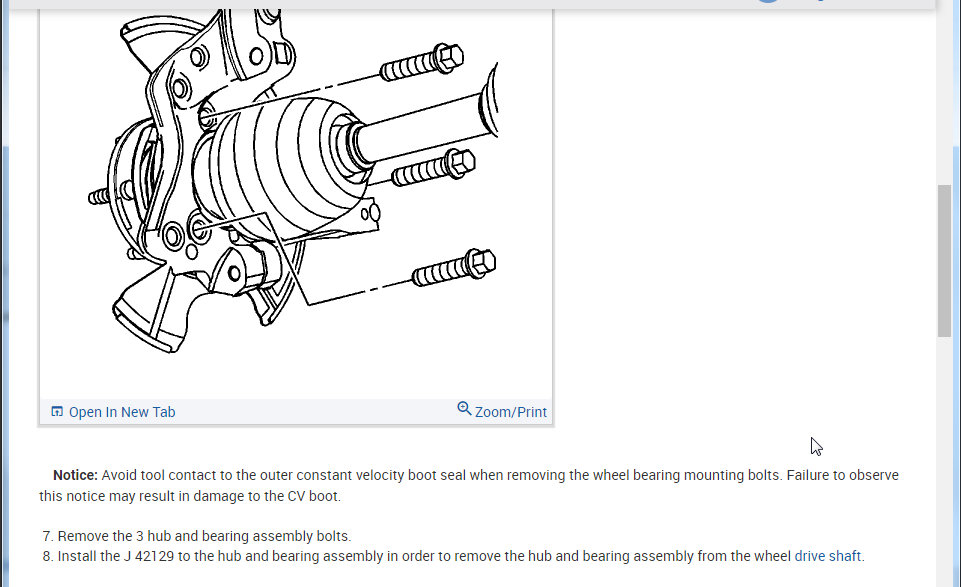

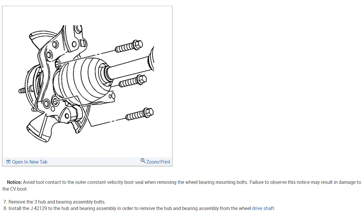

On this vehicle, the wheel speed sensor is integral to the hub bearing. Therefore, you need to replace the hub bearing.
If you look through this link, it shows in general how it is done. You can use this as a guide.
https://www.2carpros.com/articles/how-to-replace-an-abs-wheel-speed-sensor

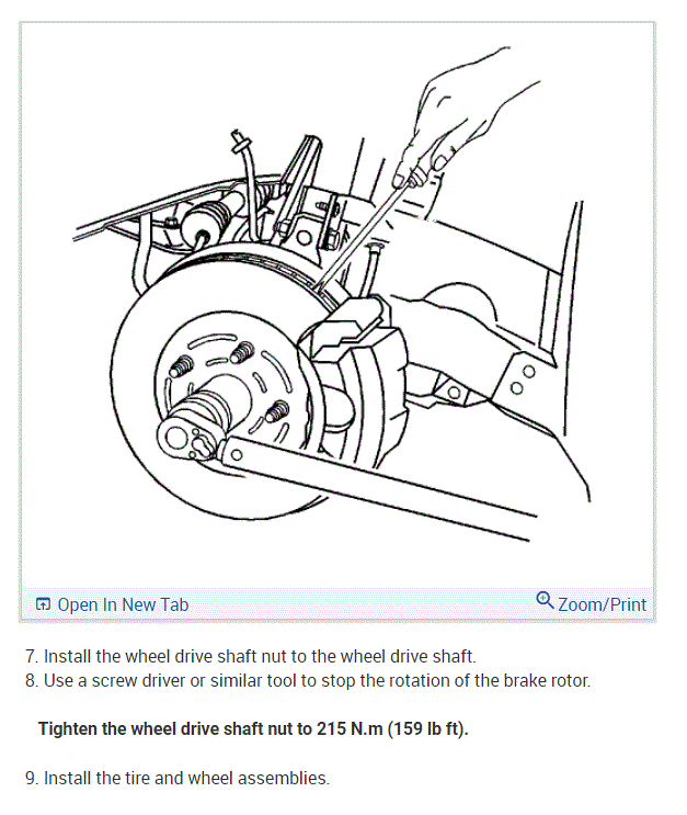

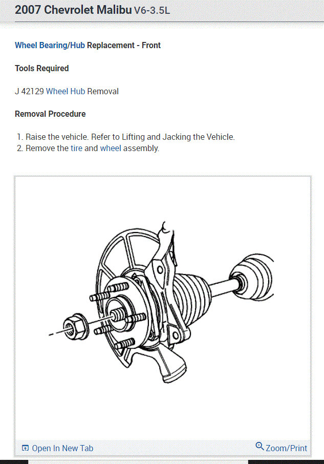

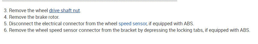

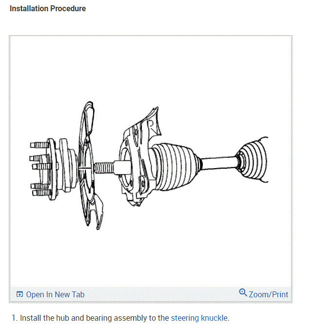

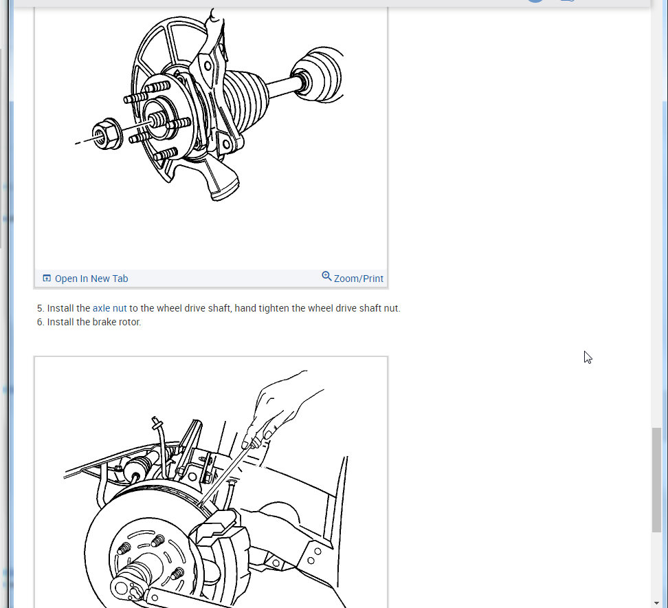

If you look at the pictures below, they include directions and pictures specific to your vehicle for hub bearing replacement.
Mar 26, 2021 at 12:14 PM
Here is a video that will help with this:
https://www.youtube.com/watch?v=ANWVTh2RQoQ
Below is the process from the manual on how to do this. Please run through this material and let us know if there are questions. Thanks
