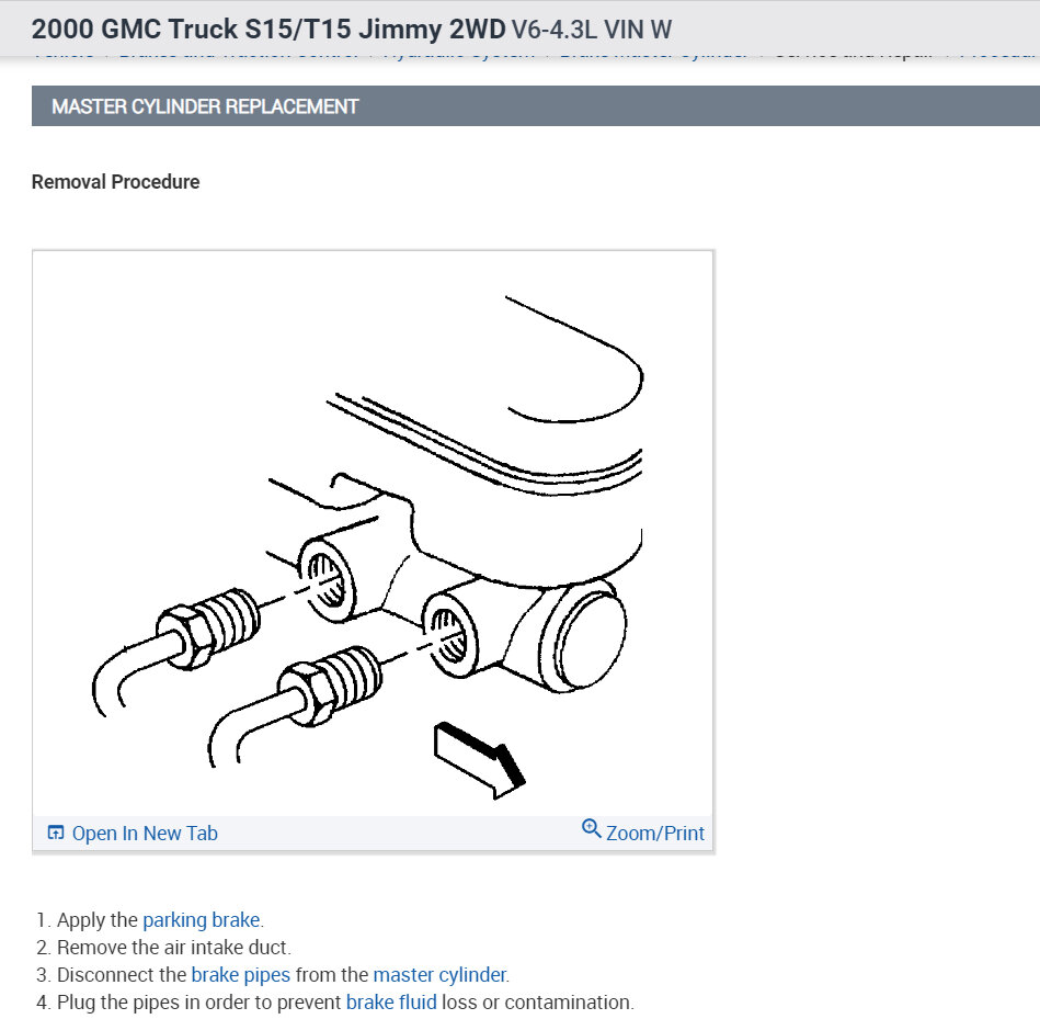

pedal went almost to the floor but stopped the truck. hissing sound in the cab so we changed the booster. pedal is now hard to push with little braking power and still a slight hiss. checked out the check valve seems to be okay.

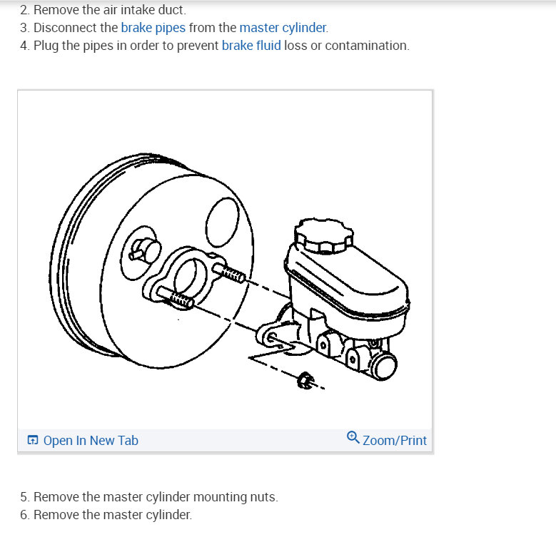

It sounds like the brake master cylinder went out here is how to replace the unit which must be bled before it is installed. Also, check the front and rear brake pads/shoes. Here is a guide and a video to help and the instructions on how to replace the master on your truck in the diagrams below:
https://youtu.be/WDxvEQrMkBg
and
https://www.2carpros.com/articles/how-to-replace-a-brake-master-cylinder
This guide may help as well:
https://www.2carpros.com/articles/brake-pedal-goes-to-the-floor

i bled the master cylinder and then bled the brakes. the pedal felt better but the brakes did not work.
