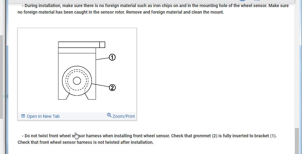

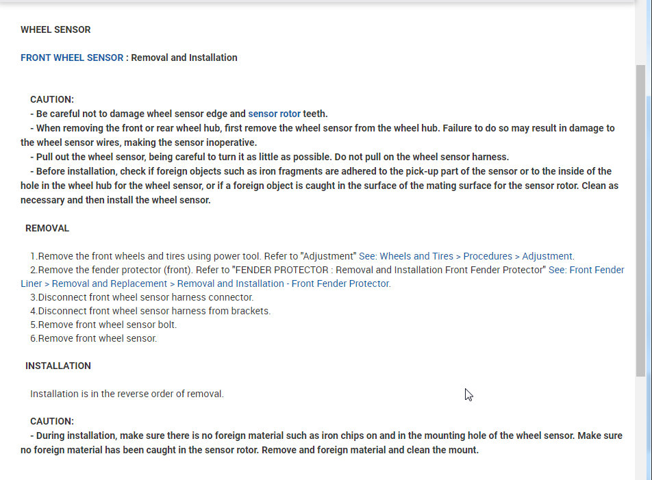

We recently had the brakes and rotors changed for the car listed above about two weeks ago and today the ABS light and traction lights came on suddenly. We need to know how to change the front ABS wheel sensor
Jul 10, 2017 at 5:39 AM
Here are a couple guide that will help with this issue and replacing the sensor:
https://www.2carpros.com/articles/abs-warning-light-on-easy-repair-guide
https://www.2carpros.com/articles/how-to-replace-an-abs-wheel-speed-sensor
Below you will find the process from the manual that will help with this as well.
Please let us know if you have other questions. Thanks
