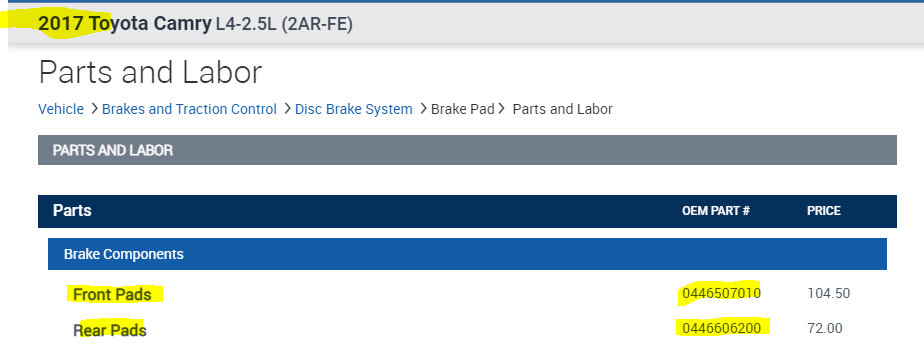

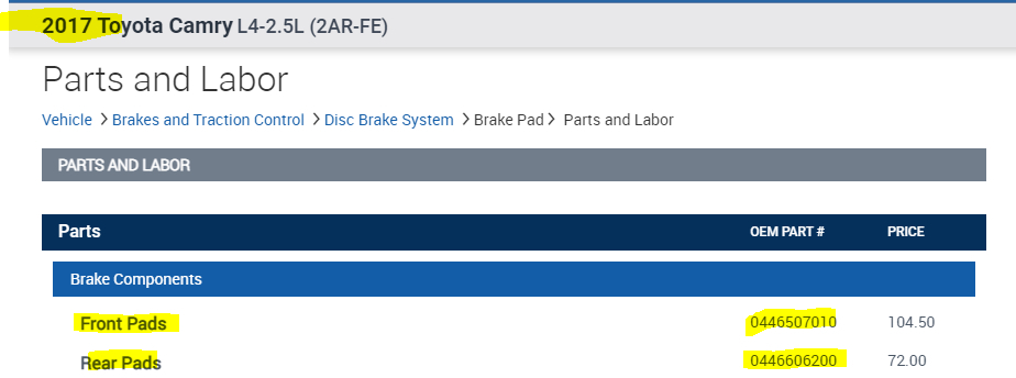

Will 2017 Camry brakes fit a 2018 Toyota Camry?
Mar 22, 2023 at 3:19 AM
  • 55,402 POSTS
Can you please give us more information? Front or rear brake? Here are the part numbers for the pads for the 2017
Front Pads 0446507010 $104.50
Rear Pads 0446606200 $72.00

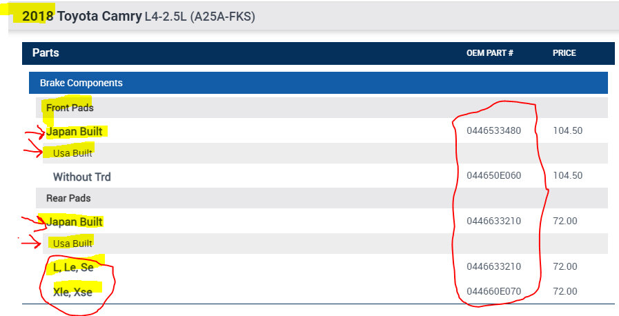

Here are the part numbers for the pads for the 2018
Front Pads Japan Built 0446533480 $104.50
Usa Built Without Trd 044650E060 $104.50
Rear Pads Japan Built 0446633210 $72.00
Usa Built L, Le, Se 0446633210 $72.00
Xle, Xse 044660E070 $72.00

There are several variables when it comes to the front pads on the 2018. However, none of the OEM part numbers match the 2017.
With that in mind, no they won't fit.
I attached the part numbers below for both model years. Keep in mind, when it comes to brakes, they aren't something to make a mistake with.
