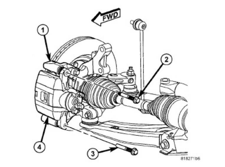

Just had it inspected I need to do the front brakes can you give me instructions please? Thank you in advance.
Jul 12, 2020 at 2:33 AM
Good morning,
I attached the procedure and some pictures below for you for the repair with a guide and a video of the job being done.

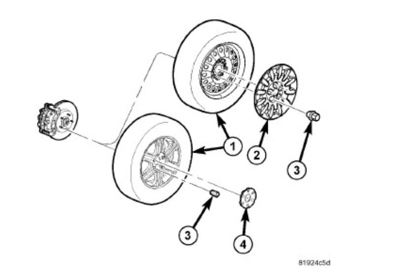

Remove the wheel mounting nuts (3), then the tire and wheel assembly (1).

When removing or installing a caliper guide pin bolt, it is necessary to hold the guide pin stationary while turning the bolt. Hold the guide pin stationary using a wrench placed upon the pin's hex-shaped head.

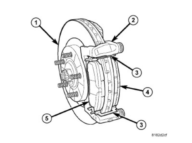

Remove the two brake caliper guide pin bolts (2, 3).
Remove the disc brake caliper (4) from the disc brake adapter bracket (1) and hang it out of the way using wire or a bungee cord. Use care not to overextend the brake hose when doing this.
Remove the brake pads (4, 5) from the caliper adapter bracket (2).

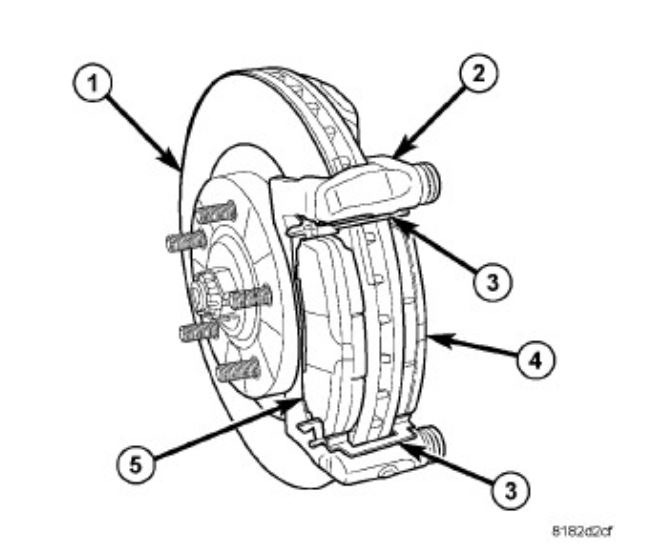

Place the brake pads (4, 5) in the abutment shims (3) clipped into the disc brake caliper adapter bracket (2) as shown. Place the pad with the wear indicator (if equipped) attached on the inboard side (2).
Completely retract the caliper piston back into the bore of the caliper.
CAUTION:
Use care when installing the caliper (4) onto the adapter bracket (1) to avoid damaging the boots.
Install the disc brake caliper over the brake pads on the brake caliper adapter bracket.
CAUTION:
Align the caliper guide pin bolt holes with the adapter bracket. Install the upper (2) and lower (3) caliper guide pin bolts. Tighten the guide pin bolts to 35 N·m (26 ft. lbs.).
Install tire and wheel assembly (1) (Refer to 22 - Tires and Wheels - Installation) . Install and tighten wheel mounting nuts (3) to 135 N·m (100 ft. lbs.).
