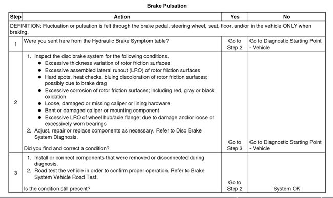

so my car works fine, but i noticed that when i get into my car and try to reverse i will hold the brake and shift into reverse then slowly let the brake goes but i hear this kind of air pressure in the brake then i cannot brake (stop) the car from reversing. i have to push really really hard and it barely slows the car down, luckily it is always out of my driveway or after hours out of work, but then even at that after i switch gears to drive i notice that it goes on its own, like i don't push the gas and it accelerates a little bit. it worries me and no ABS lights or brakes lights are on my dashboard. Help!

with this problem my brake doesn't go all the way to the floor. actually is the opposite problem, doesn't even want to be pressed at all. it like it gets stuck, kind of like when you pump a basketball with air from a pump and you can feel the resistance the pump wants to give. that is the best way i can describe it.

Is the brake malfunction indicator or the malfunction indicator lamp[MIL]or "check engine" light illuminated?

no lights are on other than the low tire pressure.

Hello again,
Would you call this brake pulsation? In the diagrams down below I have included the diagnostic troubleshooting guide from the vehicle manufacturer for brake pulsation for your vehicle. Please go through this guide, if warranted, and get back to us with what you find out.
