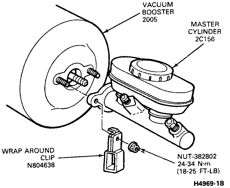

I have recently replaced both front calipers, master cylinder, and brake booster. I have bled all the brakes and I'm still losing brakes. I can pump the pedal and get brakes but after a few seconds the pedal goes to the floor again. I'm beyond stumped. Can anyone help please.

Here are the directions specific to bleeding the system on your truck. Follow them and see if it makes a difference. It includes bleeding the rear ABS valve.

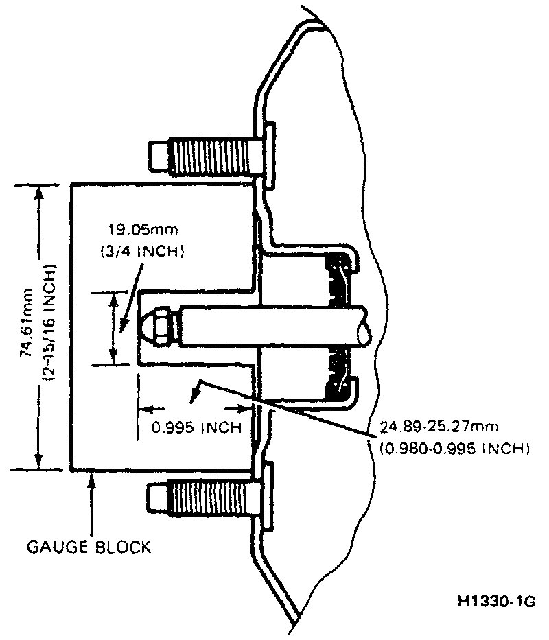

Before bleeding, review the second set of directions to confirm you have the push rod properly adjusted. Pictures 1 and 2 correlate with this.

INSTALLATION
Bendix Booster Push Rod Gauge Dimensions and Adjustment
1. Before installing the master cylinder, check the distance from the outer end of the booster assembly push rod, to the front face of the brake booster assembly. Turn the push rod adjusting screw in or out as required to obtain the specified length.
2. Position the master cylinder assembly over the booster push rod and onto the two studs on the booster assembly. Install the attaching nuts and tighten to 24-34 Nm (18-25 ft lbs).
3. Connect the hydraulic brake system lines to the master cylinder.
4. Connect fluid level indicator switch.
5. Bleed the master cylinder. Fill the reservoir of the master cylinder with heavy duty DOT 3 brake fluid to the fluid fill line. Install gasket and bleed the system. Refer to Brake Bleeding.
______________________
Once you do that, let me know what happens. If there are no leaks, the rubber brake hoses aren't expanding, the push rod is properly adjusted, and the rear brakes are properly adjusted, I have a feeling you got a bad master cylinder.
Let me know if this helps.
