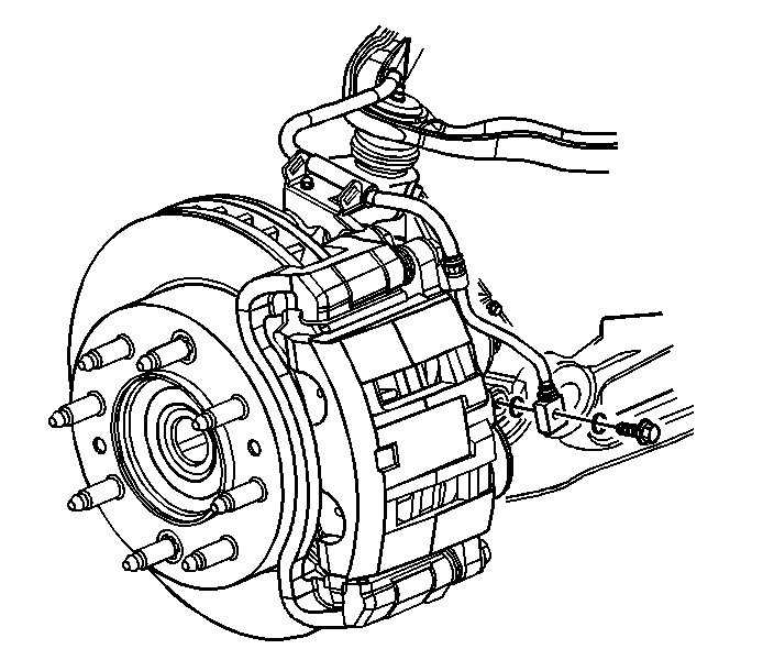

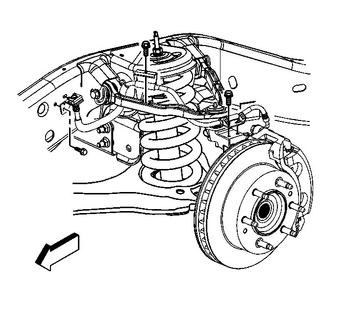

I need you to try something. Lift one of the front wheels from the ground safely. Turn the wheel. If it turns, have a helper apply the brakes so it locks up again. When the brake is released and the wheel won't turn, open the bleeder on the brake caliper.
If that releases the wheel, chances are the rubber brake hose has failed. They can break down internally and not allow pressure to release.
Let me know if this is something that has happened all at once or if there has been problems.
______________________________
Here are directions for replacement of the hose I'm referring to. The attached pictures correlate with the directions.

brake hose
164
Community 1 Create Quote
2006 GMC Truck Sierra 1500 2WD V8-5.3L VIN B HO
Brake Hose Replacement - Front
Vehicle Brakes and Traction Control Hydraulic System Brake Hose/Line Service and Repair Procedures Brake Hose Replacement - Front
BRAKE HOSE REPLACEMENT - FRONT
Removal Procedure
Caution: Refer to Brake Fluid Irritant Caution in Service Precautions.
Notice: Refer to Brake Fluid Effects on Paint and Electrical Components Notice in Service Precautions.
1. Raise and suitably support the vehicle.
2. Remove the tire and wheel assembly.
3. Clean all dirt and foreign material from the brake hose and brake pipe fittings.
pic 1
4. Important: Install a rubber cap or plug to the exposed brake pipe fitting ends in order to prevent brake fluid loss and contamination.
Use a backup wrench on the hose fitting, disconnect the brake pipe fitting from the brake hose, then cap or plug the brake pipe fitting end.
5. Remove the brake hose retaining clip from the hose mounting bracket.
6. Remove the brake hose bolt and the bracket from the upper control arm.
7. Remove the brake hose bolt and the bracket from the steering knuckle.
pic 2
8. Remove the brake hose to caliper bolt from the brake caliper.
9. Remove the brake hose from the brake caliper.
10. Remove and discard the 2 copper brake hose gaskets. These gaskets may be stuck to the brake caliper housing or the brake hose end.
