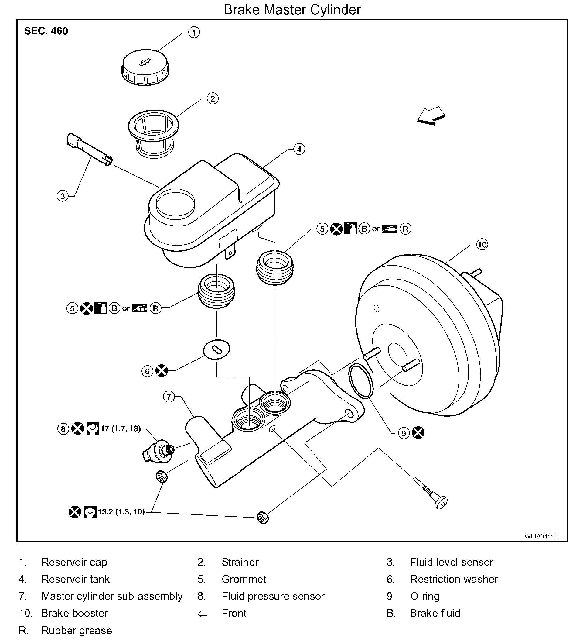

I changed my brake pads and now my brake pedal goes to the floor. the brakes worked fine before I change them. I don't know if it caused the problem when I press the caliper piston back in or not.

If the brake pedal is going to the floor and there are no leaks and you didn't open the system allowing air into the system, chances are the master cylinder was damaged. I have actually seen the plungers damaged in the master cylinder from fluid being forced the wrong direction.
As far as pushing the caliper pistons back, you had to do it. Years ago I was taught to open the bleeder on the caliper when depressing the piston to prevent damage such as this and to remove dirt in the caliper.
If you have no brake pedal and there are no leaks or air in the system, replace the MC.
Here are a few links to help:
https://www.2carpros.com/articles/brake-pedal-goes-to-the-floor
https://www.2carpros.com/articles/how-to-replace-a-brake-master-cylinder
Here are the directions specific to your vehicle. The attached pic correlates with the directions.

Vehicle Brakes and Traction Control Hydraulic System Brake Master Cylinder Service and Repair Removal and Replacement
REMOVAL AND REPLACEMENT
Removal and Installation
BR-20 COMPONENTS
Pic 1
CAUTION: Be careful not to splash brake fluid on painted areas; it may cause paint damage. If brake fluid is splashed on painted areas, wash it away with water immediately.
REMOVAL
1. Drain brake fluid.
2. Disconnect harness connectors for fluid level sensor and pressure sensor.
3. Disconnect brake tube from master cylinder assembly.
4. Remove master cylinder assembly nuts and master cylinder assembly.
INSTALLATION
^ Installation is in the reverse order of removal.
^ Refill brake fluid and bleed air.
