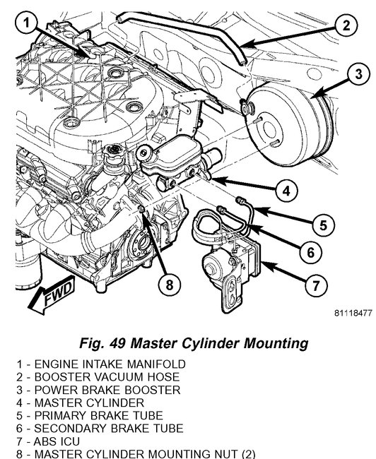

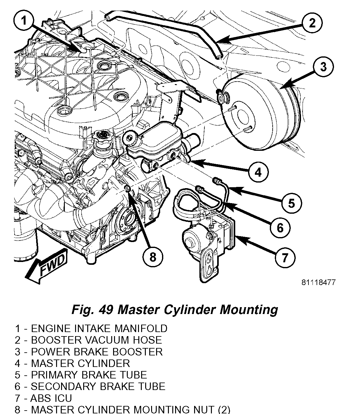

Okay, so first off there is no leaking brake fluid and the reservoir is full. my car started pulling to passenger side when braking then pedal starting going farther to floor. I would have brakes here and there it was a hit or miss sometimes the pedal would get hard and most times just went to the floor. I’ve had them bled twice now both times passenger front and driver rear were the only ones that didn’t bled other two bleed fine but still same problem brakes would come and go. I’ve been told so many things I’m not sure and I don’t have a ton of money to keep fixing everything. people say they think the problem is I’m a single mom and cars are expensive. But yesterday my brakes went completely out, there is nothing not even pumping them. I safely got it home which I hope I didn’t ruin transmission but I had my kids with me. I started it this morning there is still no brakes and pedal goes to floor all the way and no leaks and reservoir still full.. what do you think the problem could be? I have been told by different people different things, master cylinder, air in line, clogged hose or bleeder, brake booster, a hose that got crashed together, few others I can’t think of at this moment. I just need to know what direction to go because parts are expensive and labor is even more expensive. Time for this single mom to go to college for mechanic for the knowledge which then I can work on my own vehicle. but until then could you pretty please help? in desperate need. Thank you so much..

The system is sealed, so since the problem started before repairs, chances are it isn't air. Since there are no leaks and the reservoir stays full, my first suspect is the master cylinder. Take a look through this link and see if it mirrors what you are experiencing.
https://www.2carpros.com/articles/brake-pedal-goes-to-the-floor
I suspect that is the issue. Here is a link that shows in general how one is replaced:
https://www.2carpros.com/articles/how-to-replace-a-brake-master-cylinder

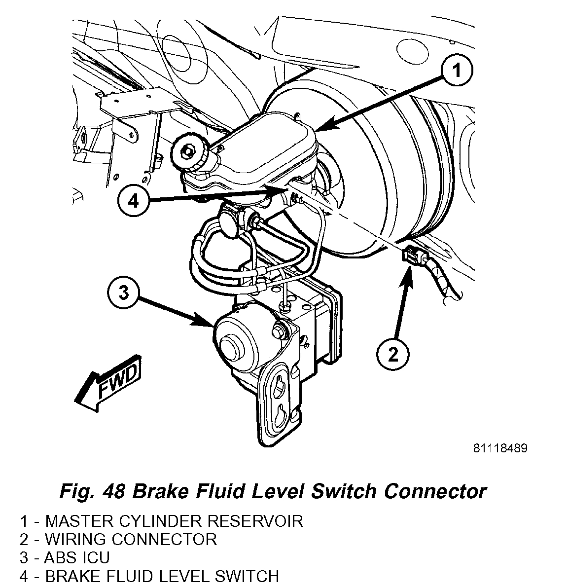

4) Disconnect wiring harness connector from brake fluid level switch in master cylinder brake fluid reservoir (Fig. 48).
5) Disconnect primary and secondary brake tubes from master cylinder (Fig. 49). Install sealing plugs in open brake tube outlet ports.

7) Remove two nuts attaching master cylinder to power brake booster (Fig. 49).

3) Position master cylinder on studs of power brake booster (Fig. 49), aligning booster push rod with master cylinder piston.
4) Install two master cylinder mounting nuts (Fig. 49). Tighten both mounting nuts to a torque of 25 Nm (225 inch lbs.).
CAUTION: When tightening primary and secondary brake tube nuts at master cylinder, be sure brake tubes do not contact any other components within vehicle and that there is slack in flexible sections of tubes. This is required due to movement between ABS ICU and master cylinder while vehicle is in motion.
5) Thread primary and secondary brake tubes into master cylinder primary and secondary ports (Fig. 49). Brake tubes must be held securely when tightened to control orientation of flex section. Tighten tube nuts to 14 Nm (120 inch lbs.) torque.
6) Connect wiring harness connector to brake fluid level switch mounted in brake fluid reservoir (Fig. 48).

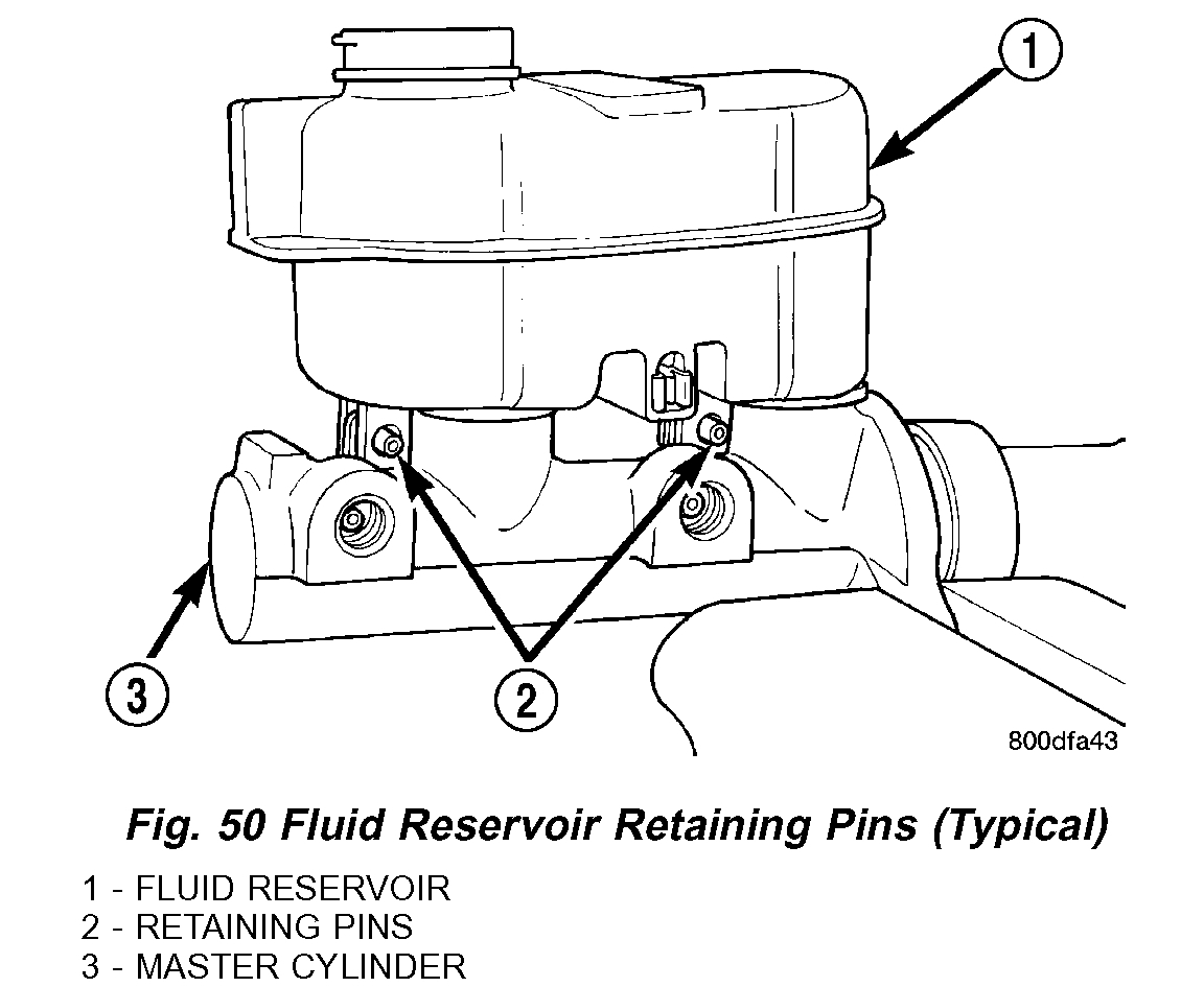

5) Using correct size pin punch, remove the two retaining pins between the fluid reservoir and master cylinder housing (Fig. 50).
6) Rock the brake fluid reservoir from side to side while pulling up to remove it from the seal grommets in master cylinder housing.
pic 4

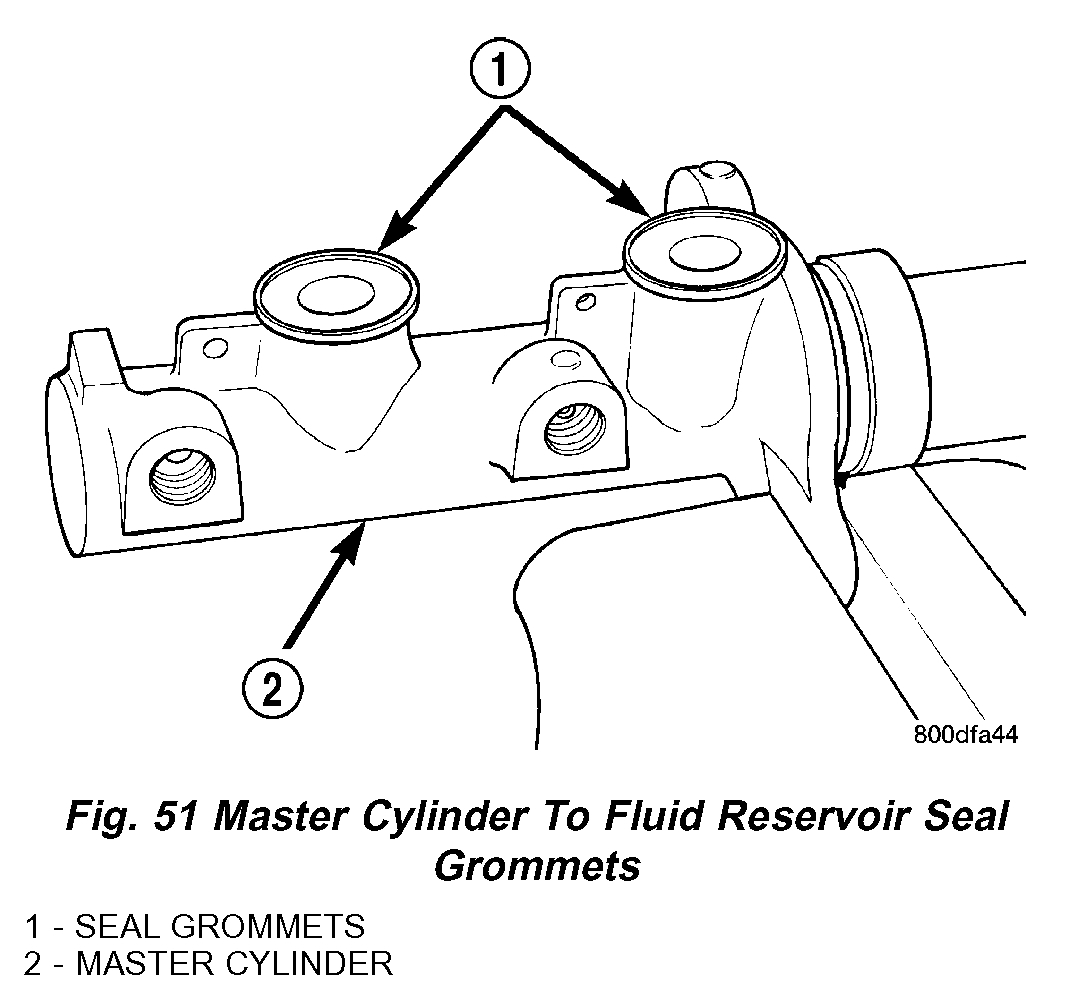

7) Remove the two master cylinder housing to brake fluid reservoir seal grommets (Fig. 51).

1) Install new master cylinder housing to brake fluid reservoir sealing grommets in master cylinder housing (Fig. 51).
2) Lubricate reservoir mounting area with fresh clean brake fluid. Place reservoir in position over sealing grommets. Seat reservoir into sealing grommets using a rocking motion while firmly pressing down on fluid reservoir.
3) Be sure fluid reservoir is positioned properly on master cylinder. Bottom of fluid reservoir is to be touching the top of both sealing grommets when properly installed on master cylinder housing.
