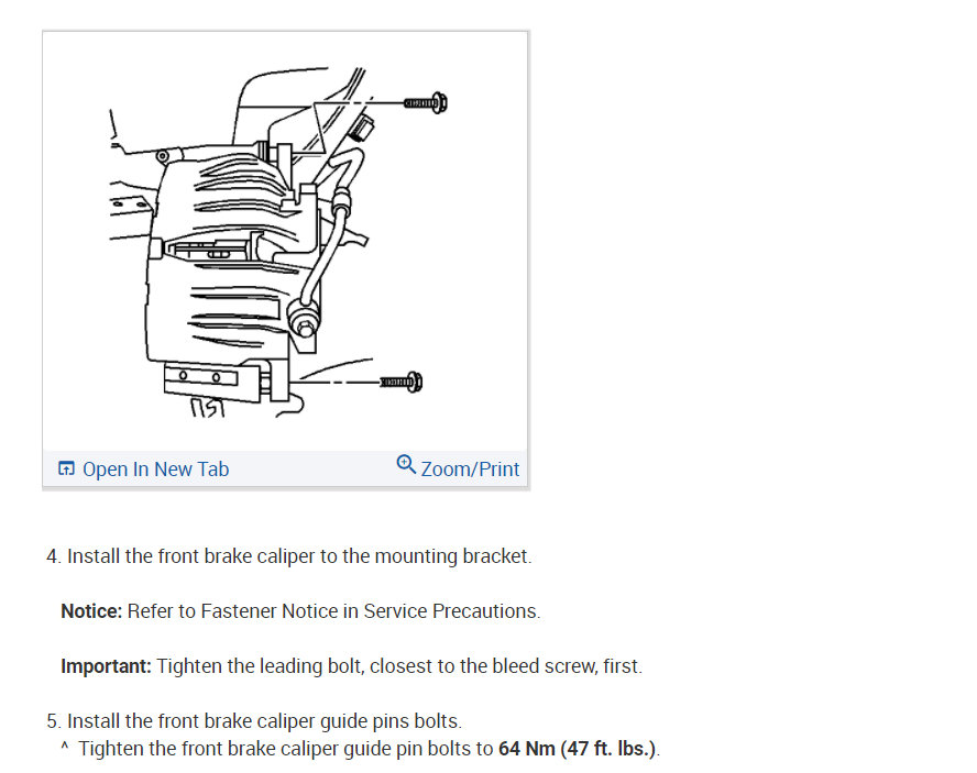

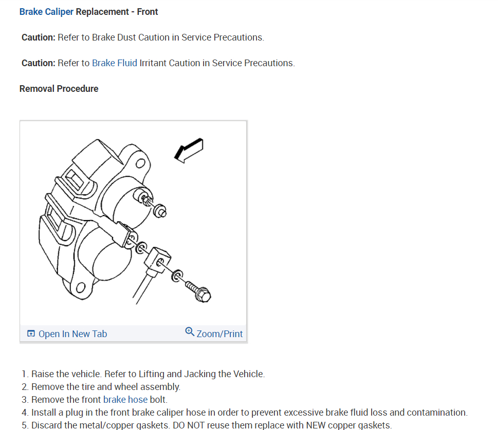

The front brake calipers only the top pistons are pushing out the brake lines have been replaced. The front left brake calipers replaced. Still the same result only the top two pistons move when the brakes are applied. They were bled properly I started from the right rear went to the left rear front right front left. I have plenty of brake pedal, no sponginess, doesn't stick. Just the pistons won't move together on either side and as I said the front left driver side is brand new.
May 11, 2021 at 9:55 PM
Good morning,

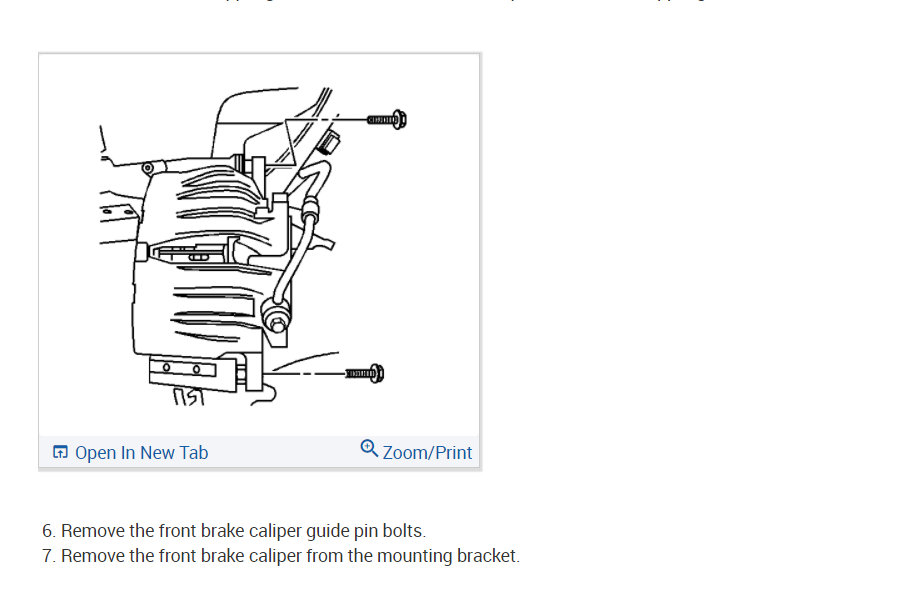

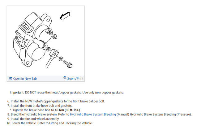

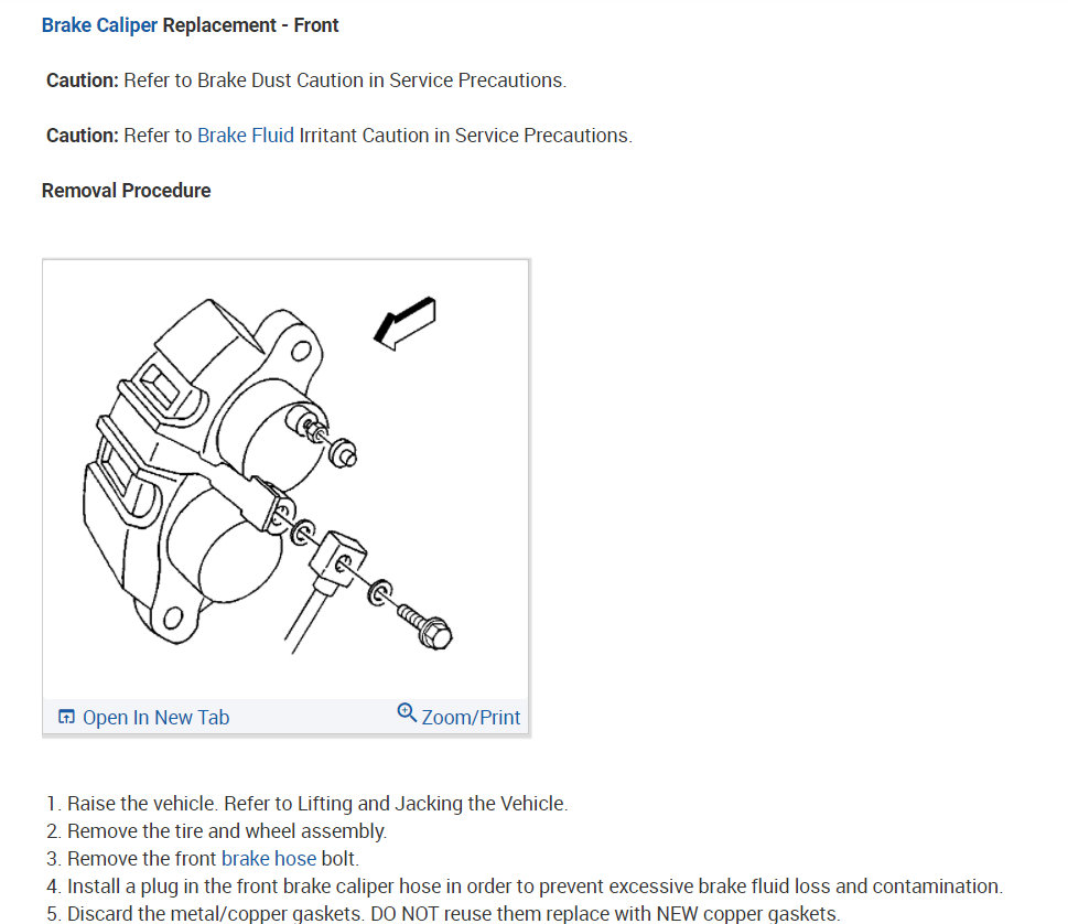

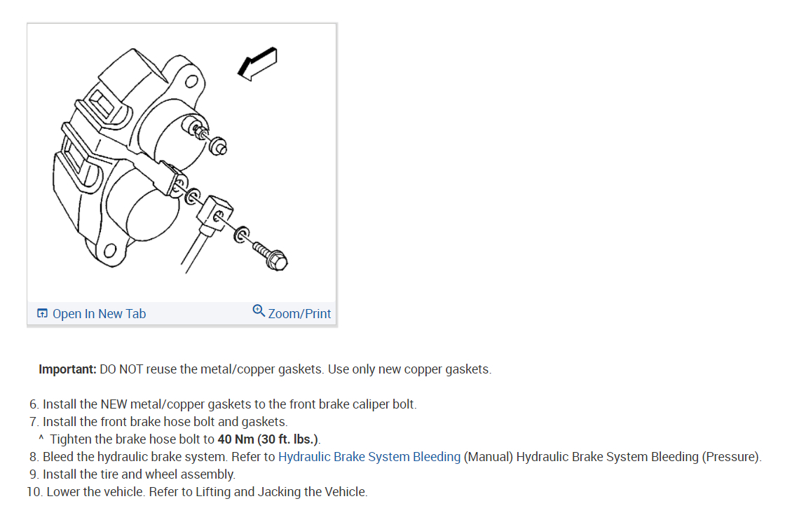

I attached the procedure for you for replacing the calipers. Both pistons should move together. If only 1 piston moves, then the other is seized.
https://www.2carpros.com/articles/brake-caliper-replacement
Make sure you flush the system of all fluid and replace it with new fluid.
https://www.2carpros.com/articles/how-to-bleed-or-flush-a-car-brake-system

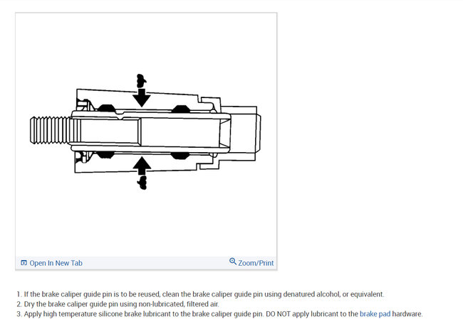

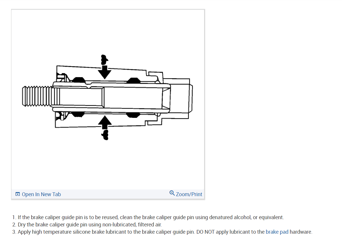

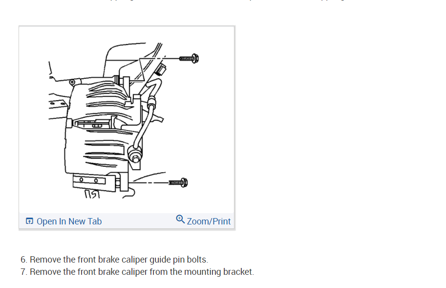

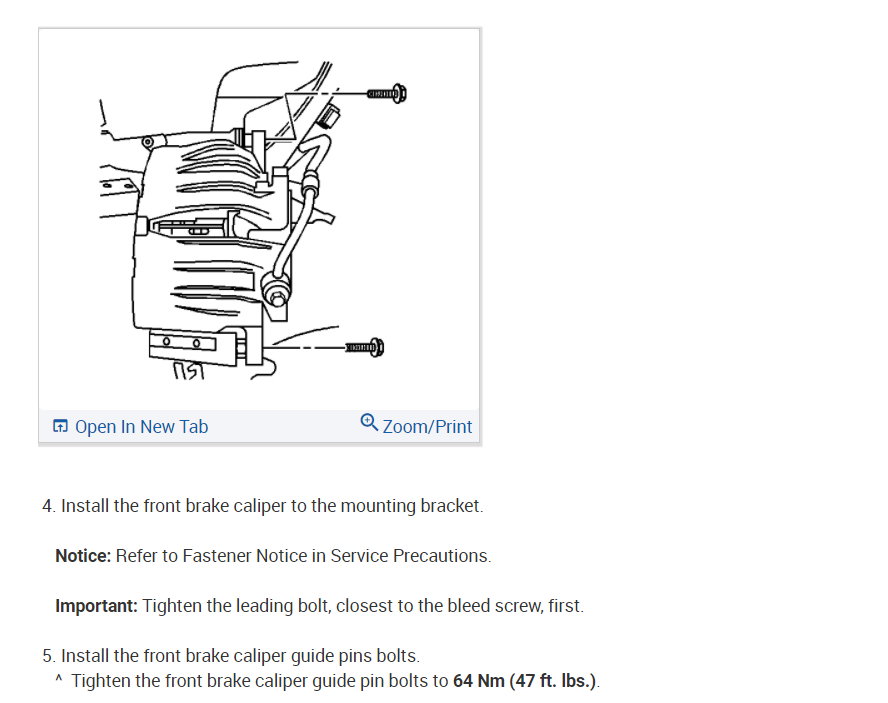

Okay, did you use or clean the slider pins that are identified in the illustrations I posted?
If the slider is seized or dirty, one of the pistons will not move.
