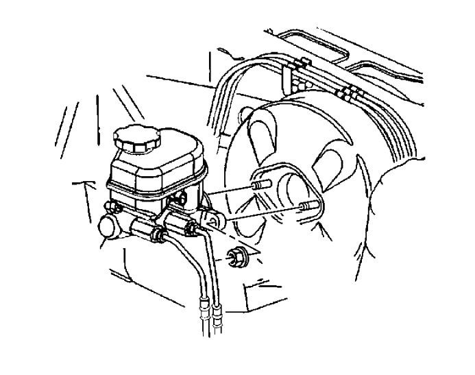

The brakes were fine making no noise. Next thing is all of a sudden they went to the floor. Checked the doesn't seem to be leaking. Drove it a couple times with the brakes like that as I have no money for repair. Any suggestions? Thanks
Mar 13, 2020 at 12:26 AM
Good afternoon,
I would not drive the car without brakes.

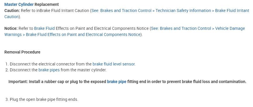

This could be a master cylinder but needs to be verified.
https://www.2carpros.com/articles/brake-pedal-goes-to-the-floor
https://www.2carpros.com/articles/how-to-replace-a-brake-master-cylinder
https://www.2carpros.com/articles/how-to-bleed-or-flush-a-car-brake-system
