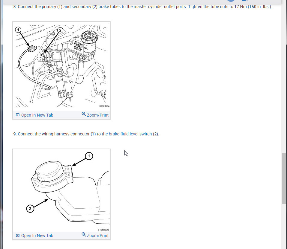

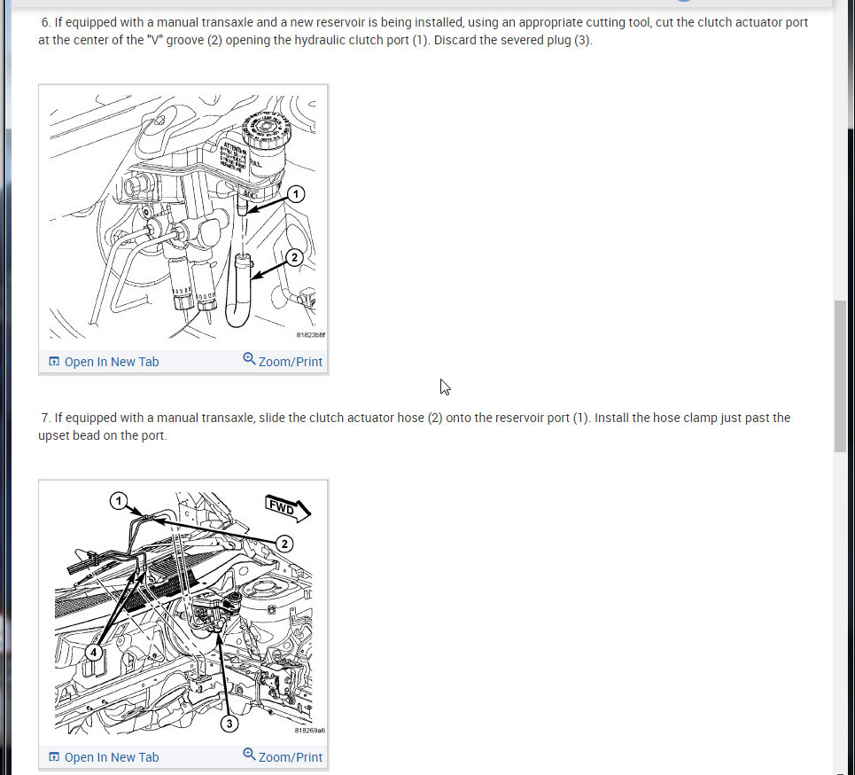

While pressing brake pedal if you hit bump or pot hole or loose gravel the brake pedal will sometimes lose pressure and drop to the floor. after about 3 to 5 days it will start acting normal. They tell me I need a new brake master please help.

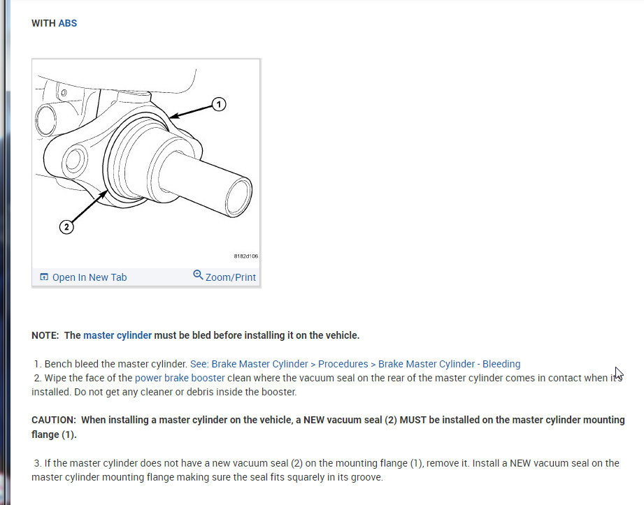

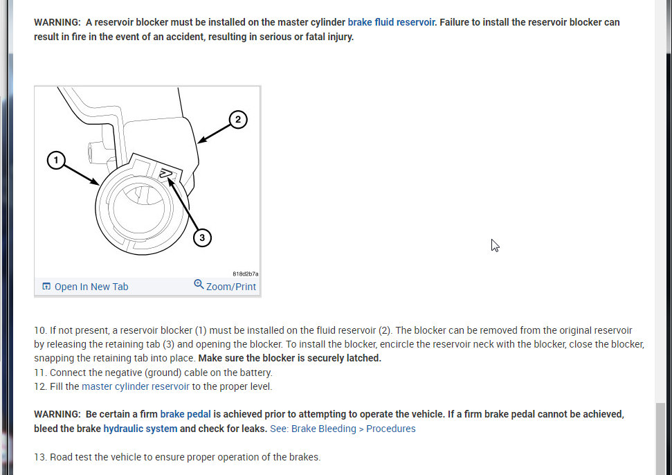

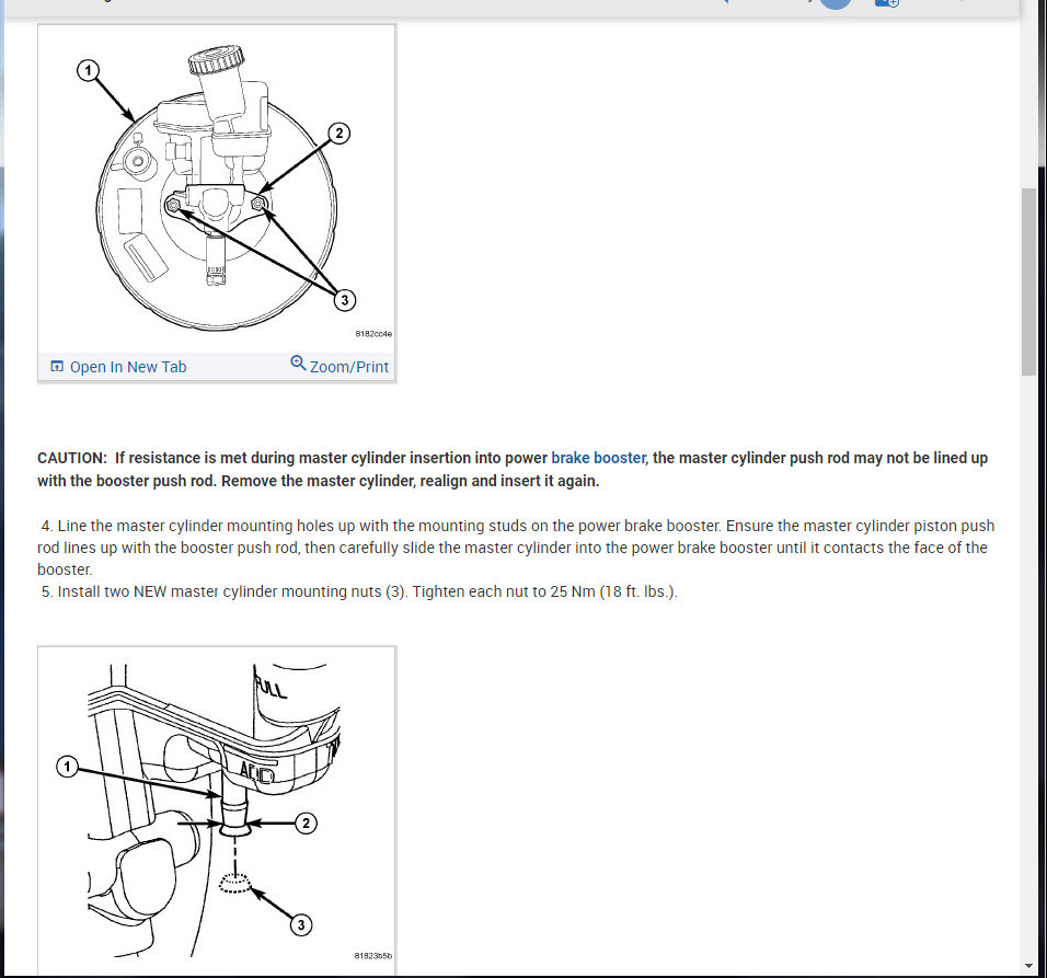

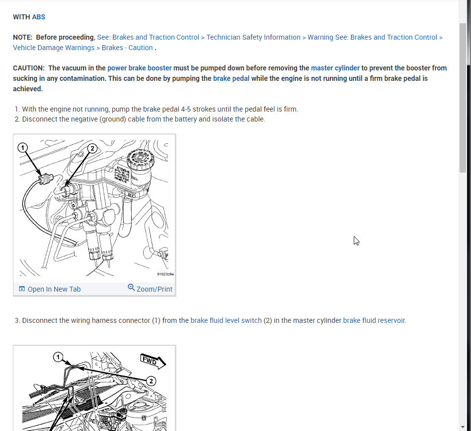

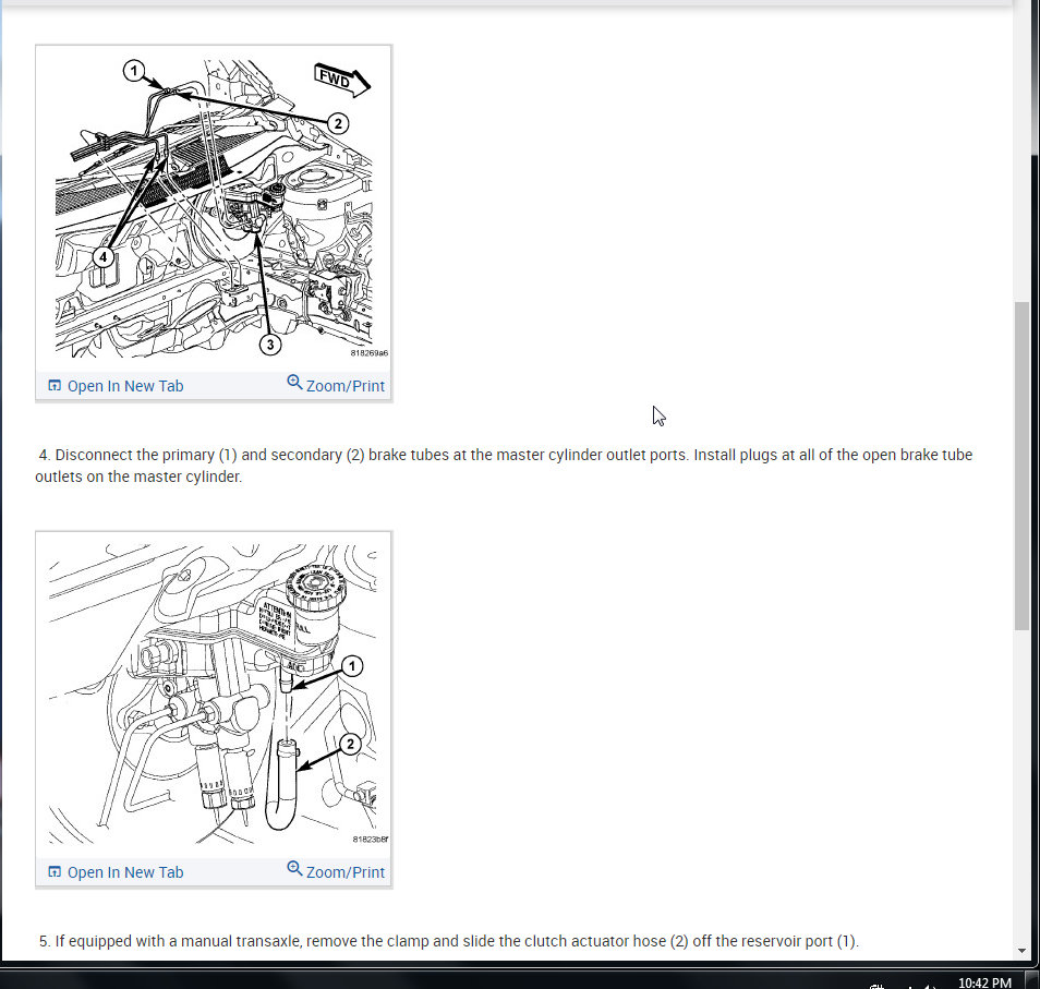

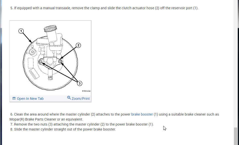

I attached the process below from the manual on how to replace this. Please let us know if you have other questions. Thanks
