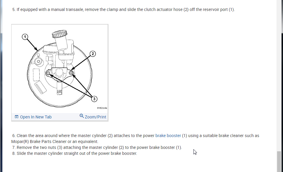

hit bump or pot hole or loose gravel the brake pedal will sometimes lose pressure and drop to the floor
2010 DODGE CALIBER
137,000 MILES • 2.0L • 4 CYL • 2WD • AUTOMATIC
CADILLAC911
While pressing brake pedal if you hit bump or pot hole or loose gravel the brake pedal will sometimes lose pressure and drop to the floor. after about 3 to 5 days it will start acting normal. They tell me I need a new brake master please help.
Jan 4, 2020 at 6:47 AM
Here are some guides that will help with this:
https://www.2carpros.com/articles/brake-pedal-goes-to-the-floor
https://www.2carpros.com/articles/how-to-replace-a-brake-master-cylinder

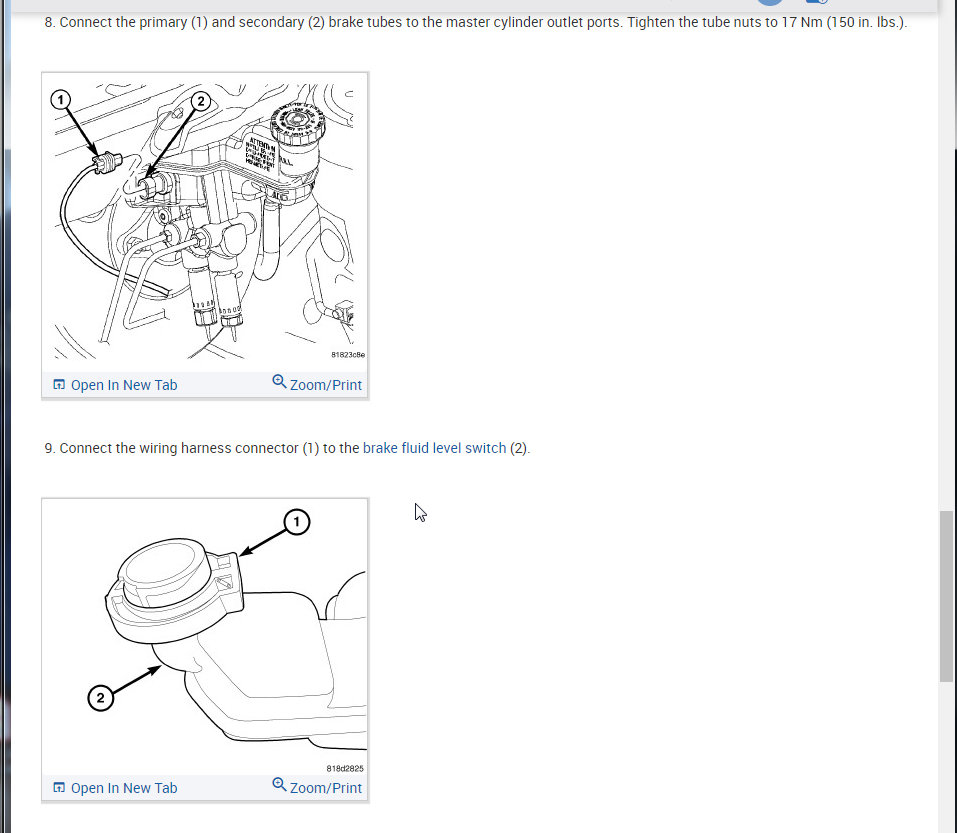

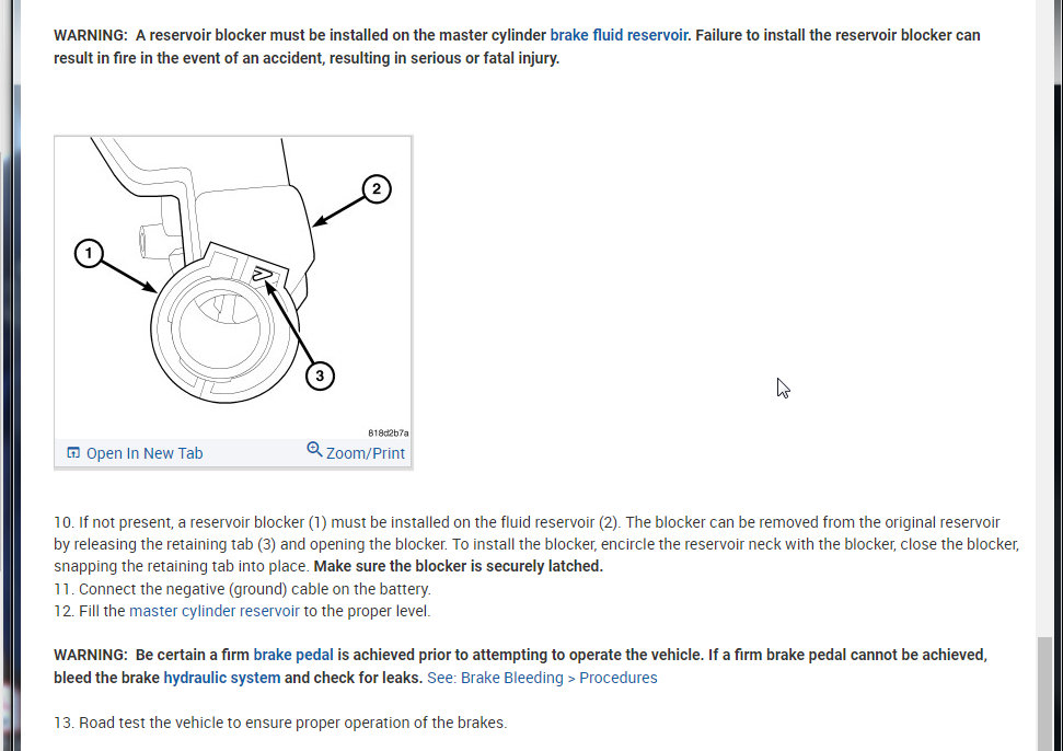

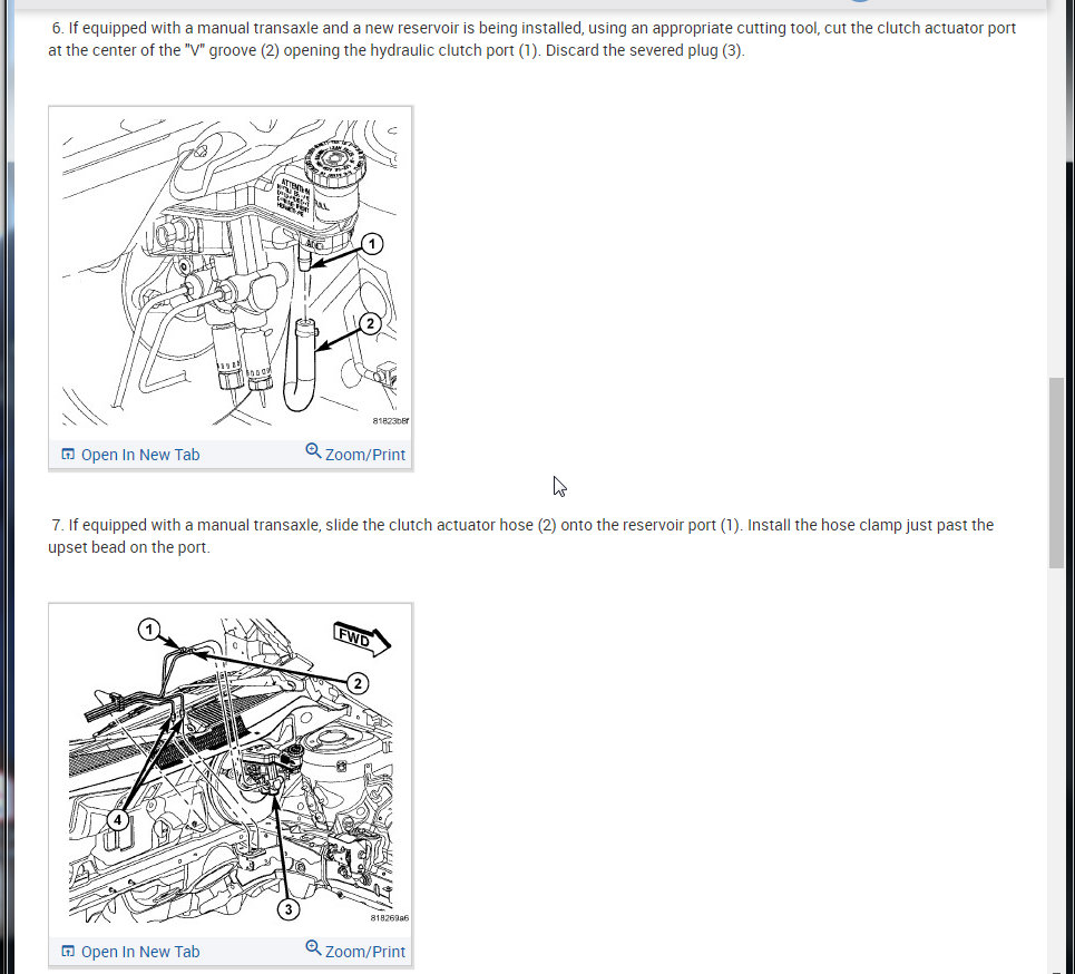

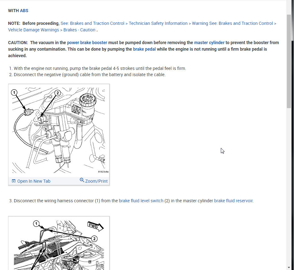

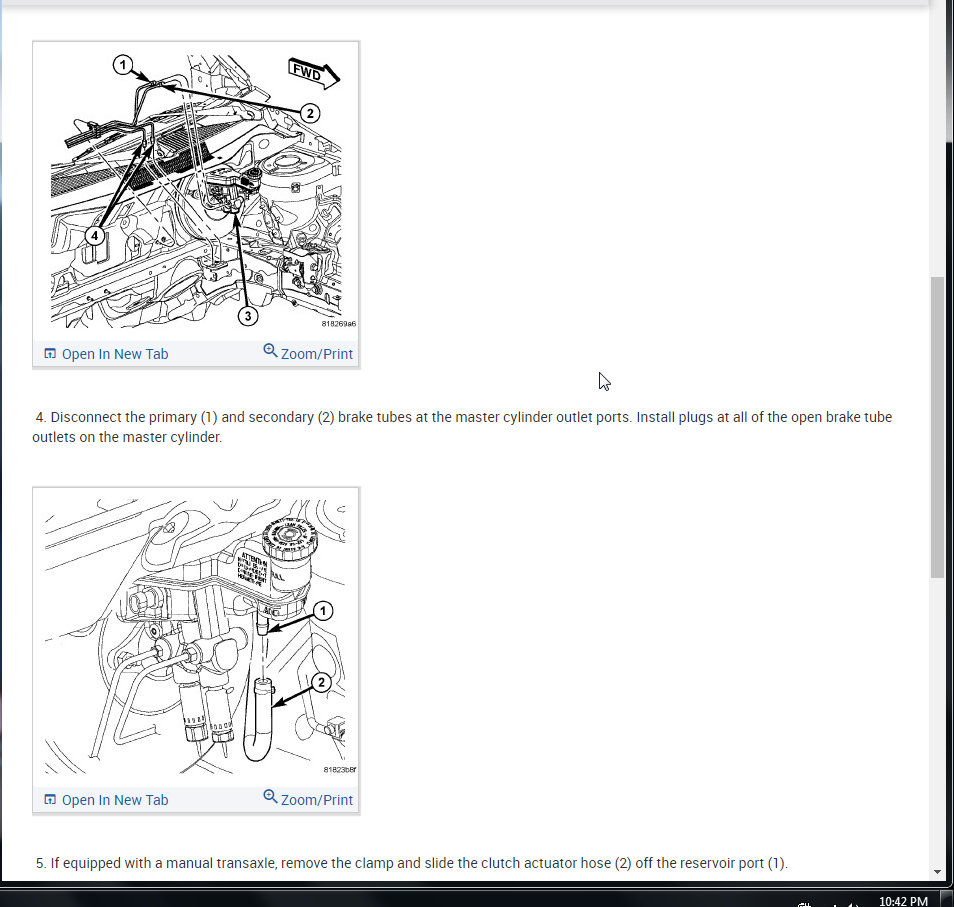

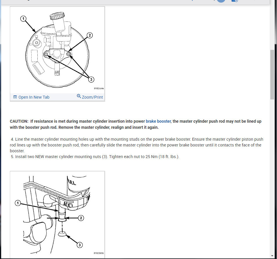

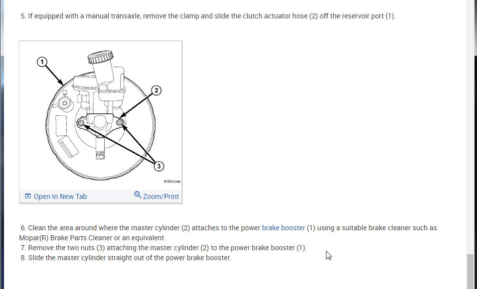

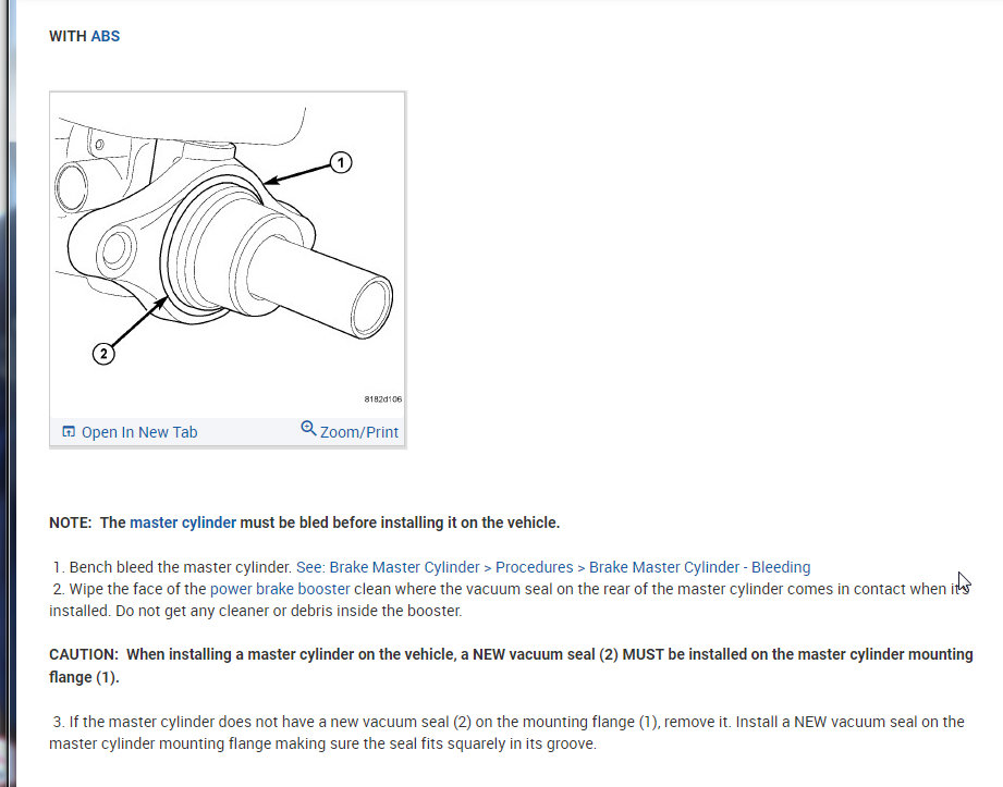

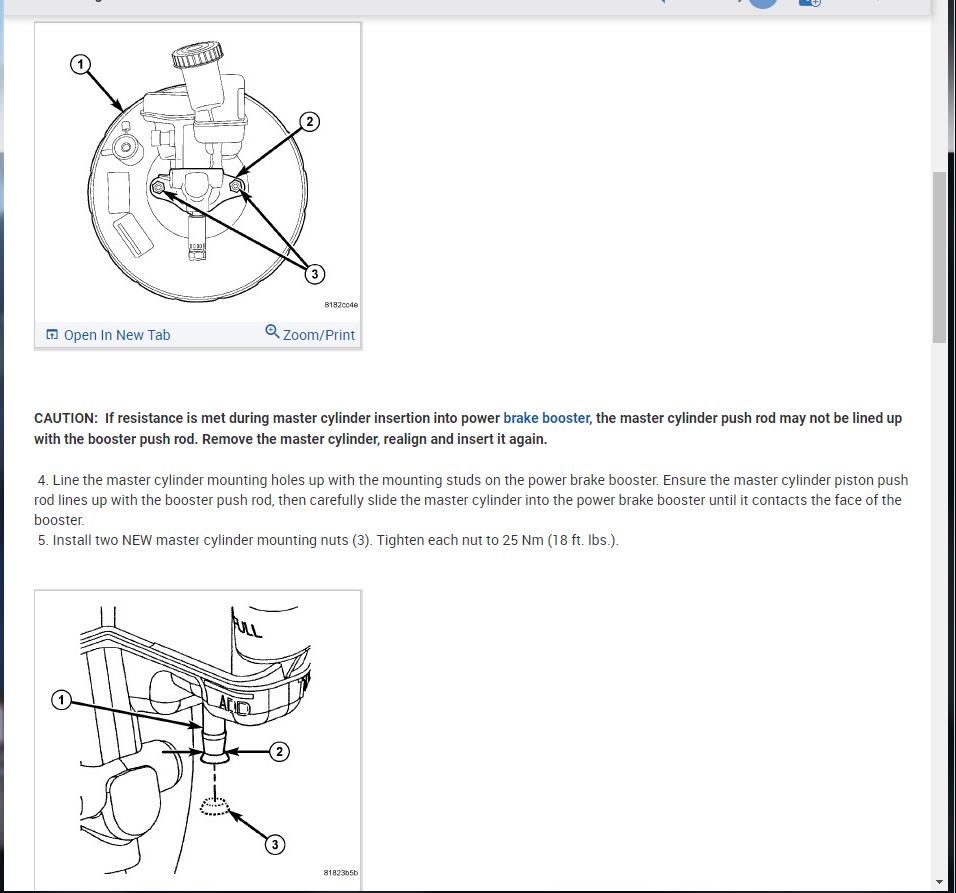

I attached the process below from the manual on how to replace this. Please let us know if you have other questions. Thanks
