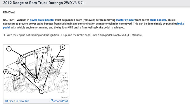

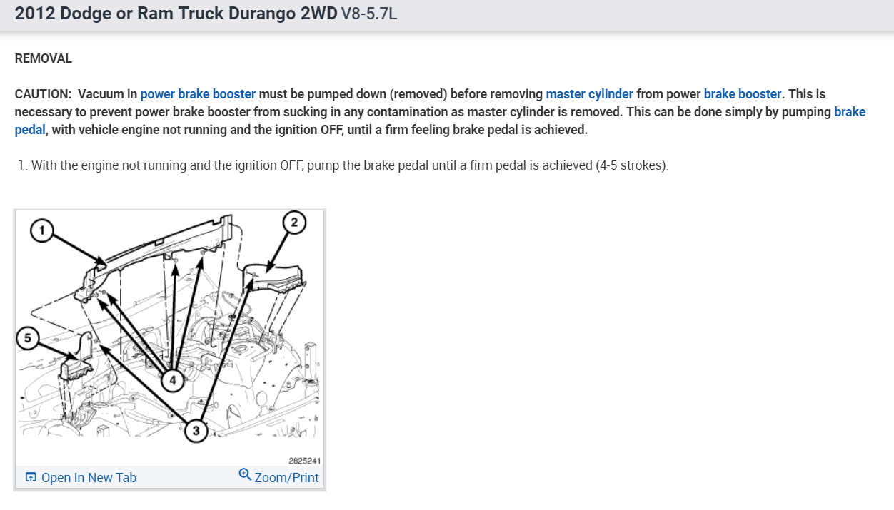

When i push the brakes to stop it stops as if i slammed the brakes even with the littlest push slams the brakes.
Jun 2, 2019 at 7:01 AM
  • 55,433 POSTS

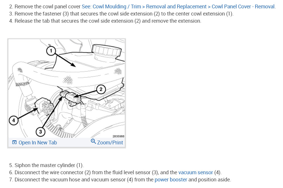

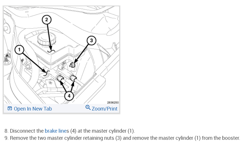

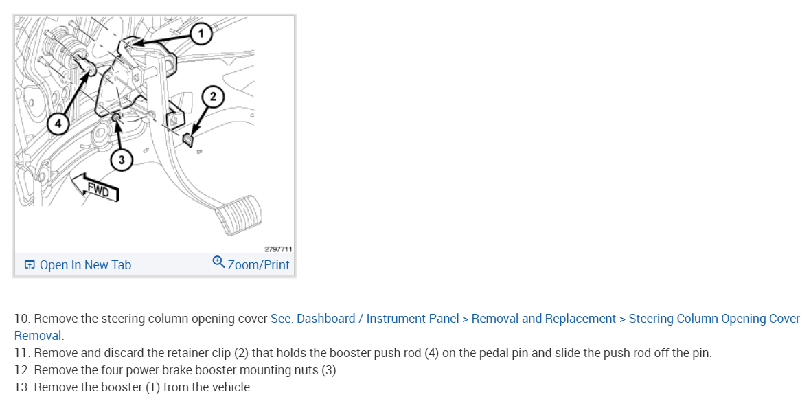

It sounds like you have a brake booster that has gone bad or one of the brake pads has fallen apart causing the locking. Can you tell me if you have checked the brake and are okay? If so and all okay here are diagrams and instructions to change the booster out. Check out the diagrams (below). Please let us know what you find. We are interested to see what it is.

I changed the power boost and master cylinder and i still have the same problem.
