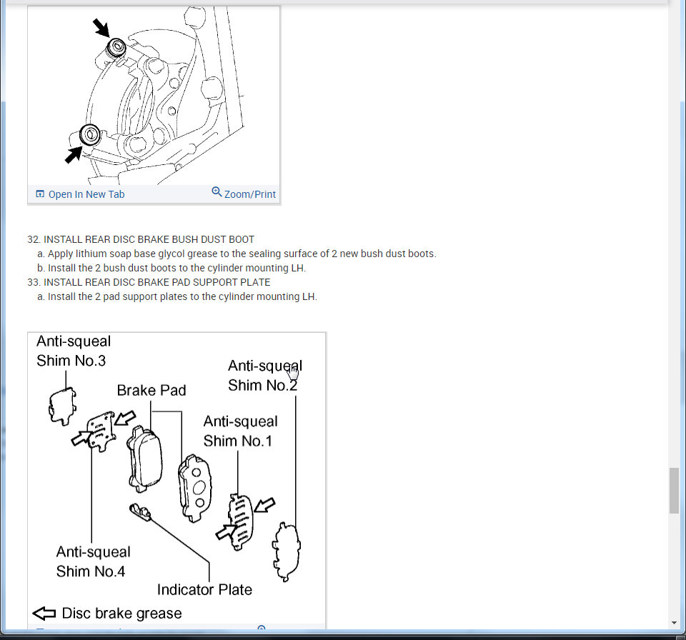

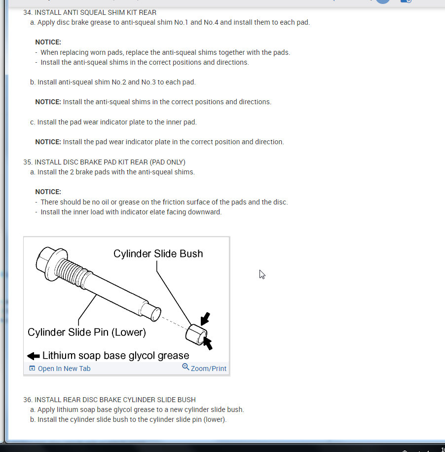

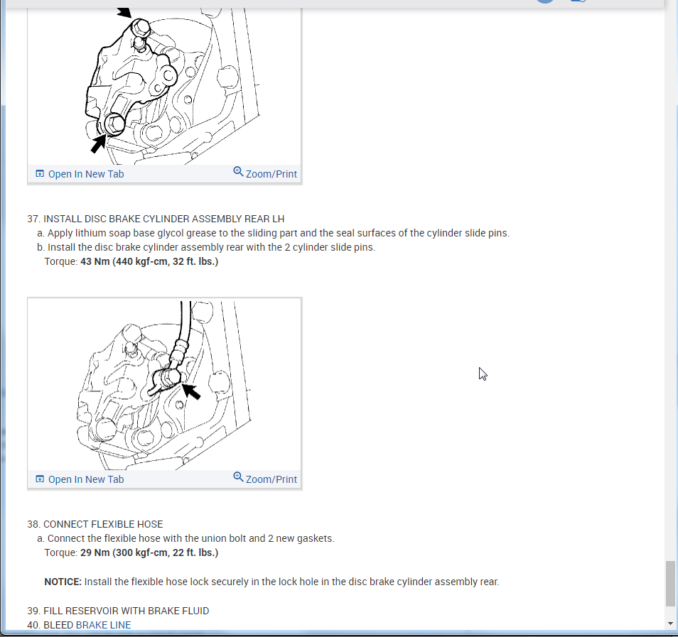

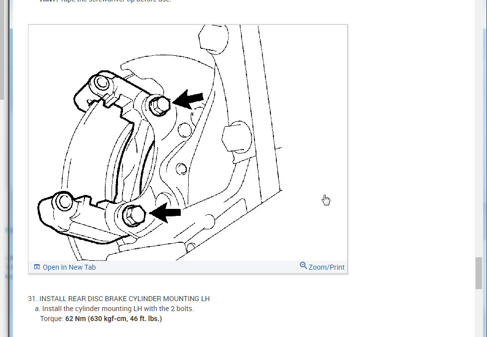

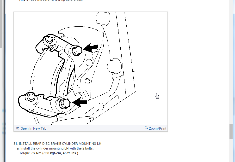

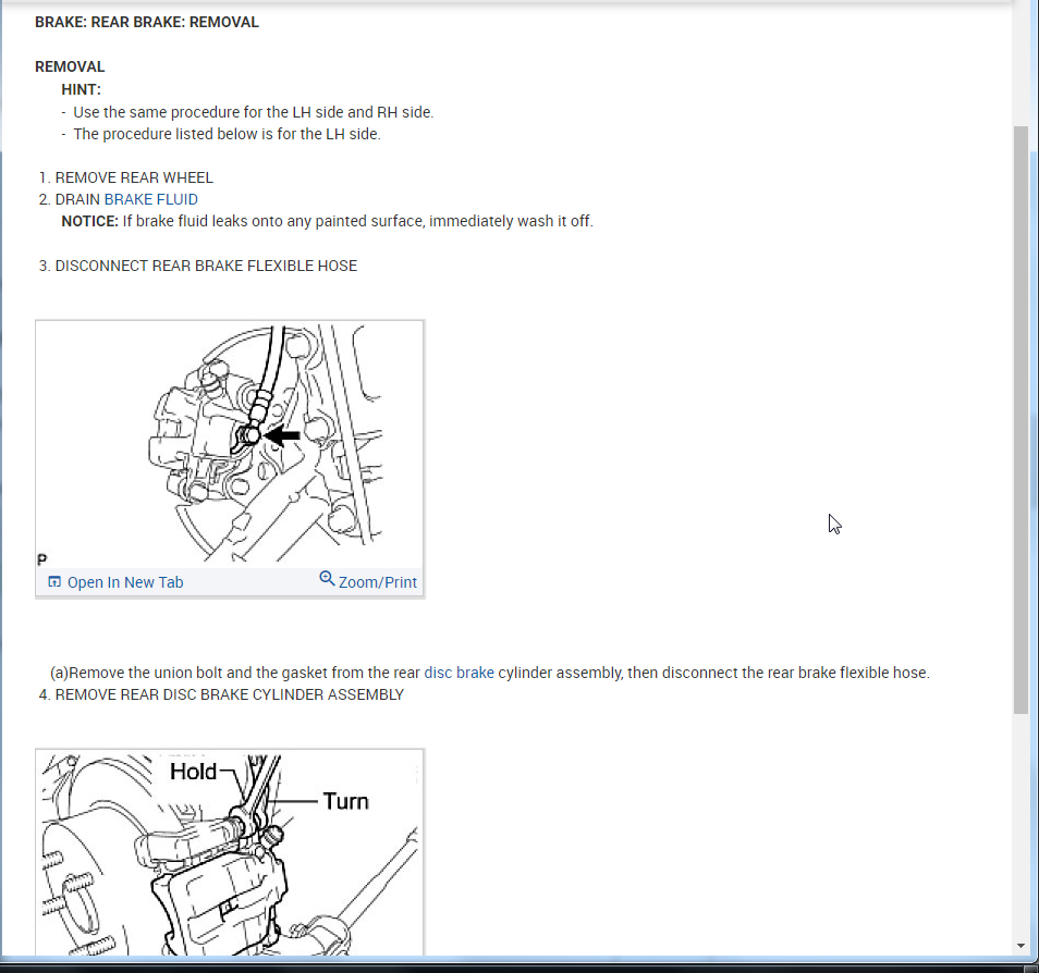

brake pads and rotor installation please help.
Aug 24, 2016 at 5:07 PM

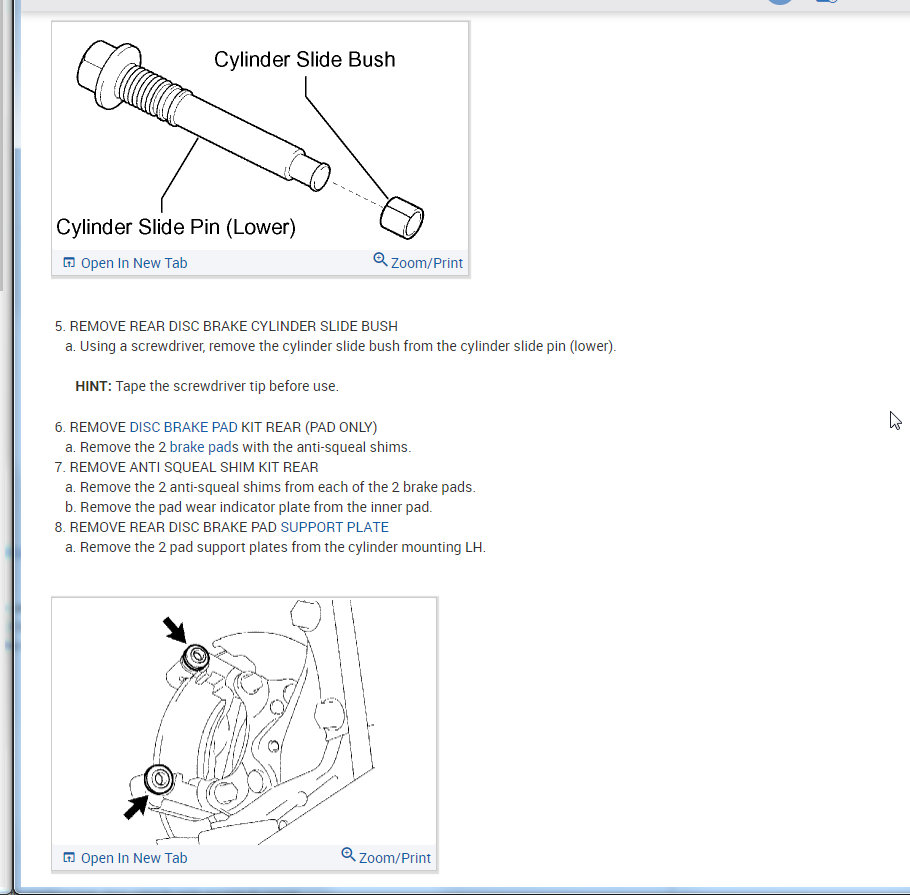

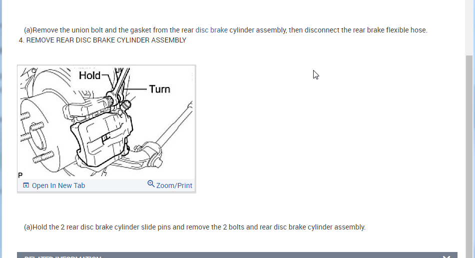

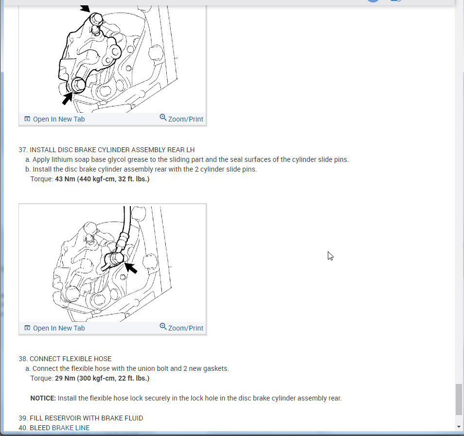

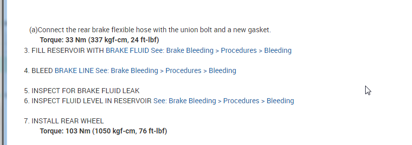

Here is a guide that will help with this: Here is a guide to help you step by step with instructions in the diagrams below to show you how on your car.
https://www.2carpros.com/articles/how-to-replace-rear-brake-pads-and-rotors
Here is a guide on how to retract rear calipers: This video shows the job being done on a similar car but the process is the same.
https://www.youtube.com/watch?v=j8YwfSKEzZo&t=29s

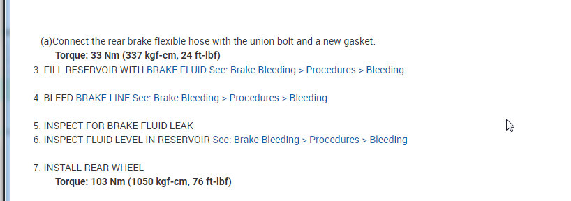

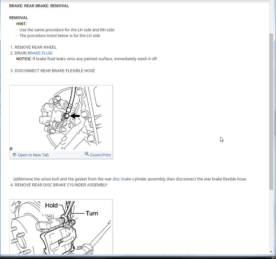

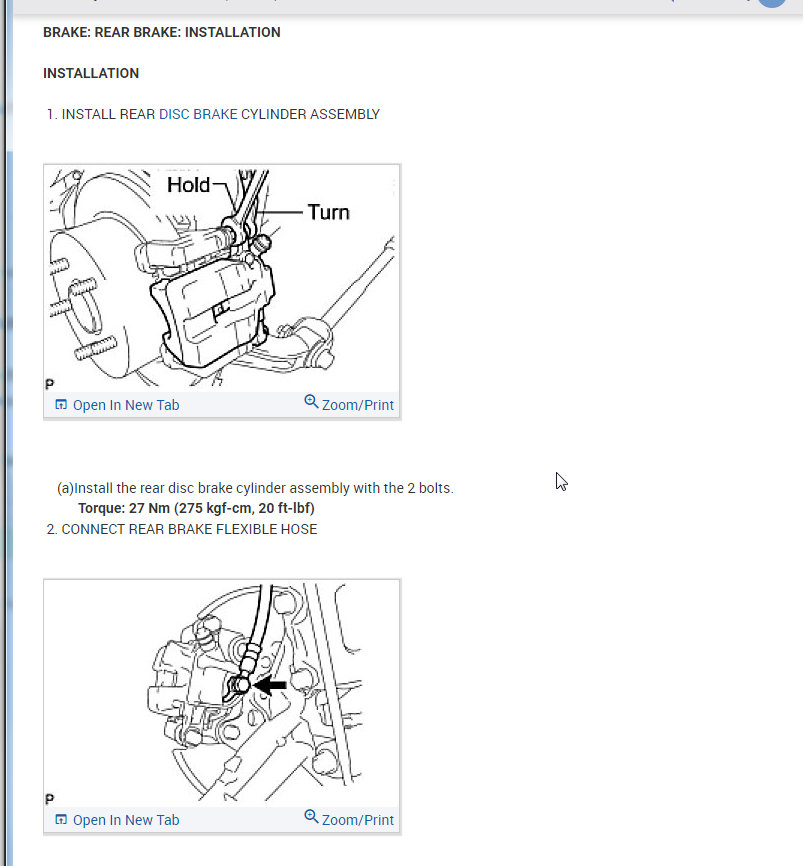

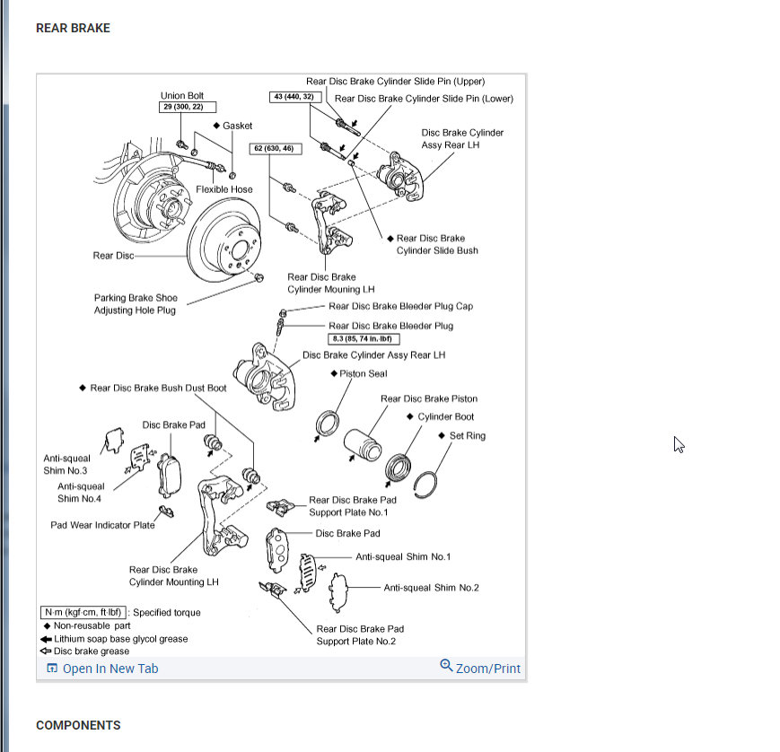

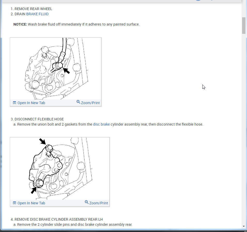

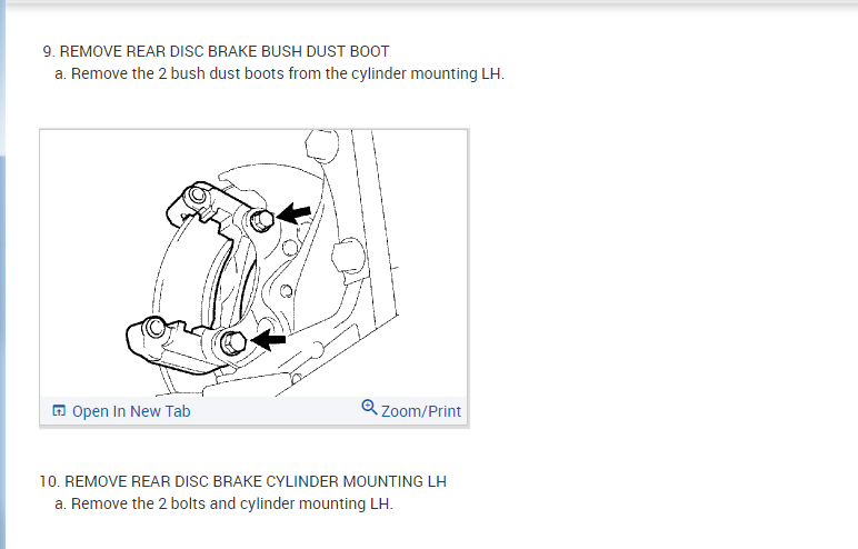

Below is the process from the manual that will show how to do this. Please let us know if you have other questions. Thanks

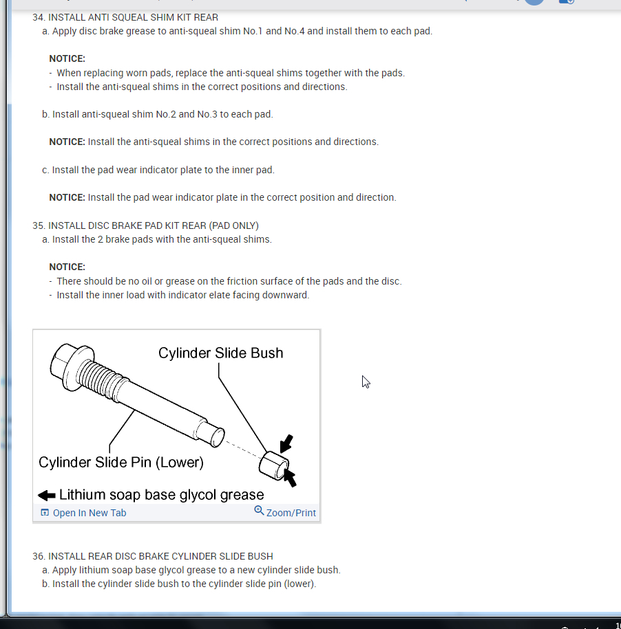

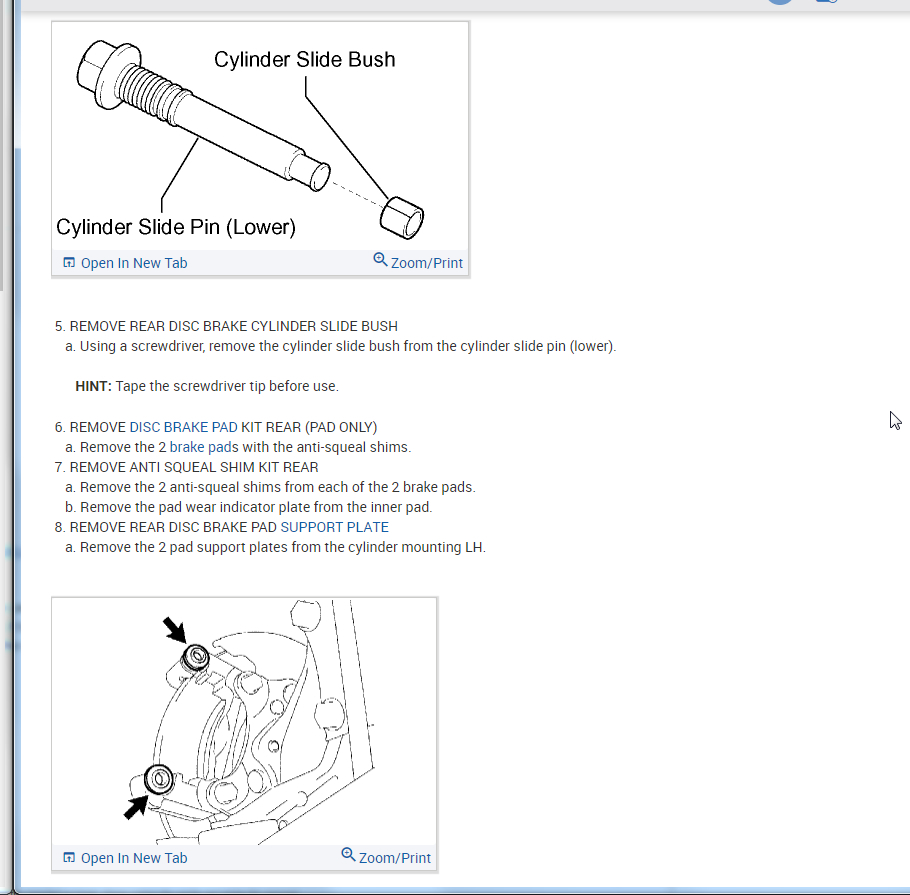

can I change the rear brakes?
May 17, 2021 at 5:10 PM (Merged)

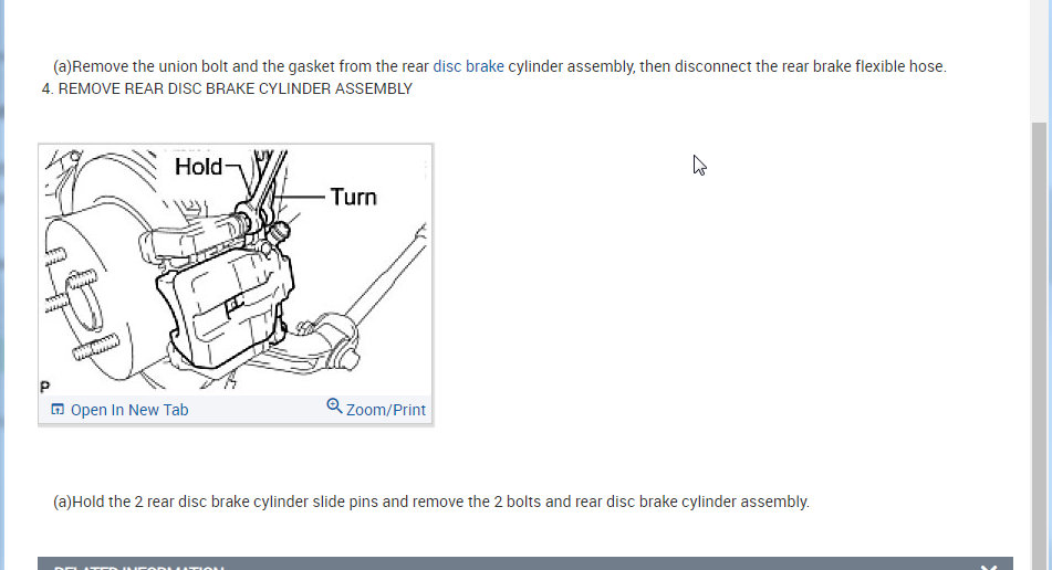

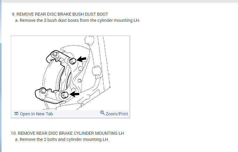

Here are some guides that will help with this:
Plus below you will find the info from the manual on how to replace the rear brakes.
Please run through this material and let us know if you have other questions. Thanks
