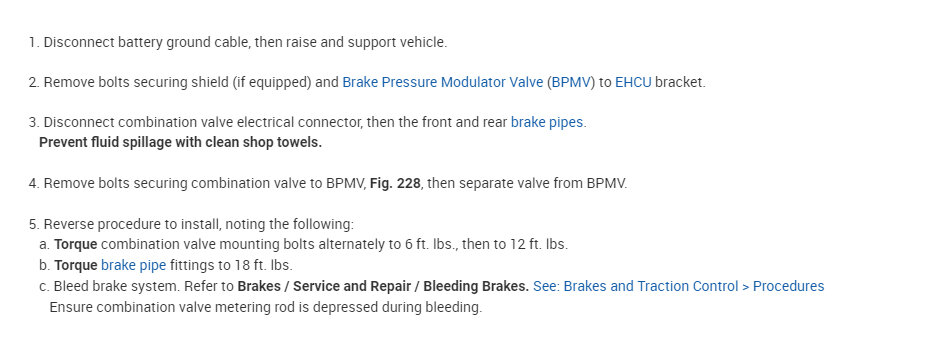

What you described sounds like issues we had with brakes years ago getting damp. Once driven a bit, they would begin to work normally.

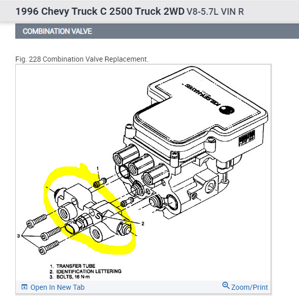

Do both front brakes lock? If they do and there is nothing leaking onto the calipers such as brake fluid, then I would suspect the brake proportioning valve is failing.
I attached a pic of the part below along with the directions for removing and replacing it.,. It is mounted to the ABS unit under the hood.
