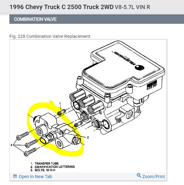

Every time when I go to drive my truck listed above the front brakes will lock up with very little force usually at the top of the pedal, if you baby it, it will stop but if you just go ahead too far it will automatically lock them up, but just on the first couple times after that they will work just fine.

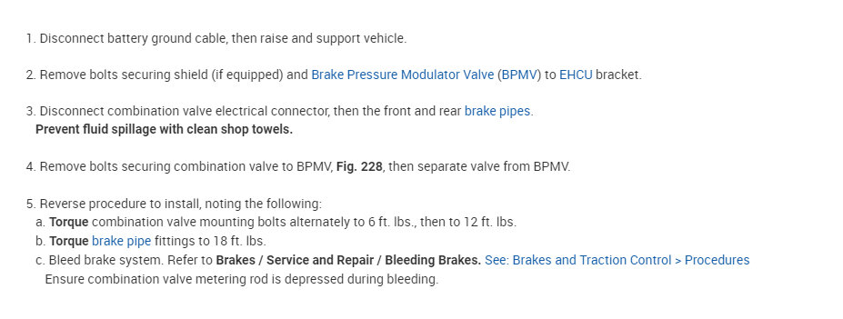

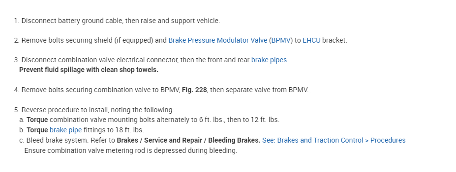

Do both front brakes lock? If they do and there is nothing leaking onto the calipers such as brake fluid, then I would suspect the brake proportioning valve is failing.
I attached a pic of the part below along with the directions for removing and replacing it.,. It is mounted to the ABS unit under the hood.
