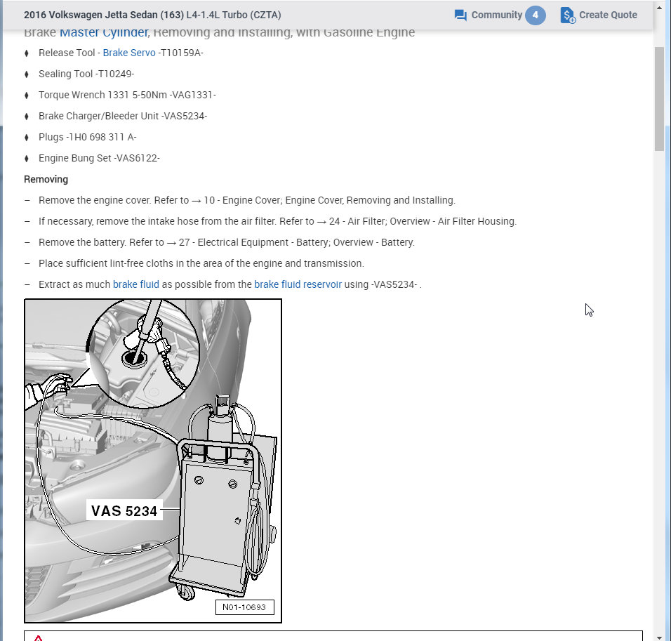

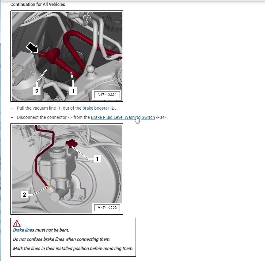

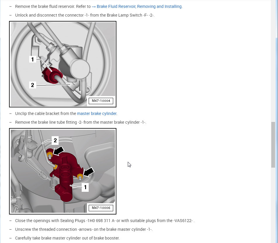

Thanks for the answer! Would the brake master cylinder need to be bench bled before being put on the car? It looks like the reservoir would be in the way of a tap to tighten it to the car if it did need to be bench bled. Thank you again!

Just to jump in here. yes, it's always a great idea to bench bleed a master cylinder before installing.Usually the master cylinder when purchased will come with a paper instruction guide on how to do it with a screwdriver or punch on your work station or table.When it comes time to bleed brake calipers after installation just remember to start with the one farthest away and work forward. Right rear,left rear,right front,left front and always keep the master cylinder full of fluid to not suck any air back into the system.Keep us updated and let us know if you have any further questions about this.Hope this helps and thanks again for using 2CarPros.

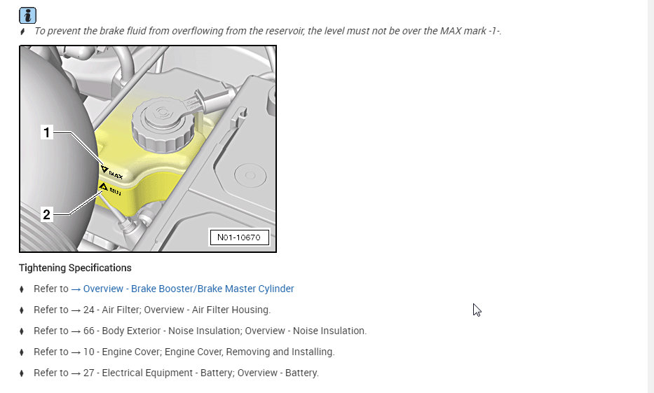

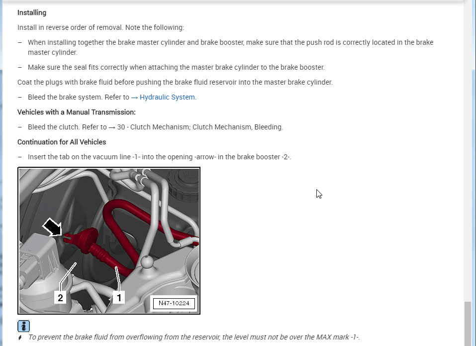

Thanks for all the assistance! I replaced the master cylinder. Bench bled it before installing and bled all lines. The pedal was firm for a few times, but now it goes to the floor without much resistance. The old master cylinder did seem to not have much resistance as I tested it off the car. What would be the reason (or reasons) for the lack of firmness of the brake pedal?
Jun 21, 2020 at 4:37 AM
CPELLA
More info: No leaks from what I can tell. I could not tell if it was leaking between the reservoir and the master cylinder though. It was low on brake fluid. Thank you for any assistance!

Usually a low pedal symptom like that after replacement would indicate there is still air in the system.Most newer cars that have ABS - anti lock brakes - can be very sensitive to air in the system.Here is a tutorial on how to bleed the brakes:
