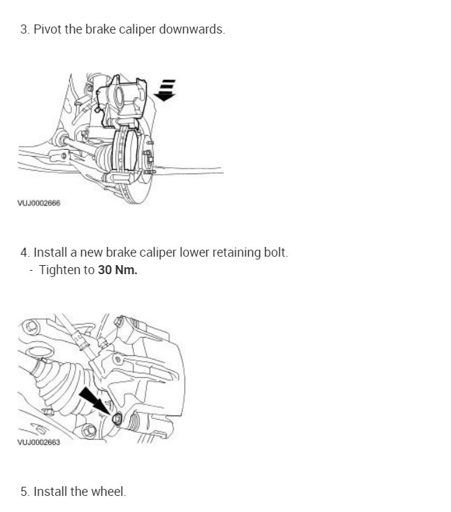

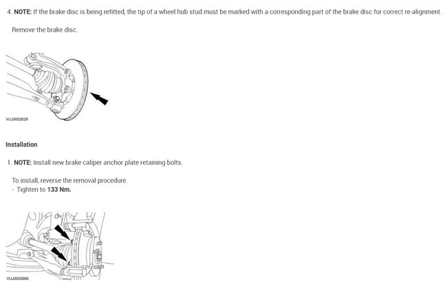

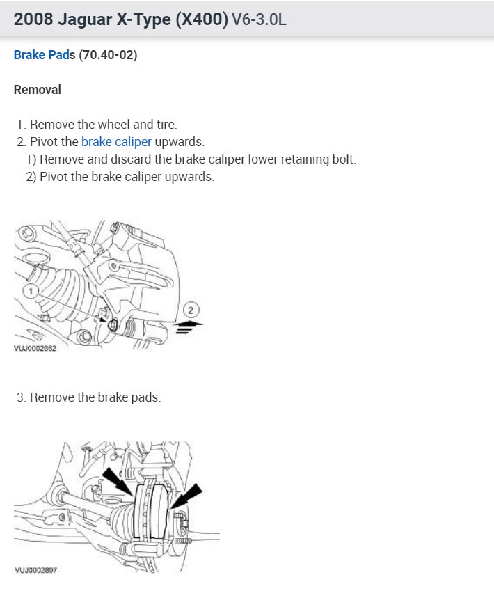

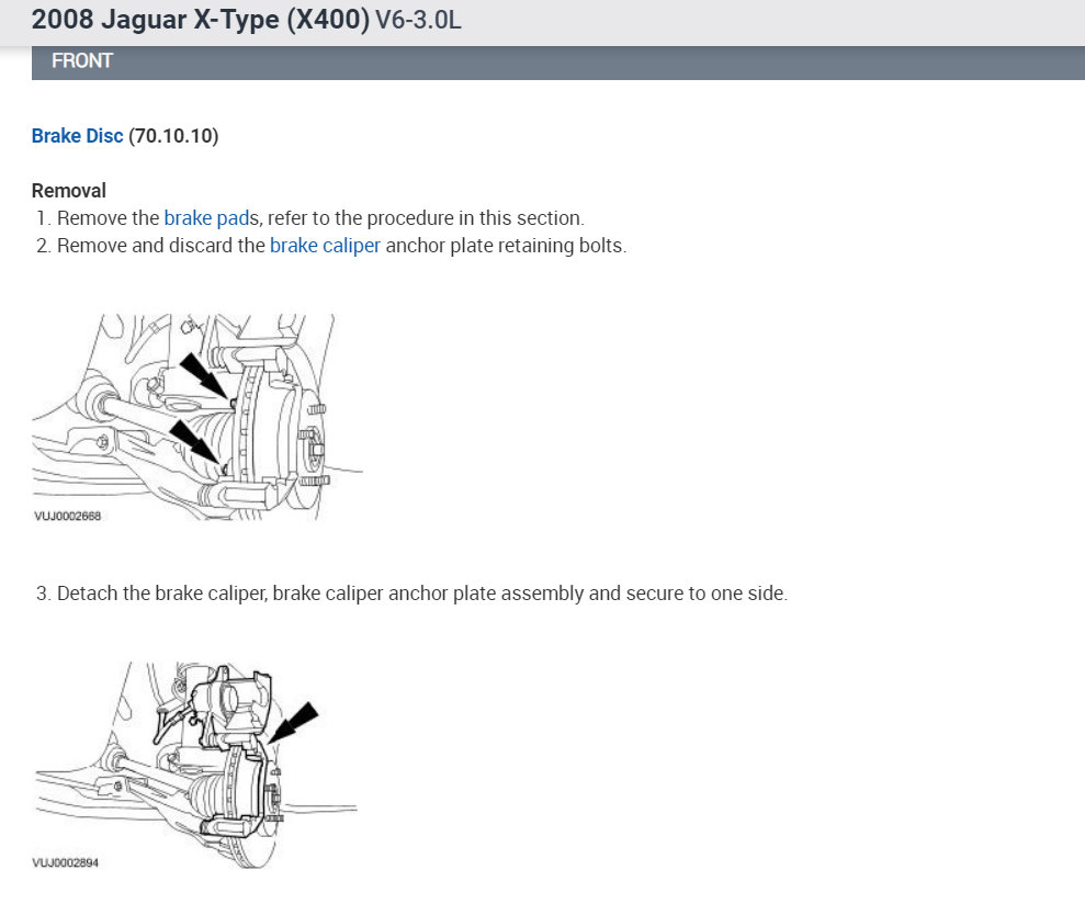

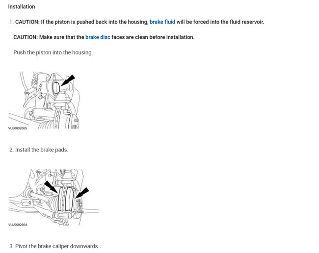

A knocking sound while I’m driving and when I brake the knocking becomes louder, and the steering starts to shake a lot.
Sep 25, 2022 at 9:53 PM
  • 55,721 POSTS
It sounds like you have warped brake rotors, if you can upload a quick video and upload it here in your response I can tell for sure. I have included instructions on how to replace the brake rotors and pads in case you need them in the images below. This guide can help as well:
https://www.2carpros.com/articles/steering-wheel-shakes-when-accelerating-or-braking
Check out the images (below). Let us know what happens and please upload pictures or videos of the problem.
