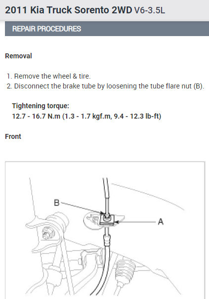

I see a brake fluid leak at the right
2011 KIA SORENTO
63,000 MILES • AUTOMATIC
KURT KOEHLER

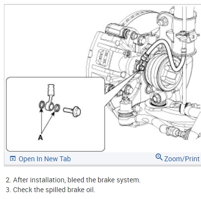

I see a leak at the right front can you help?
Apr 29, 2017 at 3:24 PM
DANNY L
  • 5,648 POSTS
Hello, I'm Danny.

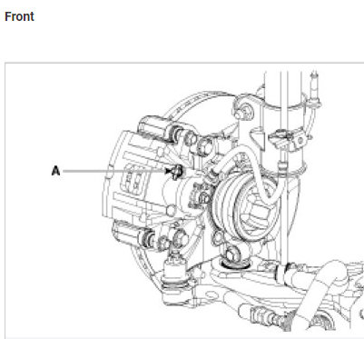

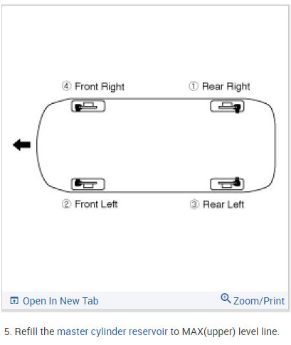

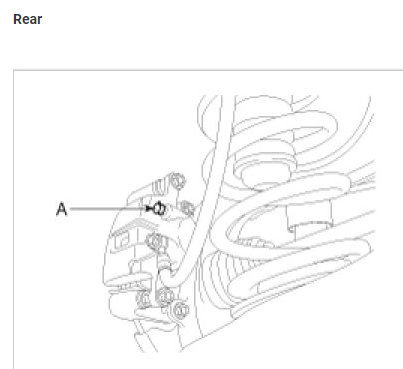

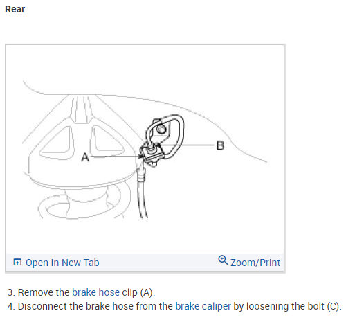

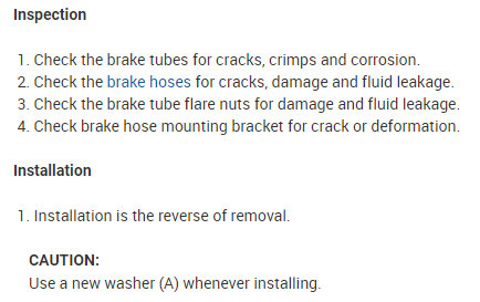

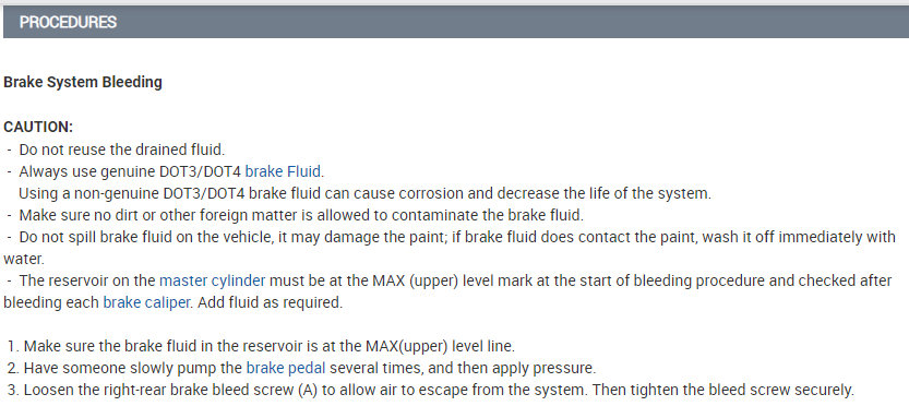

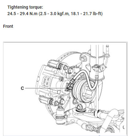

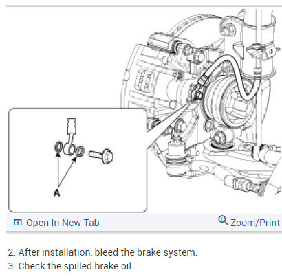

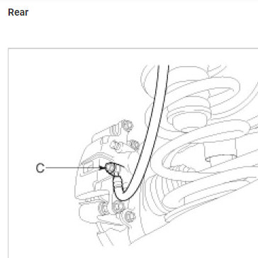

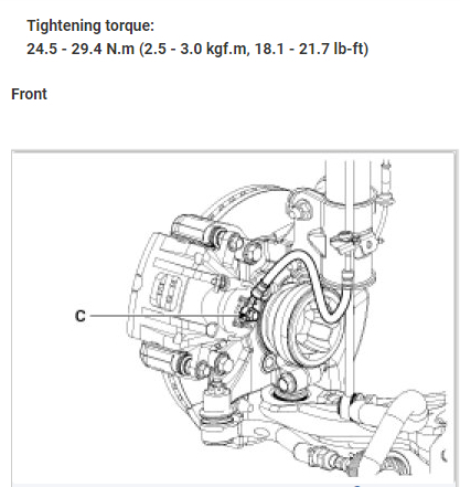

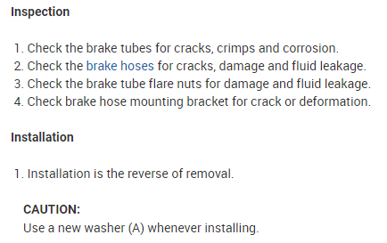

Here is the information you requested for brake line flex hose replacement. After replacing the line you will have to bleed the system to remove the air from opening the system. Here is a tutorial showing how to bleed the brake system after repair:
https://www.2carpros.com/articles/how-to-bleed-or-flush-a-car-brake-system
I've attached picture steps below on how to change the brake hose on your vehicle. Hope this helps and thanks for using 2CarPros.
