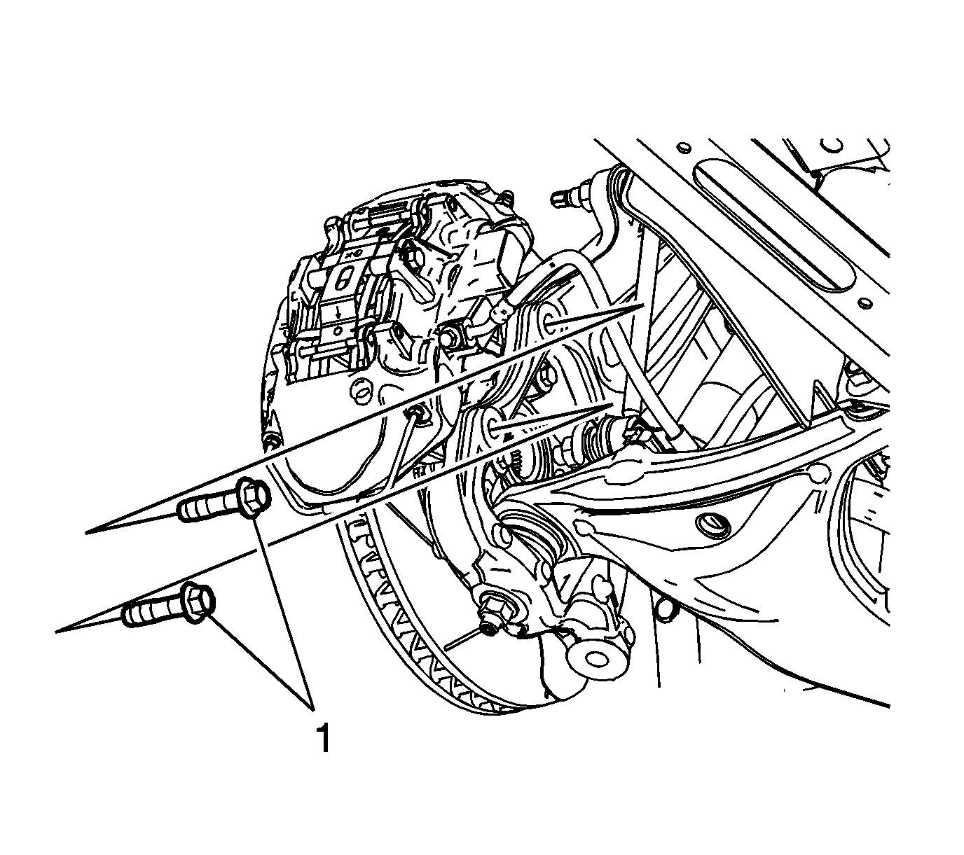

7. Remove the brake caliper bolts (1).

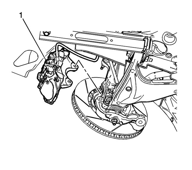

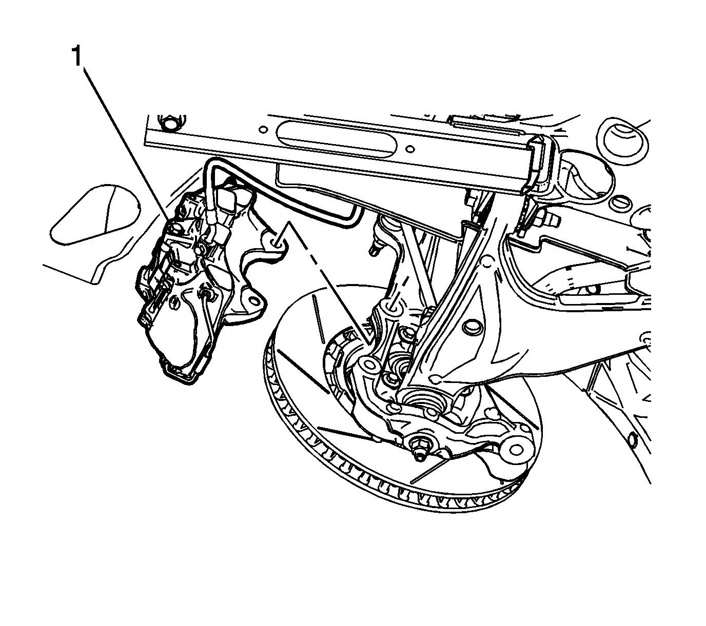

Caution: Support the brake caliper with heavy mechanic wire, or equivalent, whenever it is separated from its mount and the hydraulic flexible brake hose is still connected. Failure to support the caliper in this manner will cause the flexible brake hose to bear the weight of the caliper, which may cause damage to the brake hose and in turn may cause a brake fluid leak.
8. Remove the brake caliper (1) and support with heavy mechanics wire or equivalent.

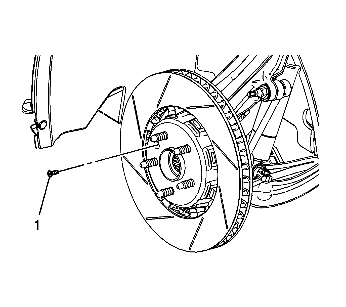

9. Remove the brake rotor screw (1).

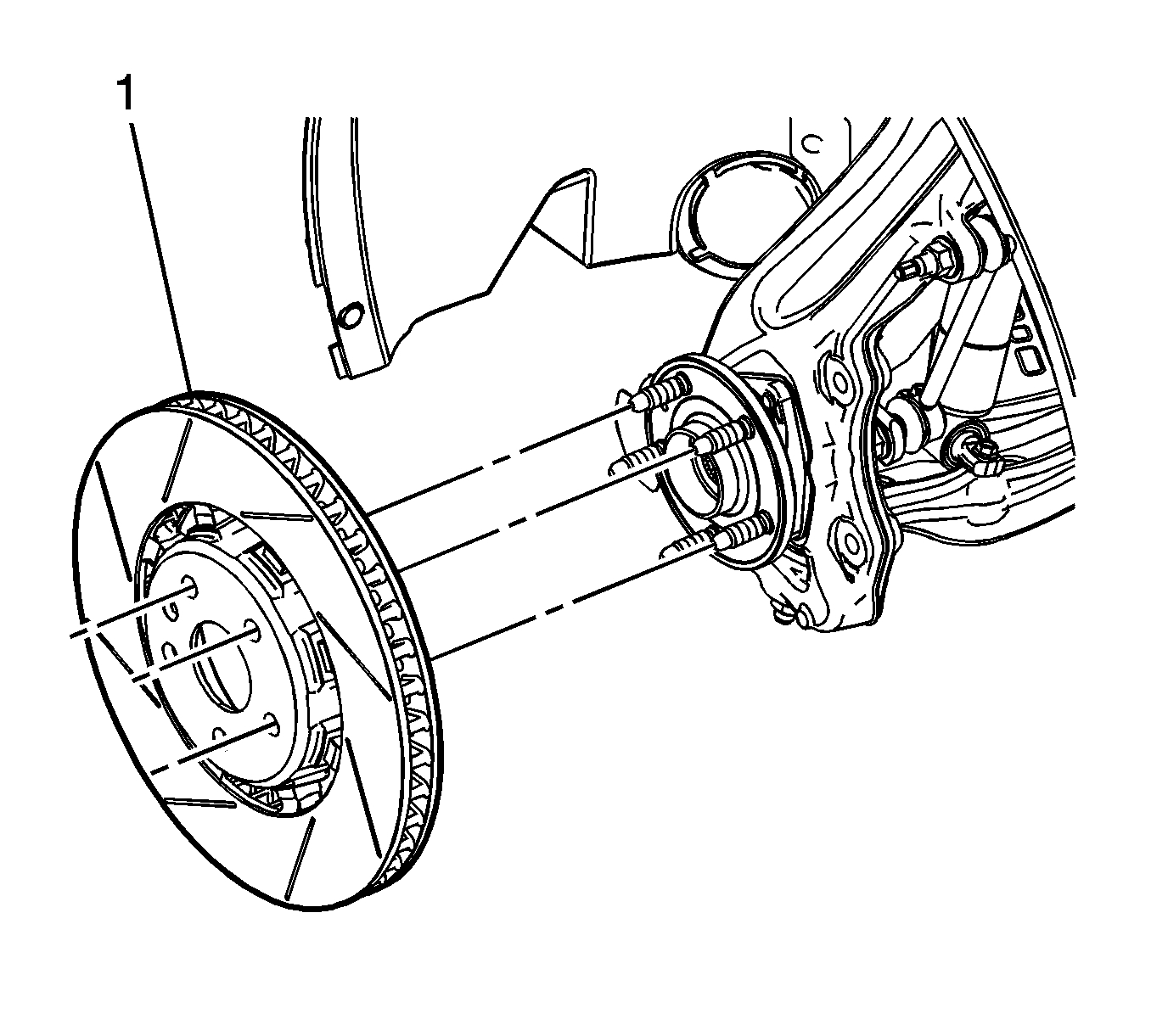

10. Remove the brake rotor (1).
