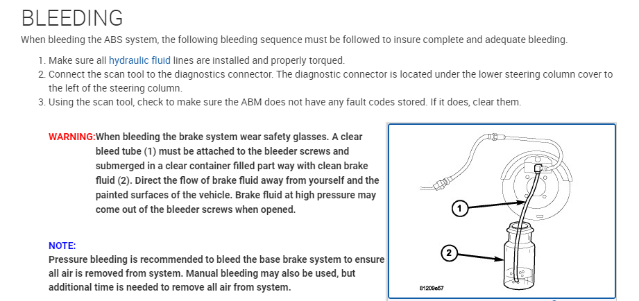

I recently replaced my brake calipers and the pads and today I replaced the master cylinder. However, my pedal is still going to the floor, and I have to use the emergency brake to stop. I'm getting really frustrated here. Can you please tell me what could be doing this and how I could fix it before I burn this truck to the ground?
May 13, 2023 at 10:47 AM
  • 110,240 POSTS

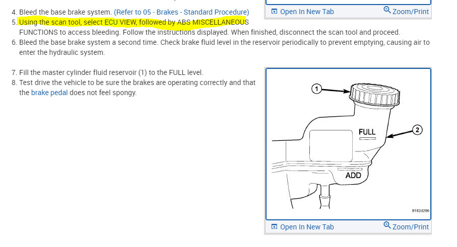

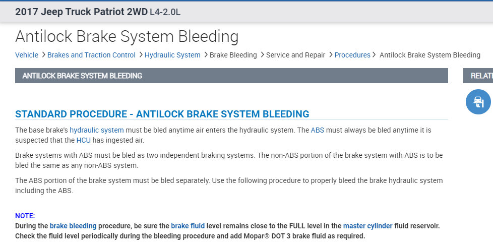

If the brake master cylinder was allowed to get too low, chances are you have air in the ABS hydraulic unit.
As a result, you will need to perform an automated bleed procedure. This requires a bidirectional scan tool that can communicate with the module.
If you look below, I attached the directions. Let me know if this helps or if you have questions.

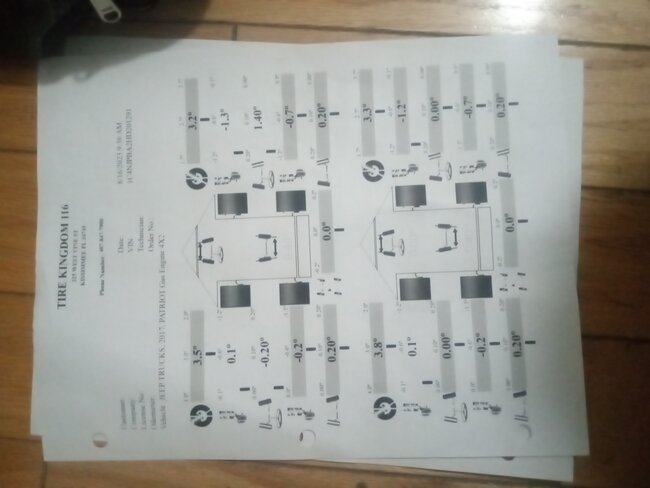

Just got home from getting the alignment done, finally. Yay. Here are the printouts for you. I really hope you can help with this, and I can finally figure out why all of the parts on the front of my truck keep going bad.
Aug 16, 2023 at 1:17 AM
CARADIODOC
  • 34,369 POSTS
There's a different page I would rather see that just lists a whole pile of numbers, but that's more for checking for proper crash damage repair. I can offer a few comments related to this printout.
First, while it doesn't say it, it appears the top drawing is the "Before" readings, meaning what the vehicle came in with, and the bottom one is the "After" readings once all the adjustments were completed.
The top number on each side is for "caster". Visualize how the fork on a bicycle angles rearward at the top. When you put weight on the tire, it makes the wheel want to squirt out straight ahead. That is what allows you to ride no-handed. Caster on the car has to do with the upper ball joint or the upper strut mount being further rearward than the lower ball joint. Those are the two steering pivots. Being offset from the center of the tire, "positive caster" which is the upper pivot behind the lower pivot, makes each front wheel want to turn toward the center of the vehicle. The higher the caster, the harder that wheel wants to turn in when vehicle weight is placed on it. As late as the 1960s, it was common to call for negative caster, meaning the upper ball joint was forward of the lower ball joint. That made for very easy steering. Even large trucks could be steered easily.
By the late '60s, we were driving faster, but negative caster is very unstable. Cars wandered all over which made them tiring to drive with the constant steering corrections. We went to positive caster for greatly improved stability, but it makes steering much more difficult. The wheel turning out is actually raising that corner of the car. To deal with the increased steering effort, power steering was added. We still can't adjust caster too high as it would still take too much effort to control the car, especially at lower speeds.
To put this in perspective, imagine standing beside the car, looking at the side of the tire. If the upper ball joint is directly over the lower ball joint, that would be 0 degrees caster. Now imagine the spindle and upper ball joint are rotated more and more until the upper ball joint is behind the lower one, (more or less right under the brake pedal). That would be 90 degrees. Most car and light truck models call for around 3 degrees caster. That's plenty to provide easy steering with no wander. Of more importance than the actual values, we want caster to be equal on both front wheels. Looking at your printout, RF caster is 3.2 degrees which makes that wheel want to turn left simply from the weight on it. LF caster is higher at 3.5 degrees, so the left wheel wants to turn to the right, but slightly harder than the right wheel. When the two spindles are connected together with the steering linkage, those two pulls are supposed to be equal and cancel each other out. In this case the 0.3 degree higher pull on the left wheel will more than cancel the pull on the right wheel, with a little left over to cause the vehicle to pull to the right when you let go of the steering wheel. Don't panic; more on that in a moment.

Caster is the hardest alignment angle to explain and visualize. "Camber" is the easiest. That has to do with the top of the wheel tilting in or out. If the wheel is perfectly straight up and down, that would be 0 degrees camber. Imagine that wheel being tipped out on top more and more until it is laying flat on the ground. That would be 90 degrees. Tipped out on top is positive camber and is by far the most common. A few models call for negative camber, meaning tipped in on top, usually to overcome some design issue and achieve decent tire wear. For most models, 0.5 degrees, give or take a quarter of a degree, is a typical value for camber. One of the big unknown purposes of camber is the tilt causes the vehicle's weight to be placed directly over the larger inner wheel bearing, (when we had the big inner and smaller outer bearing that we had to grease periodically). Today everyone uses a different style sealed bearing and hub assembly, but camber is still responsible for eliminating a sideways or twisting stress on those assemblies. Correct camber helps those bearing live longer.
The most talked about purpose of correct camber is to reduce tire wear. If camber is too high positive, the tire will ride more on the outer edge of the tread and make it wear faster. Too much negative camber causes accelerated wear on the inner edge of the tread. This is part of the wear patterns we "read" when looking for what needs to be corrected when we start the alignment. (It's also why we would prefer to align your car right before you buy new tires, not right after). As long as all the old tires are the same size, we can read them and make all the adjustments needed, then you can have the new tires installed.
Another very important fact about camber is the value on a wheel affects the tire wear on only that one tire. Camber can be out of adjustment on multiple wheels, each with its corresponding bad wear, but misadjusted camber on one wheel never affects the wear pattern on another tire.
Next, camber has the biggest effect on pulling to one side. A tire wants to roll in the direction it is leaning, so positive camber on the left front wheel makes that tire pull to the left. The goal is to set camber on the right side to the same value so the two pulls offset each other and the car goes straight. Camber on your left front is 0.1 degrees. Without knowing what the specs call for, I'd call that quite respectable. It's the right front that disappoints me. The negative 1.3 degrees is a real lot. That tire is going to develop accelerated wear on the inner edge very soon, and with only the 0.1 degree on the left to offset it, the 1.2 degree difference is going to cause a significant pull to the left.

The last of the three main alignment angles is "toe". That's the direction each of the four wheels is steering when the steering wheel is straight. Changing caster or camber usually causes the toe value on that wheel to change, but adjusting toe has no noticeable affect on the camber and caster settings. For that reason, toe is always the last thing to be adjusted. For your preliminary numbers, there's no way to know if the steering wheel was straight when this "snapshot" was taken by the computer. Don't panic if your observations when driving to the shop disagree, but for the sake of this sad story, we'll assume the steering wheel is straight. The left front wheel is at minus 0.20 degrees. Negative toe means that wheel is steering away from the center of the vehicle, but by just a little. The right front is at positive 1.40 degrees. That's a bunch, but very respectable considering this was right after the tie rod ends were replaced. I'd be very happy to get all of mine that close. That wheel is steering to the left. Overall, whenever both wheels had equal weight on them, (you weren't driving over a bump in the road), the vehicle is going to steer to the left. You have to turn the steering wheel to the right to make the car go straight.
This brings me to some more exciting points of interest. First, this unequal toe results in an off-center steering wheel. A car could go perfectly straight down the road without you touching the steering wheel, but the wheel is not straight. That is very different than when you have a caster or camber pull and you have to turn the steering wheel by hand to counteract that pull. Many car owners have a hard time understanding the difference between an off-center steering wheel vs. one that has to be turned off-center to counteract a pull.
Next, to my knowledge, all alignment computer will only read toe to the hundredth of a degree. I don't think they can be set to read to tenths because all vehicles require the higher precision. A typical spec for many years has been 0.20 degrees plus or minus 0.20 degrees. We're picking tiny nits here to get it right, and tenths of a degree just aren't good enough.
The last thing here is the computer is reading toe in degrees. I don't have a good feel for that. Mine was always set to read it in inches which is what many race cars are set to with a tape measure. A reading in degrees will be exactly twice as big as the same one in inches. That means I can have 0.25" of toe and if I change my computer to display it in degrees, it will show 0.50 degrees. This isn't important except when we're analyzing a printout and we fail to notice which unit of measurement is used.

My next concern is when looking at the "After" readings, front toe on those two wheels is all that was adjusted. They may have only been interested in that due to the new tie rod ends, but in good conscience, I couldn't leave the right front camber like that. Even if there was such a thing as an "economy" alignment that didn't include adjusting caster and camber, I'd still try to make it better. In fairness, some trucks need to have special offset ball joints installed to make camber corrections. That's a big job that would warrant an additional expense, but it's usually only done once to a wheel in the life of the vehicle. That right front camber will actually come up quite a noticeable amount by simply letting a few pounds of air pressure out of that tire.
Your vehicle is too new for me to be familiar with it, but it looks like it has independent rear suspension. With an older design solid rear axle, camber and total toe for both wheels would be 0.00 degrees / inches. Even a solid axle can be mounted slightly turned, so all alignment computers look at the two rear toe readings, then calculate where they want us to adjust each front toe to get a straight steering wheel. With independent suspension, ride quality is seriously improved, but at the expense of tire wear if it isn't adjusted to specs. Here you have 0.20 degrees toe-in on each wheel. I'd look twice at that 0.40 degrees total, but without knowing the specs, I'd suspect that to be quite acceptable. The fact that toe is exactly equal on both wheels is extremely rare and quite the coincidence. No correction to the front toe settings was needed, but if it was, we don't do or calculate anything. The computer does that and we just adjust each front wheel to where it tells us to.
The negative camber settings on the rear are not that uncommon. I think they're doing that for better cornering, but it could be for comfort or it could be with lots of test-driving, that's the setting the engineers found that gives the best tire wear.
There's way more than you wanted to know about your alignment. If you're having any issues or symptoms I didn't cover, let me know and I'll start over!

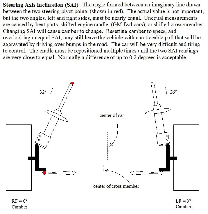

The other value I'm interested in is "steering axis inclination", (SAI). There is never a spec given for that. All we care about is it is equal on both sides. Remember where I described caster as the upper ball joint is further back than the lower one, and that angle is viewed when standing beside the vehicle and looking straight at the side of the wheel? If you draw an imaginary line between those two ball joints, that angle is caster and is identical to the rearward tilt of the front fork on a bicycle. Well, SAI is another imaginary line drawn through those two ball joints, but this time it's viewed from in front, looking back parallel to the tire's sidewall. The lower ball joint will be out further, kind of in the area of where a clutch pedal would be if you had a manual transmission. The upper ball joint would be closer to the center of the vehicle, kind of inline with the brake pedal. From true vertical, that SAI line will typically be around 28 to 32 degrees. If both sides are within 0.2 degrees of each other, we're happy. When they aren't equal, it points to possible crash damage and will make for a miserable car to drive. There will be no "predictability", meaning you have no idea which way it's going to veer each time you hit even a tiny bump in the road.
SAI is commonly messed up on GM vehicles. To service the engine or transmission usually requires everything be dropped down on the sub frame / cross member. We're supposed to mark the four or six bolts that must be removed so we can reinstall the assembly in the original position. When you don't know where you started, that assembly can be bolted in off-center up to a quarter inch to either side. Because the lower control arms are connected, along with the lower ball joints, shifting the cross member's position raises camber on one side and lowers it on the other side. Camber is all that shows up on the main adjustment screen, and that's what most people will correct. While camber can look perfect on the final printout, SAI is still unequal and handling will still be horrendous. Some specialists will switch screens and look at SAI, (those readings get measured automatically, but we have to consciously look at them), and make that correction first. Most of the time doing that correction brings camber on both sides right back into specs. The four or six bolts are just loosened a little, then the cross member can be pried to either side with a big pry bar. It's a quick, simple procedure, but you have to know it needs to be done. I always recommend people tell the alignment specialist what service work was just performed that made the alignment necessary, then it's more likely SAI will not get overlooked.
Many Chrysler models can have their drive trains serviced in a similar manner, but the bolts holding the cross member in have really wide shoulders right under their heads, before you get to the threaded sections. The holes in the cross member just fit those shoulders, so as the cross member is installed, the bolts force it to go back to its correct position.

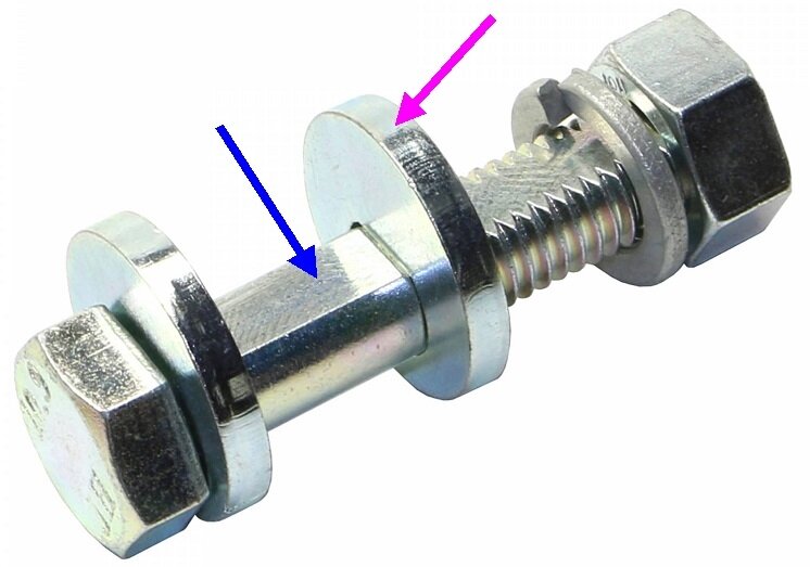

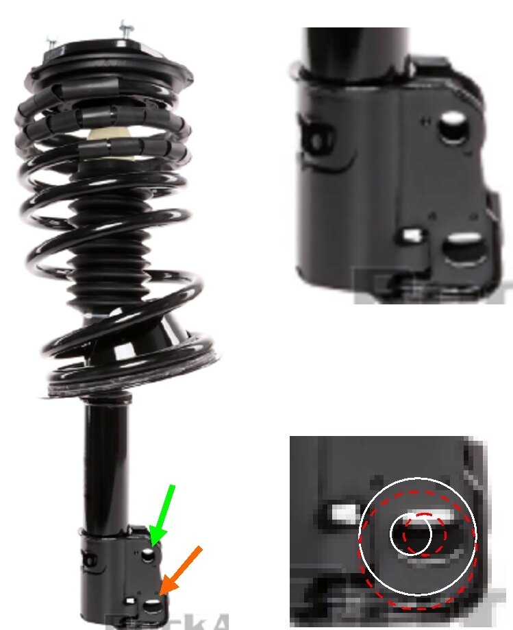

The first choice is to have the original shop fix the camber on the right side. If you don't want to go there, the next suggestion is to find a community college with an Automotive program and talk with the instructor. We were always looking for live work, and we had a few dozen local people who would sit on a broken car for months until it fit what we were teaching, because they knew the value that live work offered our kids. Be aware, in our case, we taught eight areas, each once a year for eight weeks. Part of that time was spent in the classroom, so it can take days or weeks to get a job back that should take a few hours. If nothing else, they can use it for one class period to inspect it and see if and why camber can't be fixed. They won't work on it outside of Suspension and Alignment class as that would put them in competition with the local shops that hire their graduates.
We got parts at very good discounts, then marked them up ten percent to form a "breakage" fund in case we damaged something. Labor was billed at $10.00 per hour for what the job was supposed to take at a regular shop.
I'm running out of laptop battery so I might have to continue this story tomorrow. I can copy and format the instructions for adjusting camber. I see now a good reason why they may not have done it, but you can do this yourself, then take it back.
Back in the '80s and '90s, Chrysler used a "cam bolt" at the bottom of each strut. Simply loosening, then rotating that bolt pushed the spindle in or out to adjust camber. GMs worked a similar way, except you loosened the bolts, kicked the tire to move the wheel, tightened the bolts, checked what you got for camber, then do that over and over until you gave up and called it "good enough". Also, on GMs, you have to take everything apart first and grind that hole bigger to allow for the adjustment. If you remove your right front wheel, (please be sure to use jack stands), look at the bottom of the strut. You'll see two long bolts going through it that hold it to the spindle. On Chrysler struts, that lower hole was ovel-shaped. The photos below are for my old '88 Grand Caravan. Notice the oval mounting hole.
On GM struts, that hole was round and had to be ground larger with a die grinder the first time camber needed to be adjusted. Aftermarket replacement struts usually come with the elongated hole. On GMs and many newer Chryslers, you have to remove the original lower bolt and install the cam bolt. The aftermarket version is shown in the second photo. You loosen both bolts, then reach over the tire and with a ratchet and long extension, rotate the head of the bolt until you get what you want for camber, then tighten them. From what I briefly read for your model, both bolts are supposed to replaced with skinnier bolts to produce the "slop" that allows the spindle to be tipped. One new bolt might be enough, but you can do that yourself. Replace one first and snug it to hold things in place while you install the second one. Now, loosen both of them a little, then tug out on the top of the brake rotor or bottom of the strut. You'll see the movement which is the camber setting being changed. As a guess, I'd suggest the top of the brake rotor would need to be pulled out roughly a quarter to a half inch to get camber closer to specs.
Those bolts will need to be really tight before you set the vehicle down on the tires. Its weight and hitting bumps can let those bolts slip, then you're back to the alignment shop.
If the parts store offers you a cam bolt instead of the two smaller bolts, go for that. On the older struts, the offset head sat in a pocket on the strut. That held them in place and made them just about immune to slipping. GMs don't have that feature, and this newer design you have might not have that either. I'll have to look for a photo of your struts to see if a cam bolt will work.

Thank you. Both of the bolt holes on my strut are pretty big. The bolt that goes inside them is 22mm and they are the bolts that are threaded only so far then smooth. Every time I have to undo them, I have to take a mallet to them until the thread catches. I always try to be very careful not to beat the threaded part through, so I don't mess it up. Not that I don't have hardware for 3 X's everything that even touches my front wheels because every time I have replaced anything I always get new hardware too, but if I get lazy and just beat it out and use the new, I will run out and then where would I be? Up the creek without a paddle. So, I don't want to get complacent. Besides if I stay vigilant about what I'm doing I just might learn something and actually fix this. Lol. Okay, I'll see what I can do and keep you posted. Thank you, guys, all of you, you have been a great help.
Aug 18, 2023 at 7:20 PM
CARADIODOC
  • 34,369 POSTS
In case you didn't catch it, those replacement bolts are smaller in diameter to allow the spindle to slide inside the strut bracket. You only need to install one of those smaller bolts if that gives you enough camber change. You might consider that, but take the second one along to the alignment shop in case they have to use that one too.
If I was doing this on my minivan, I would just grind the lower holes in the strut oblong and reuse the original bolts, because I'm cheap, . . . ah, . . . I mean, "frugal"!
