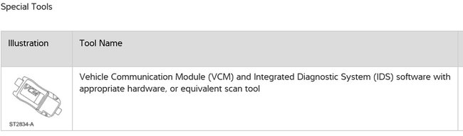

I recently changed my rear brakes and the front ones were almost new so we left them the same. When I went to try them out, I could push the brake all the way to the ground and it just sounds like air. And it will not stop until brake is to the ground. Brake fluid is coming out very slowly like drops. Any help please.

You need to bleed the system use a power bleeder for best results . you may need to take to a mechanic so he can hook his scanner up and open valves on ABS unit to get it right. See picture.
