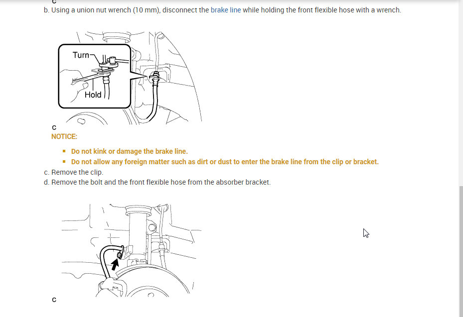

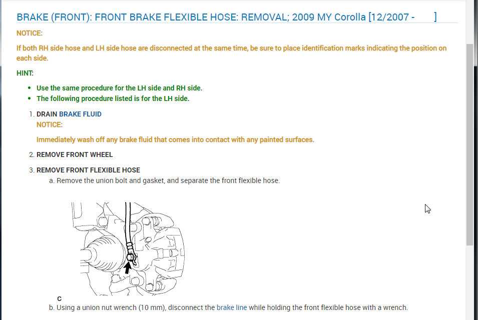

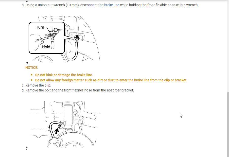

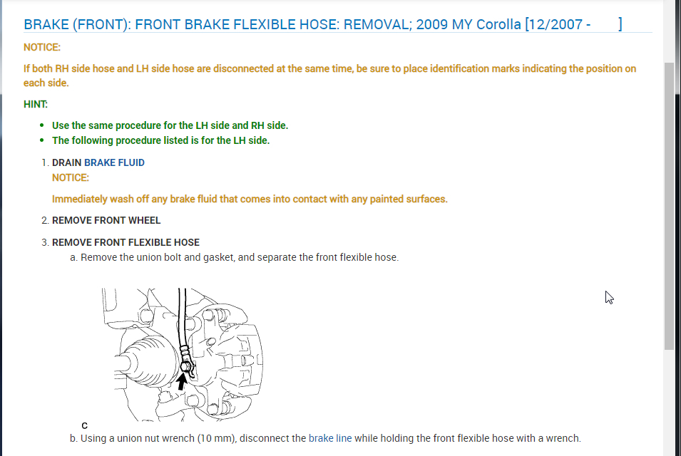

Replaced front disc pads and resurfaced rotors. I noticed the brake hoses needs to be replaced.
Jul 17, 2019 at 8:00 PM
No problem. I attached the info below on how to replace these lines.
You are also going to need to bleed the brakes when you do this so here is a guide that will help with this: Here are videos to help you make your own line or replace the brake flex hose.
https://youtu.be/sO43p4ZFUiM
and
https://youtu.be/1Prs_coIuCg
The process is the same in most cases.
https://www.2carpros.com/articles/how-to-bleed-or-flush-a-car-brake-system
Check out the diagrams (Below). Let us know what happens and please upload pictures or videos of the problem.
