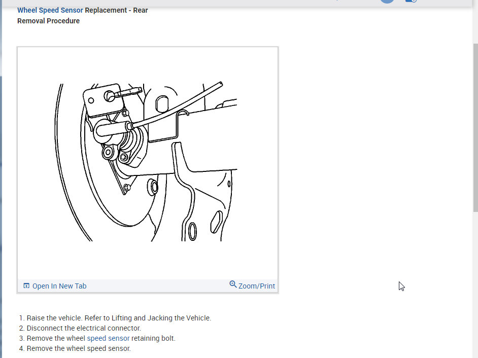

Service stability light comes on and the ABS light comes on.While bleeding the brakes the rear driver side brakes do not work and had no fluid while bleeding. I changed the outer brake hose to caliper and nothing. Trying to avoid going to dealership to fix. Any help is much appreciated. Mahalo
Apr 23, 2016 at 12:04 PM
More then likely this is a speed sensor but we need to start with what codes you have.
Here is a guide that will help pull the codes:
https://youtu.be/Pb6nXV-iamI

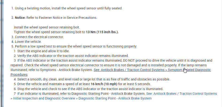

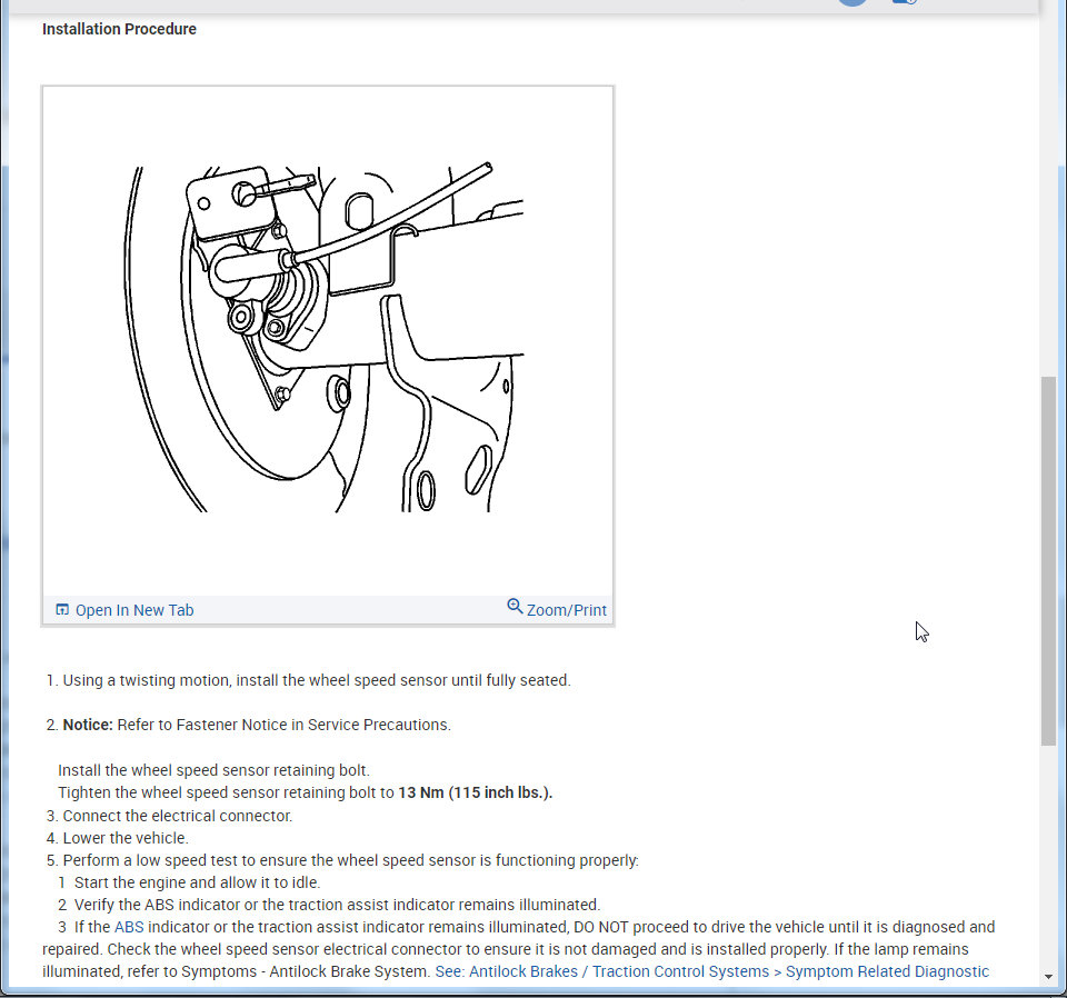

Once we know what the code is we will have a better idea what to do but I suspect have a sensor issue so here are some guides for this as well:
https://www.2carpros.com/articles/abs-wheel-speed-sensor-test
https://www.2carpros.com/articles/how-to-replace-an-abs-wheel-speed-sensor
Below you will find the process from the manual on how to replace this as well.
Please let us know what questions you have. Thanks
