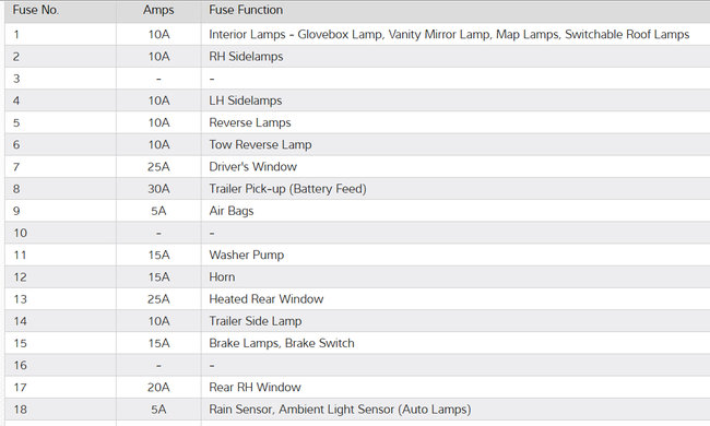

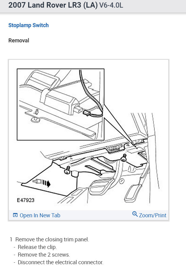

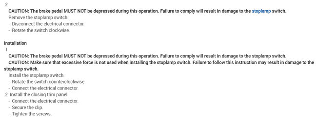

Brake lights were working, replaced switch, now they work fine unless headlights are on, they stay on, tried another switch, no change. I tried a headlight switch, no change. Help! Thanks
Code says it is brake light switch.
Oct 7, 2018 at 5:03 PM
  • 55,691 POSTS

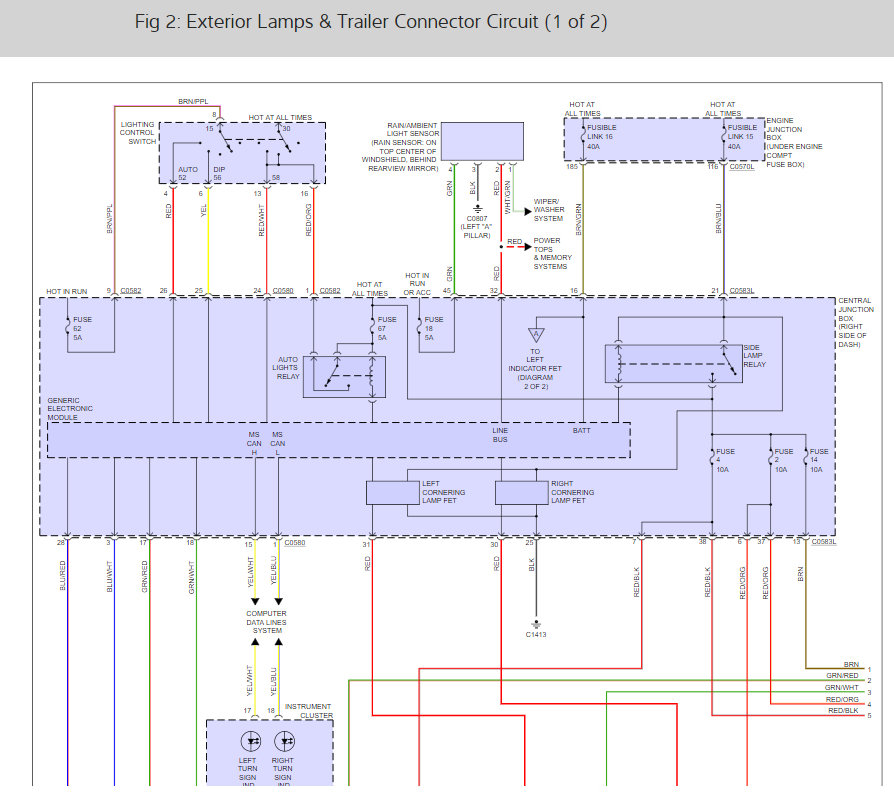

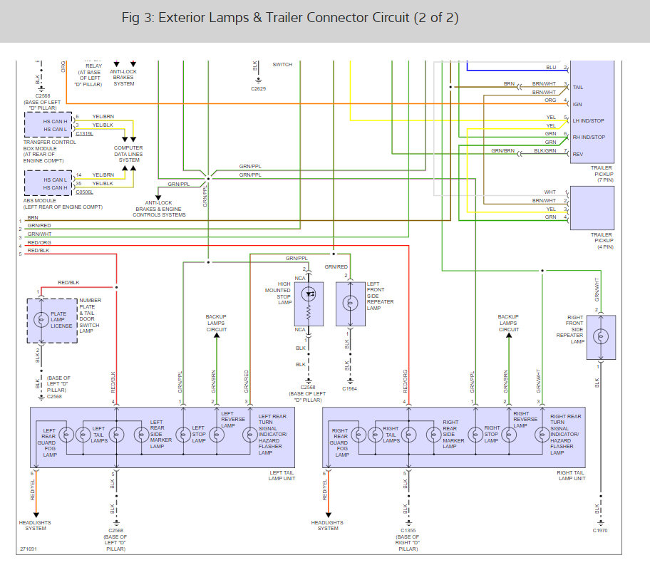

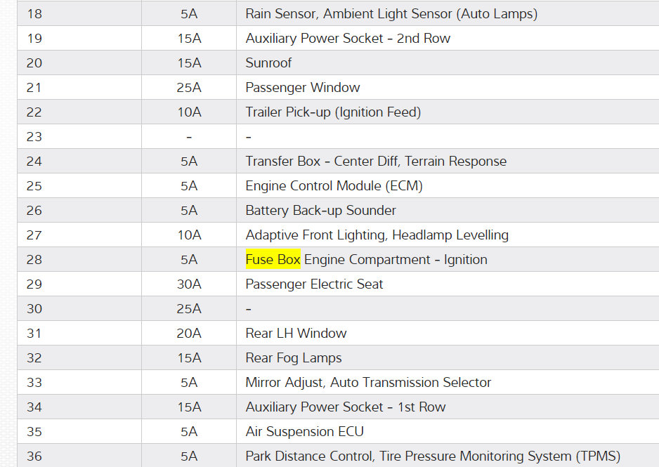

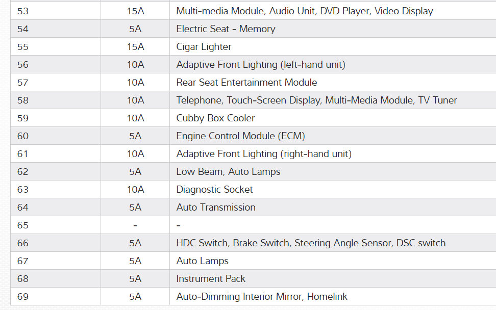

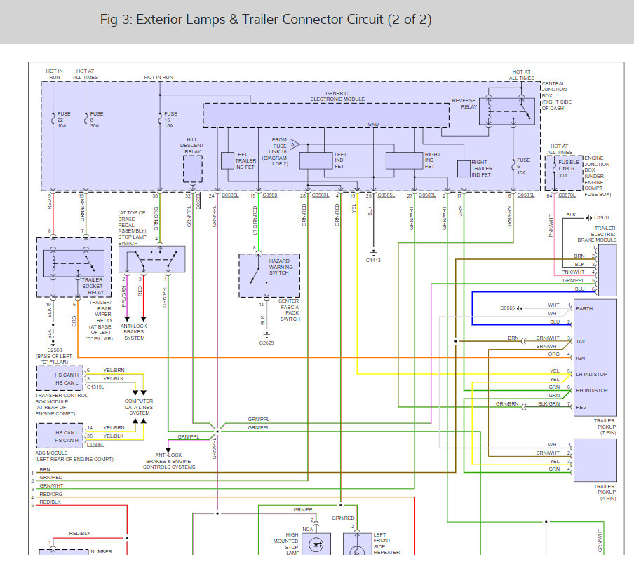

Please check fuse #15 - 15 amp in the fuse panel on the right side of the dash. Here are the brake light wiring diagrams to help you see how the system works. If the fuse is okay I would check the outputs of the GEM.
Here is a guide to help you check the fuse for power and the fuse location as well:
and

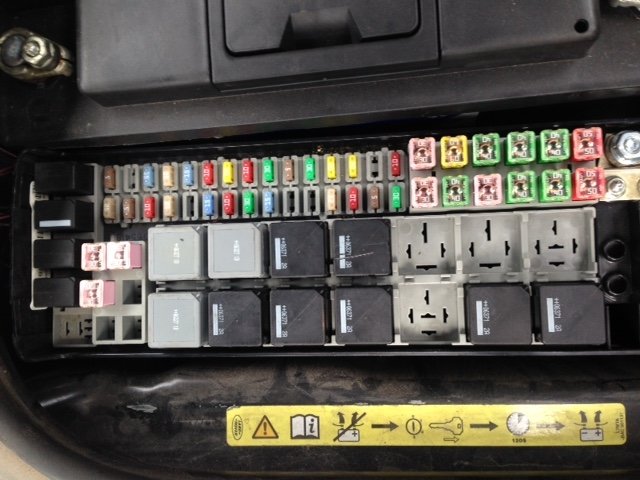

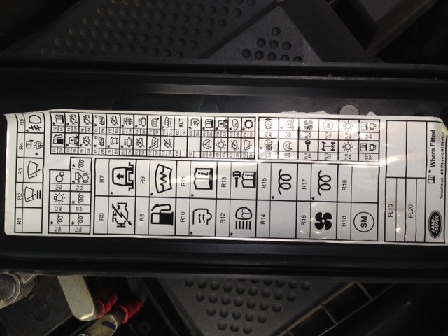

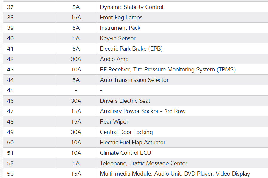

Fuse number 15 is 30 amp, I am including pictures. Thanks
Oct 9, 2018 at 8:54 AM
  • 55,691 POSTS
Sorry, the fuse panel inside the car #15, see if it has power with the key on.

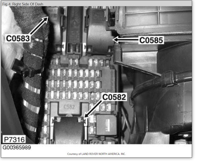

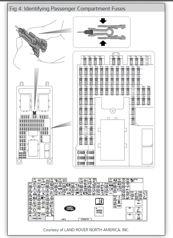

Hi, could you please tell me the location of the interior fuse box? I have looked all over YouTube to find out but no luck, thanks.
Oct 12, 2018 at 12:15 PM
  • 55,691 POSTS
It looks like it is under the dash on the passenger's side here is a diagram below. Please let us know what happens.

Hi sorry to bother, could not find fuse box under dash. Do I have to remove glove box or something? Also, would blown fuse cause this issue? Thanks
Oct 15, 2018 at 5:53 AM
  • 55,691 POSTS
Yes a blown fuse can cause this. You might need to remove the glove box because the blower motor is near the fuse panel. If the fuse is good we need to check the switch next. Please let me know.

Okay, found fuse box behind glove box, #15 is good, ideas? Thank you!
Oct 20, 2018 at 4:30 AM
DUGGG
  • 7 POSTS
Oh and yes it is hot with key on.

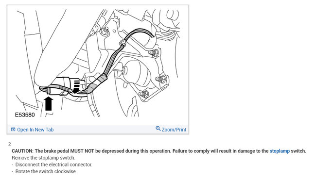

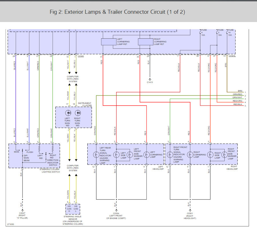

Okay now we need to check for power at the stop light switch green/orange wire.
Check out the diagrams (below). Please let us know what you find.
