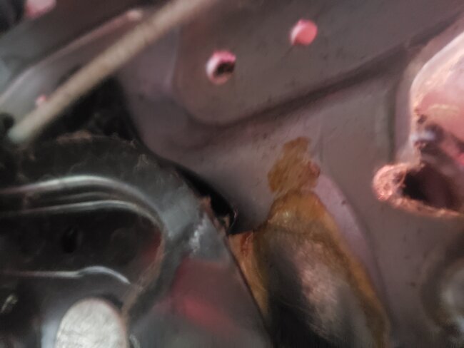

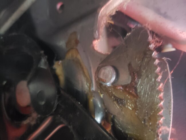

Okay, so, after my car setting not started and not driven for a little over a year now due to a CV axle issue that's now fixed. i had to replace my battery that drained after a few days to a week of not messing with it. i now have on my dash a symbol for the battery, the brakes, and a triangle with a ! inside it all come on at start and stay on. so, i did some online searching and found that the brake light could be due to something in the ABS because i checked the fuses bulbs and hazard lights all work and i f. i'm adding a couple pics of what i found when inspecting the e-brake and brake area inside the car. as from the master light i read it can be due to low and stale old gas or low transmission fluid from changing the axle. also, changing the fluid for a starting spot as for the battery light it said to check the voltage it was almost dead so i had it charged and the started it and disconnected the negative cable and it shut off automatically so I'm guessing the alternator what are your thoughts and suggestions on it please remember the pics are of the inside on the floor ebrake.

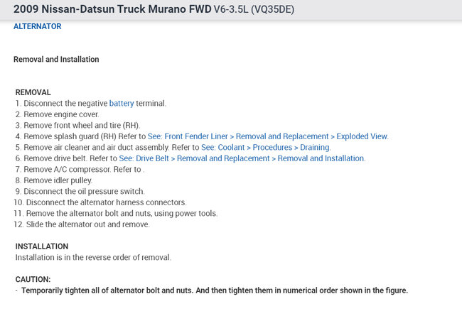

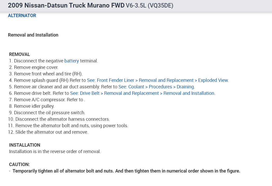

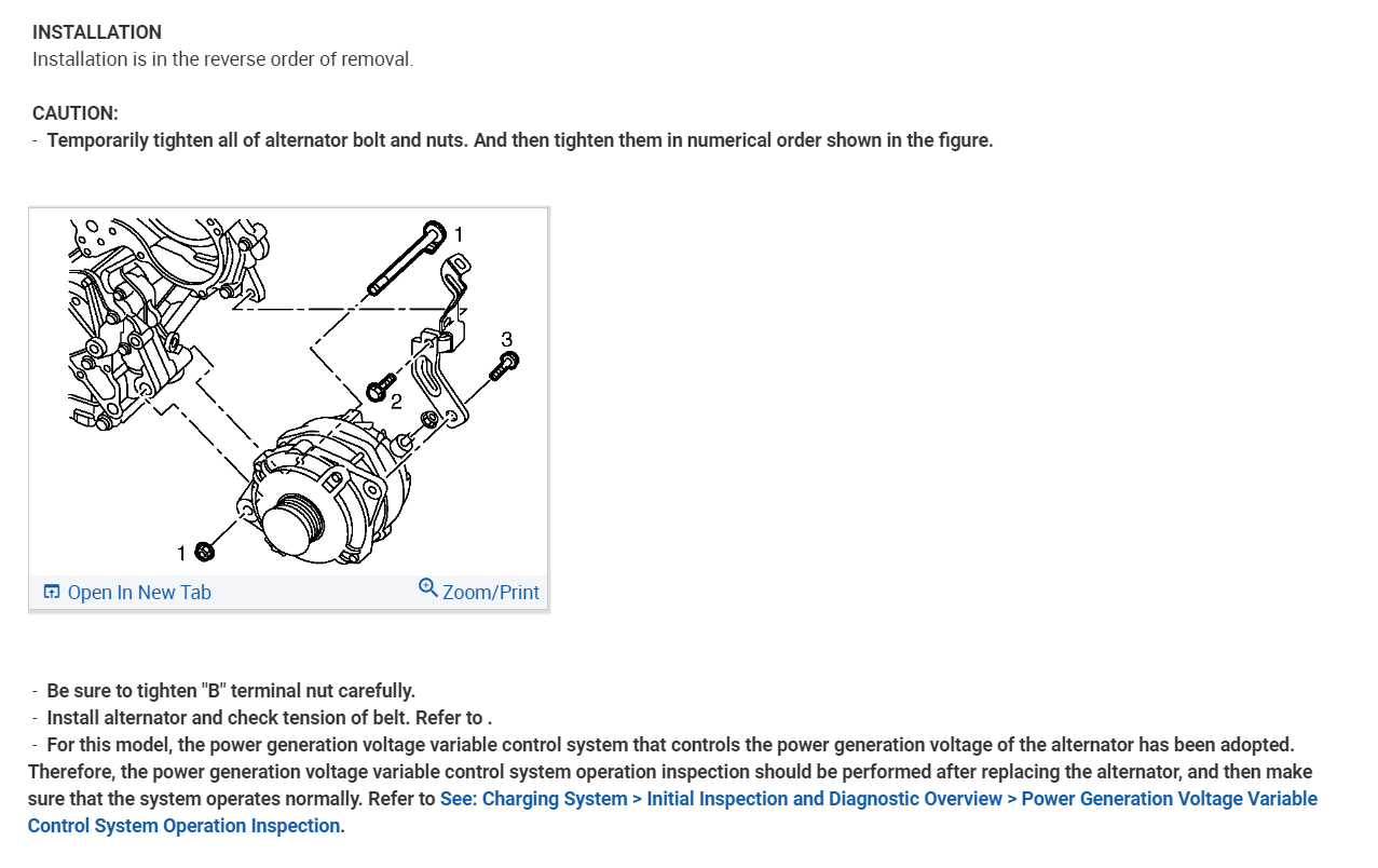

Yes, all of these lights can come on if the alternator is not outputting charge voltage. To be sure let's go over these guides to confirm the non-charge issue:
Here is how to change out the alternator in case you need it. Check out the images (below). Please let us know what happens.

I'm not so worried about the loosing charge on my battery over some time of not even unlocking it because i figured the alternator is going bad since the battery is new and after fully charging it, it stays charged about a week of me not even unlocking it with the fob as for the brake and master warning lights are you saying that the alternator being bad can cause them to aluminate verses it being say the brake light being due to all the gunk built up on the e brake assembly. considering the recall on something to do with the brakes or the master being due to the gas being low and old like been sitting at least a year of barely being started and not driven any and or being low on tranny fluid from me changing it when i did the axle. I'm just curious on these if you need video.

okay, so mi struggling with getting the front nut off the alternator and can't see any other bolts or wiring harness to it.

i ended up going and pulling 1 at a salvage and had it tested its good but i can't get the nut off the front bolt behind the tire its rounded off and stuck I've tried a bolt extractor socket set a gator grip hammering a smaller socket on it using wrenches pb blaster and nothing is budging it any thoughts and heats out cause i don't have any access to some.

i got it off and the replacement on all dash lights are gone and my check engine isn't on, but it still is throwing 2 codes, is this normal?
