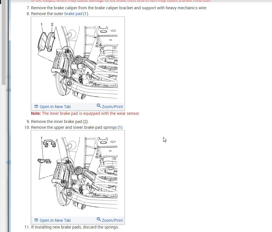

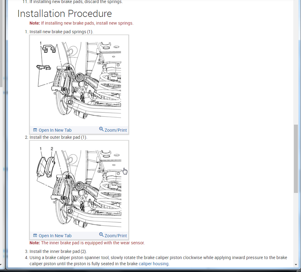

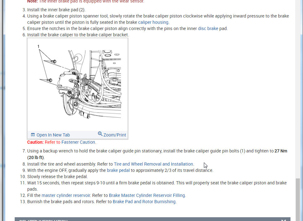

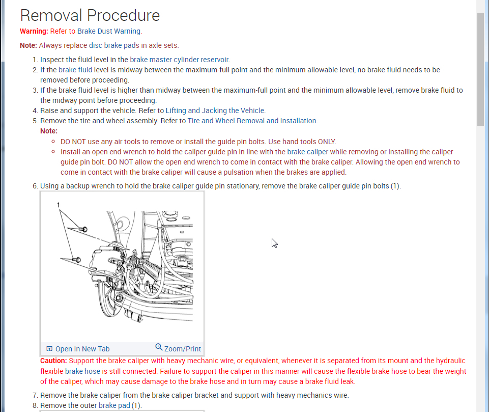

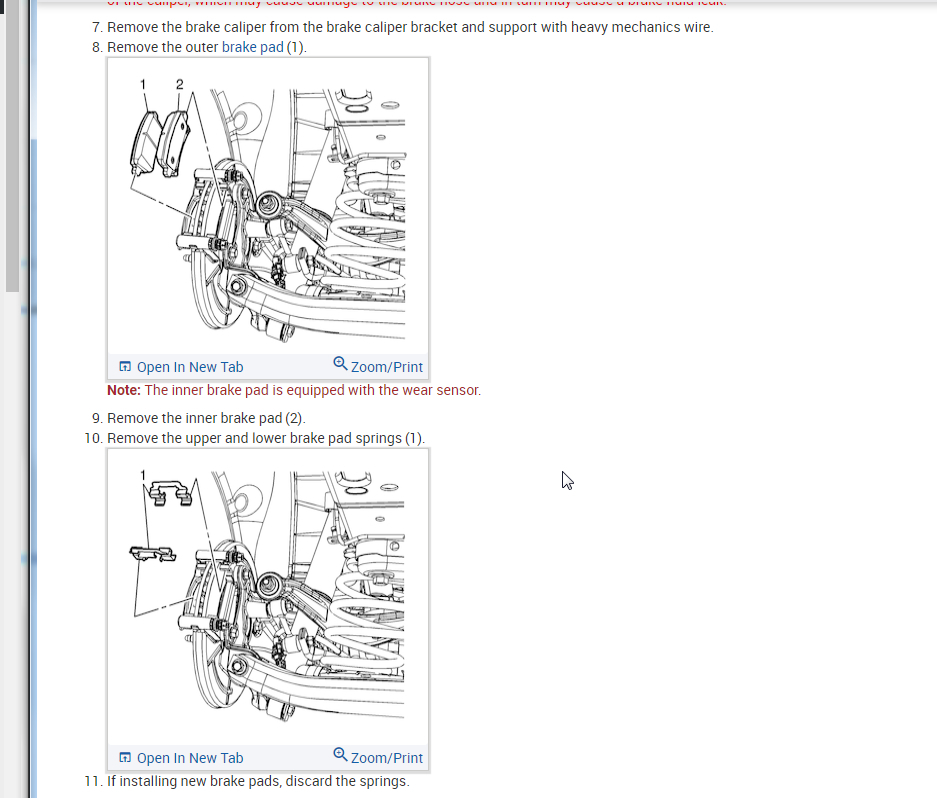

Stability track and service brake assist light came on yesterday. Stopped car, turned back on. Light was out. Then I heard the brake grinding in the rear.
May 31, 2017 at 12:16 PM
Here is a guide that will help with this. Please run through this and let me know if you have other questions.
https://www.2carpros.com/articles/how-to-replace-rear-brake-pads-and-rotors
Plus here is a guide that will help with retracting the rear calipers:
https://www.youtube.com/watch?v=j8YwfSKEzZo&t=29s
Below is the process from the manual on how to replace these. Please let us know if you have other questions. Thanks
