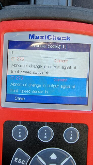

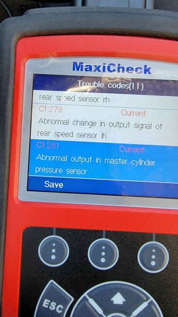

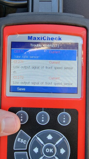

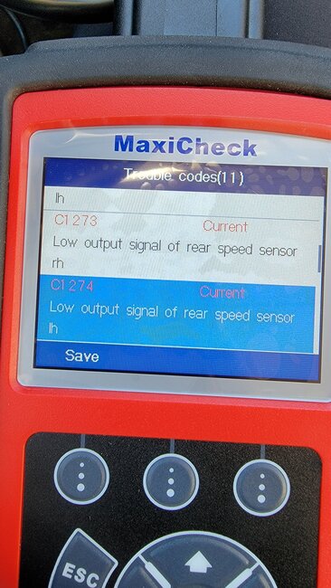

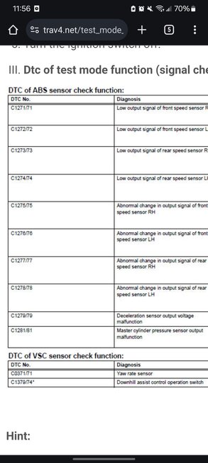

When I apply the brakes, the brake warning light turns on and goes away sometimes. This is the same light as the parking brakes. This will happen when I'm driving or when I'm not moving. If it happens when I'm driving the brakes pulsate and sometimes the warning brake lights will stay on and when I step on the brakes the brake warning lights will go away. This problem started after I changed the master cylinder, brake booster, and brake calipers. If I remove fuse to the abs module the problem goes away. There is no abs or vsc light on. Its strange that there are no code, but when i run a signal check im getting 11 Trouble code, all seems to be related to the abs functionality. Zero point calibration executed successfully. I'm not sure what else to try. I uploaded the codes.
C0371
C1271
C1272
C1273
C1274
C1275
C1276
C1278
C1281
C1379

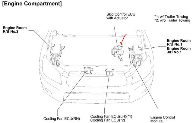

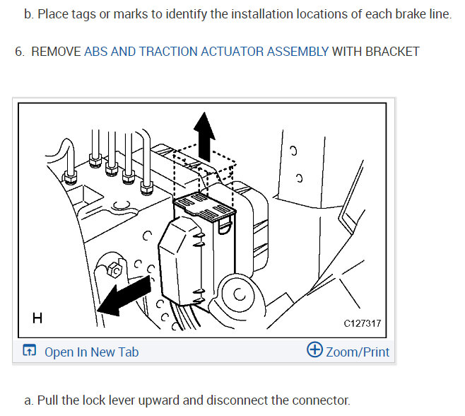

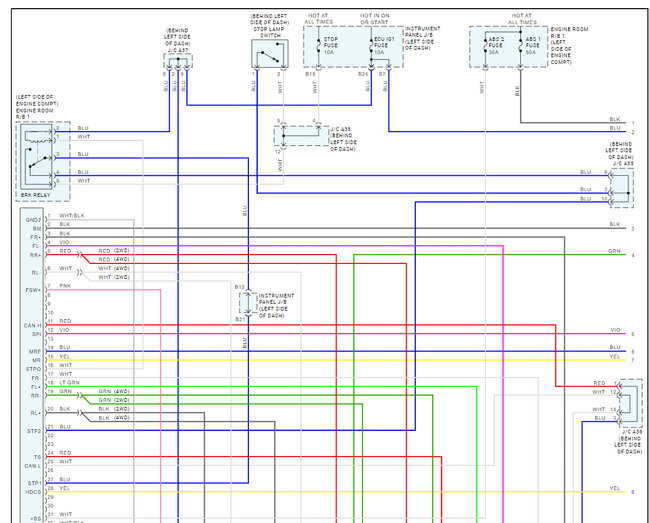

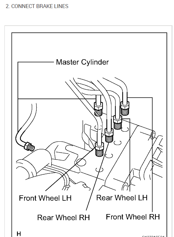

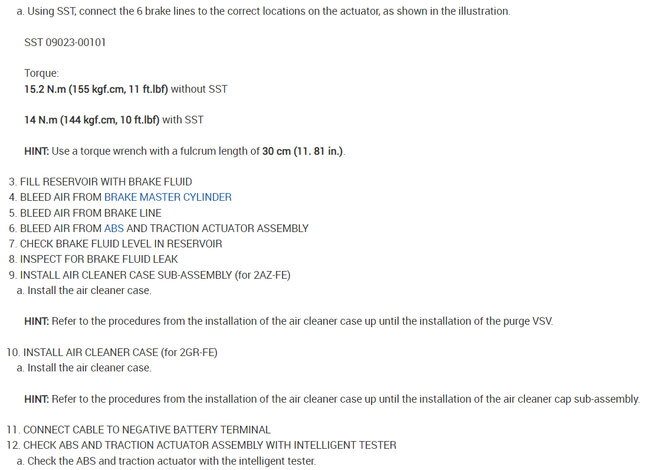

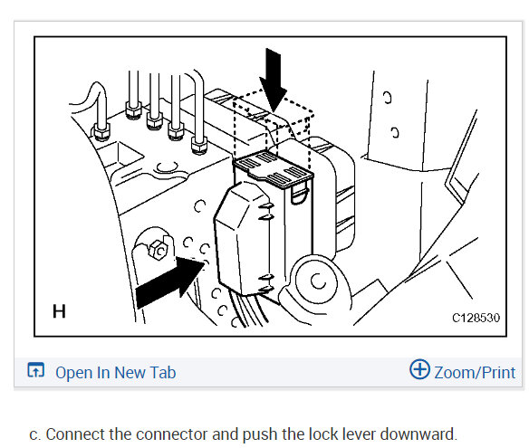

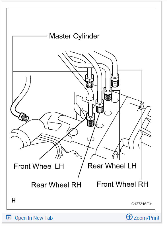

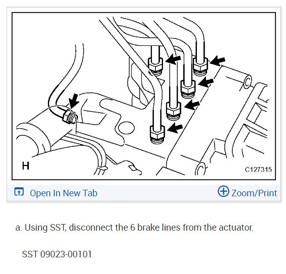

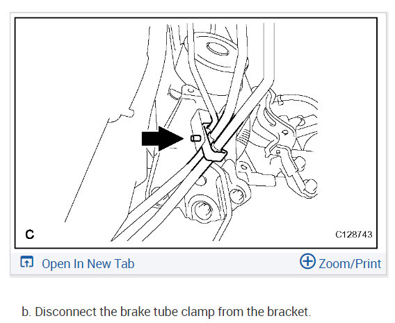

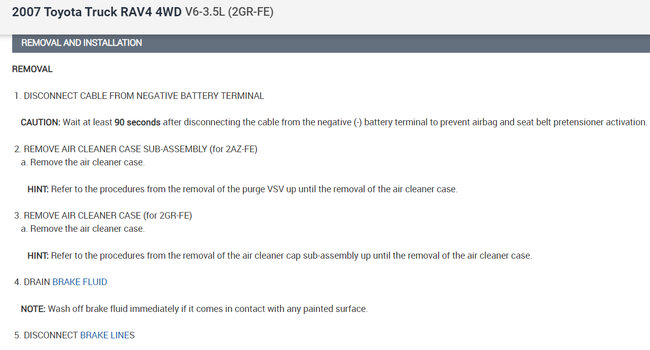

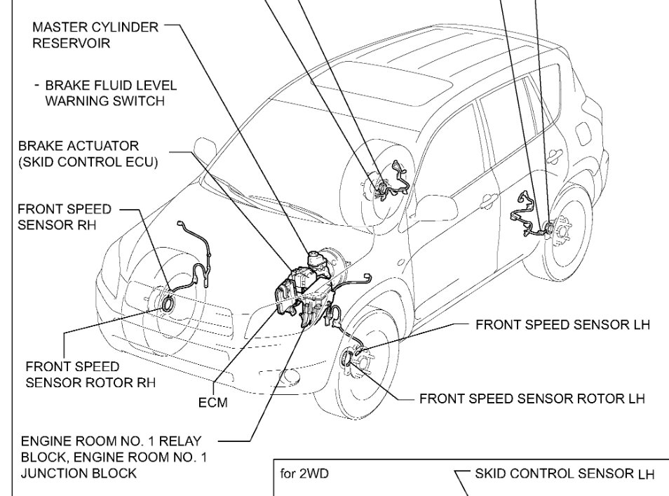

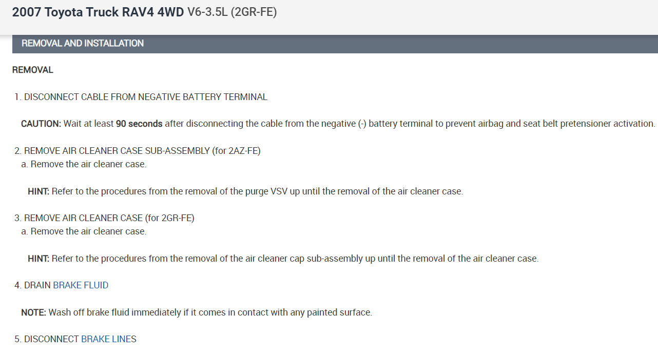

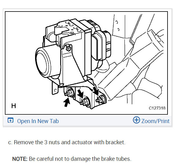

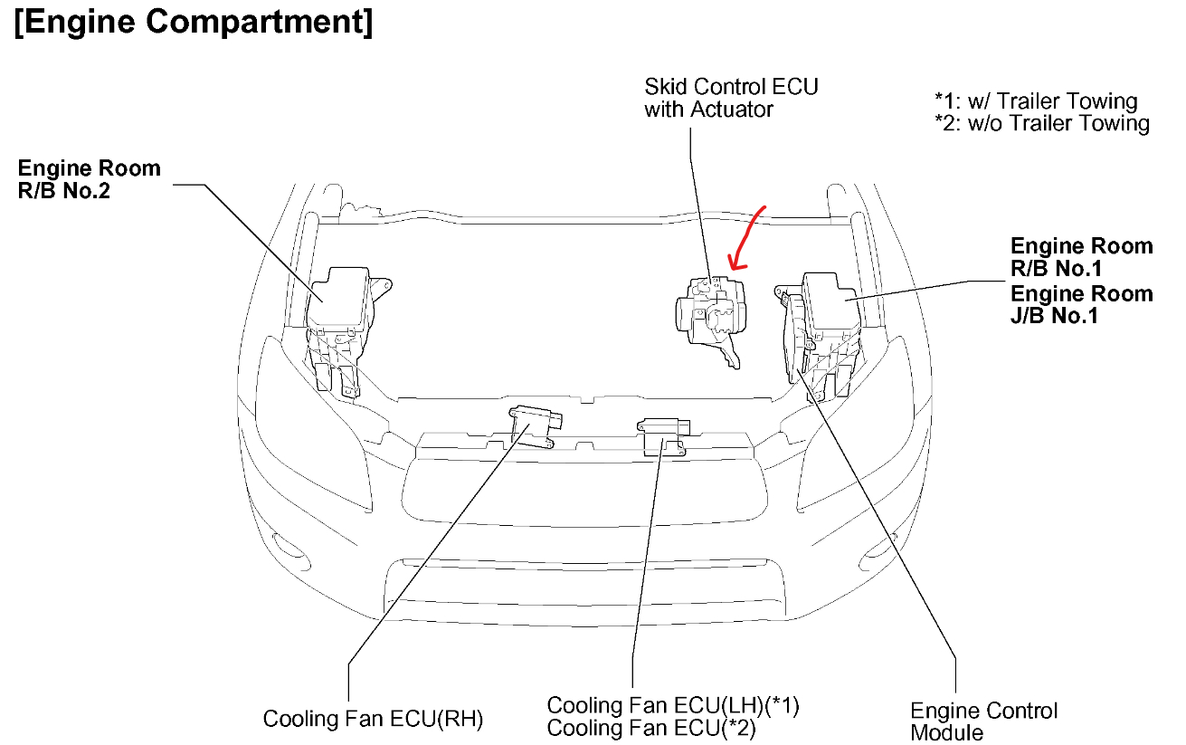

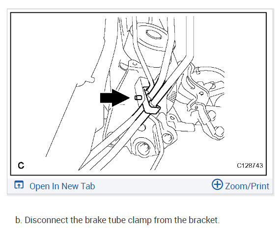

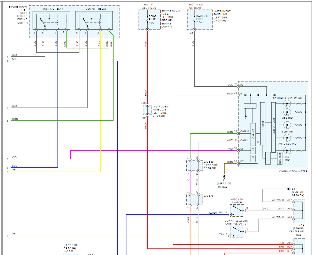

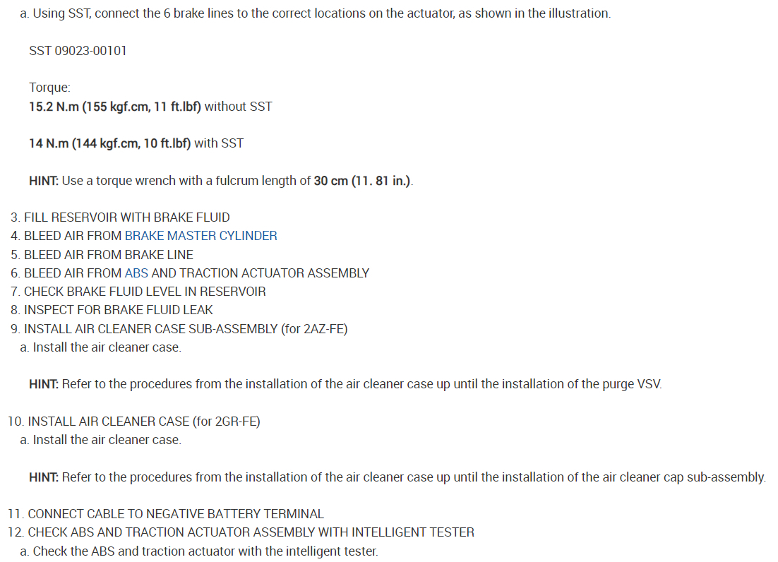

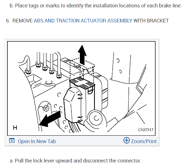

So, you didn't mess with any of the wheel speeds sensors, front or rear? These are codes for both front and rear and if no work was performed on the rear of the car, I would say the ABS module has gone out. When you did the booster and master you could have disconnected one of the wiring connectors or damaged the wiring or connector. Here is the location of the module so you can check it out. It could be that disturbing the brake system caused the ABS module to go out as well. Check out the images (below). Please upload pictures or videos in your response to the problem so we can see what's going on.

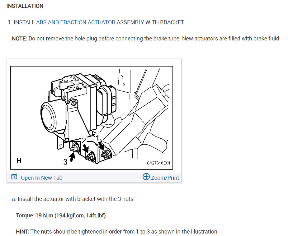

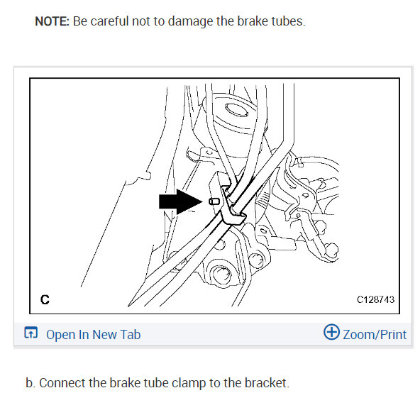

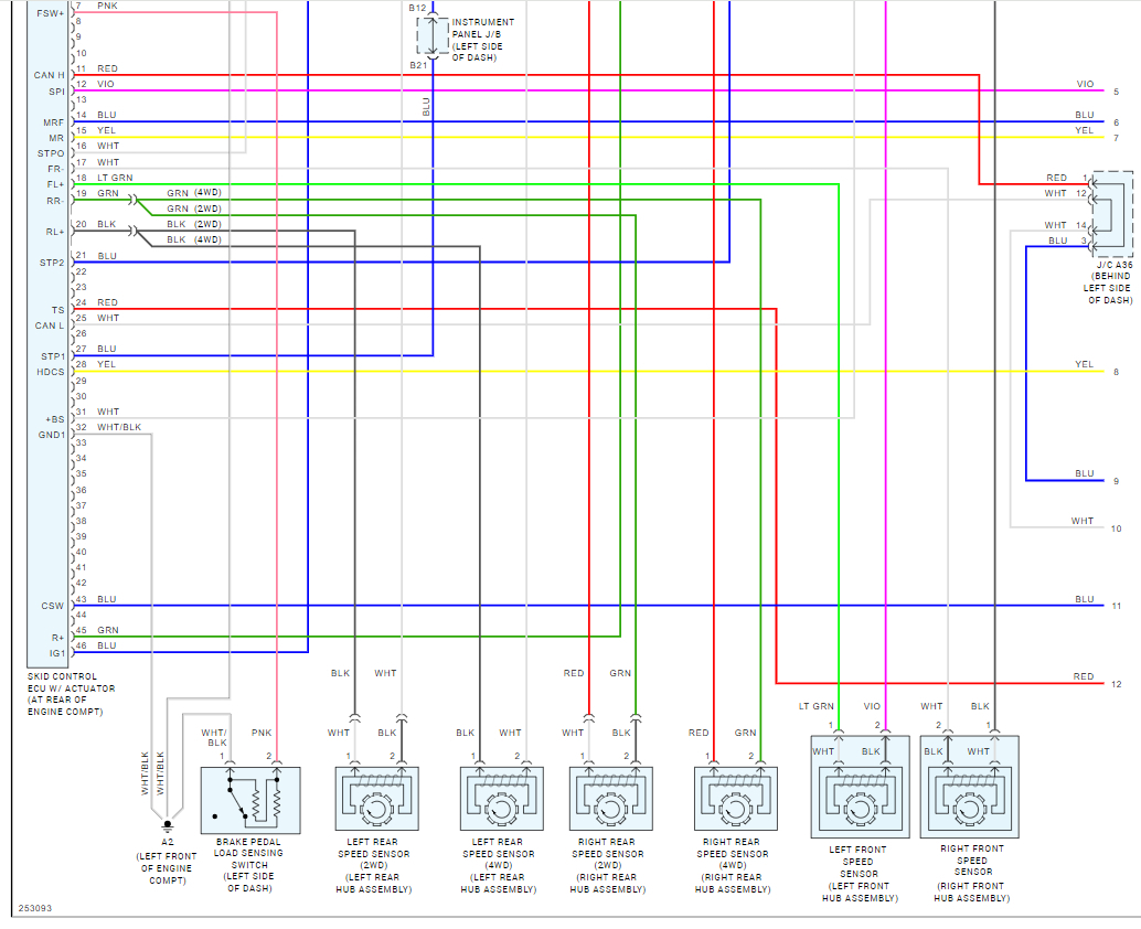

Thanks for all the diagrams. I didn't have to remove the speed sensors when I was working on the brakes, but I did have to disconnect and remove the abs module to get the booster out. I actually bought another ABS module and installed it to test if the module was bad, but when I installed it, my scanner tool couldn't communicate with it to do any calibration, so I put back the original.
Feb 19, 2024 at 6:51 AM
  • 55,676 POSTS

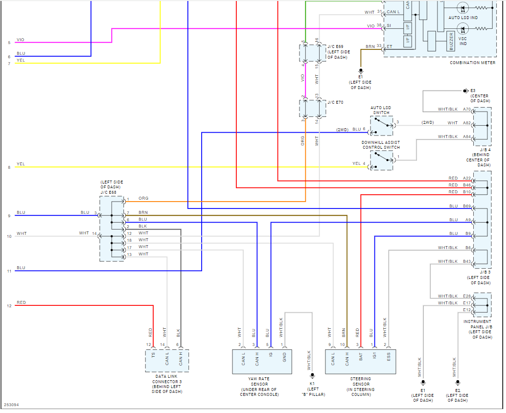

hmm, it sounds like the electrical connector got damaged or some of the pins got pulled out. Can you upload an image of the connector on the terminal side? If okay, it sounds like you will need an ABS module. But let's check the grounds to the system. Here is a guide to help and the ABS module wiring diagrams to you can see which wires to test:
