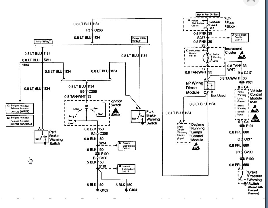

brake warning light stays lit as soon as you turn key on
1996 CHEVROLET S-10
25,000 MILES • 4.3L • V6 • 2WD • AUTOMATIC
HAI6194
replaced brakes front and back. new wheel cylinders and calipers. even new brake hoses. pressure bled with motive-pressure bleeder. still warning light stays on. should mention totally removed ABS system. connected brake lines directly from master cylinder to combination valve 1/4" line to back and 3/16 line split by 3-way connector. also in case your wondering problem was like that before i discontinued ABS. hope you can give me some insight to what it good be. thank you
Jun 19, 2020 at 2:35 PM

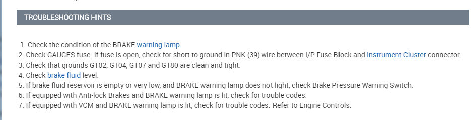

Take a look at the diagram for this light. If you have not done so, you may need to check for codes as the light not only means the fluid is low, it can also indicate an issue with the electrical side.
Let us know what you find and we can go from there. Thanks
